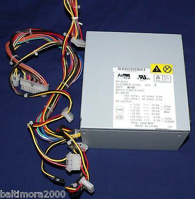

Alright, with everything plugged in, I jumped the green wire to several ground pins on the 22-pin molex connector with the 4-pin connector still in (why didn't anyone tell me you don't have to open the power supply), and got nothing - not even a wink of life.
I also voltage tested several red and orange wires on the same connector (with the black probe on ground), and got unreliable results. Certainly no sustained 3.3v or 5v readings.
So this seems to indicate that it's the power supply instead... What is one to do now when replacement power supplies are well over a hundred, and donor Quicksilvers themselves are a hundred in shipping alone...
OK, this one's $80.

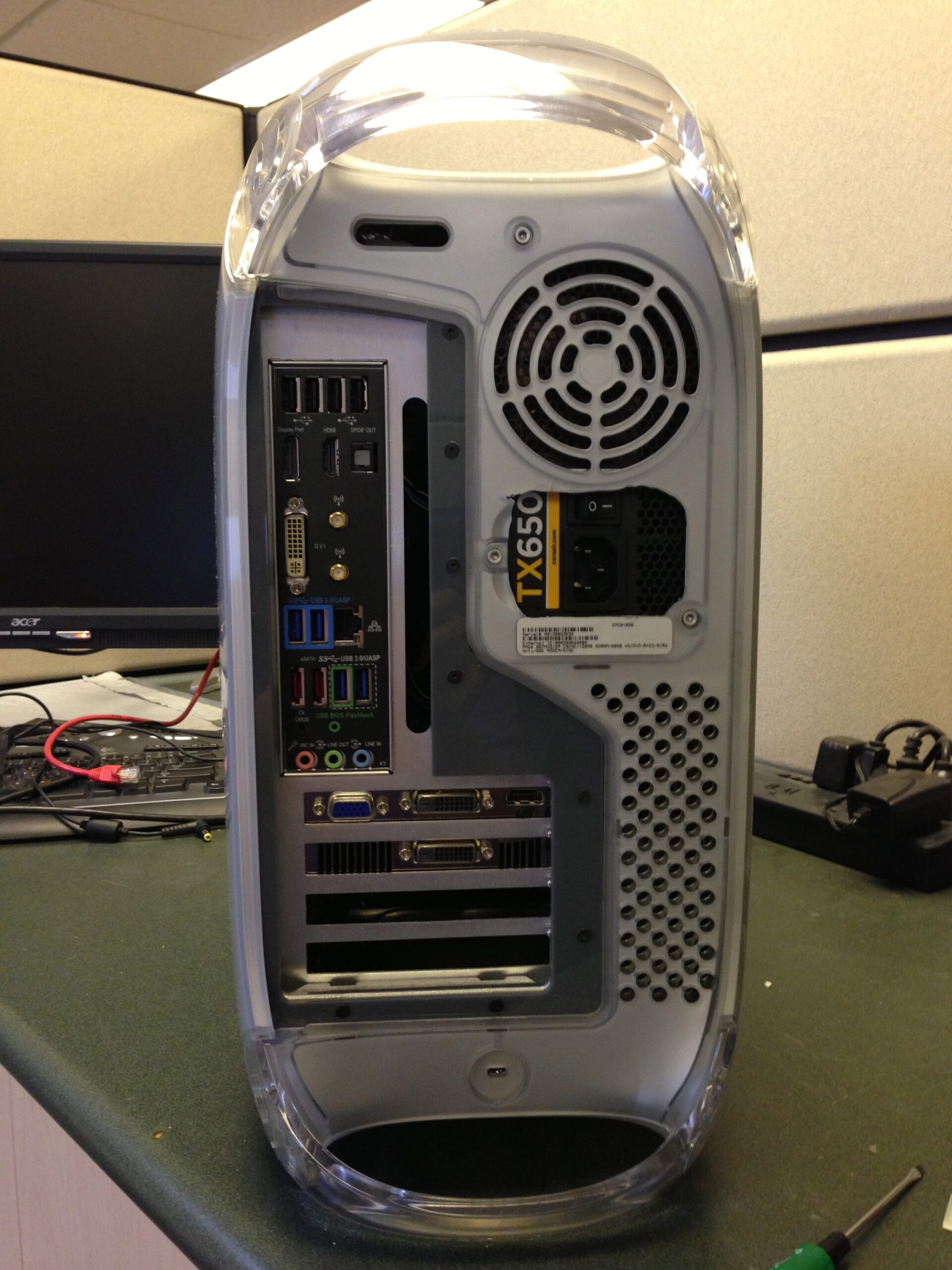

why not just mod an ATX power supply? I find them all the time at the university surplus, Craigslist, etc, for a few bucks.
Reactions: 1042686
According to ATXG4, there are a bunch of compromises in doing this with a Quicksilver, and it's the most difficult to do. Needless to say, I don't think that's an option...

$80+ For a used old as dirt psu or a $5 thrift psu weekend project. Sounds like a no brainer to me-even with the noted drawbacks if you want your box to turn on. I seriously just passed two $5 NIB old 300w ATX psu ‘s at the thrifts over the weekend. Maybe I should go scoop them after work tomorrow. Just nice to have em in my parts bin.

All of that said, I have seen more dead PSUs in QSs and DAs than I care to count. There's a box in my office with 2 or 3 that I've been meaning to hand over to our electronics guy and see if he can coax some life back out of them, but I also don't have high hopes.
