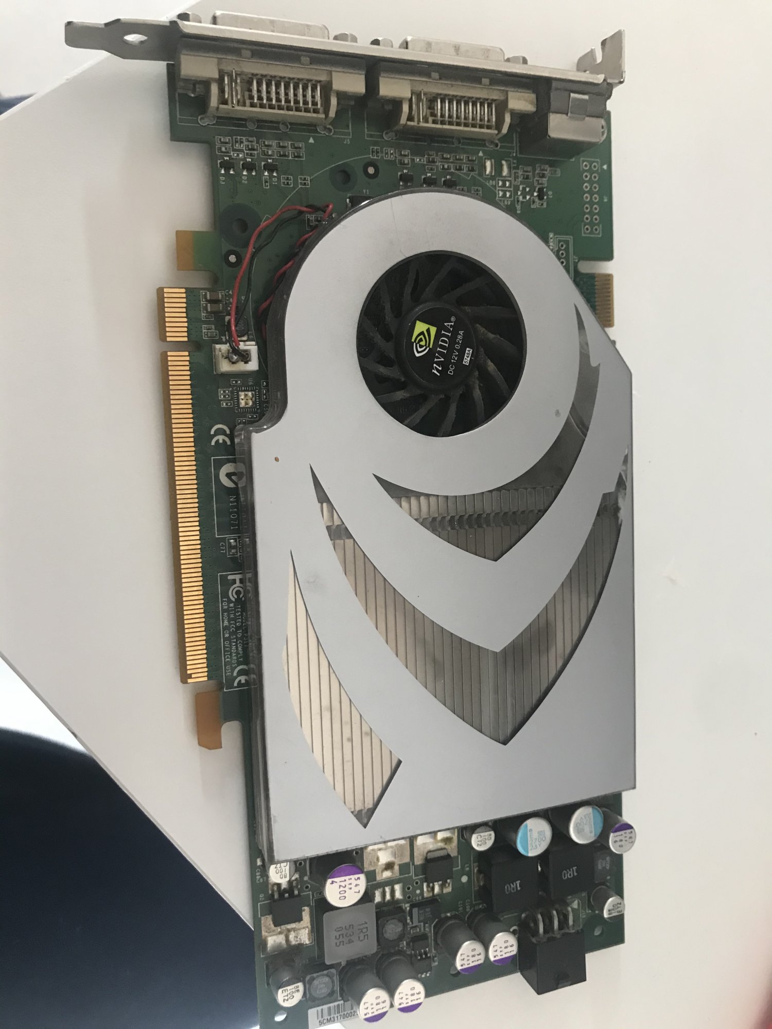

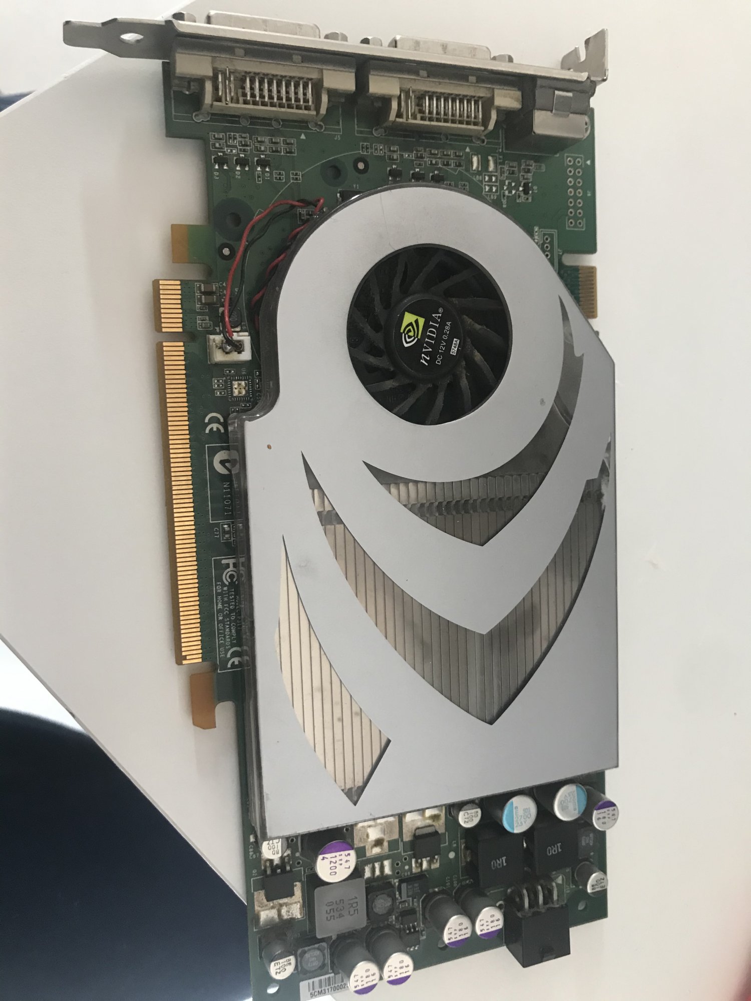

I bought a fx5200 on the internet but it doesn't match the usual one. why?

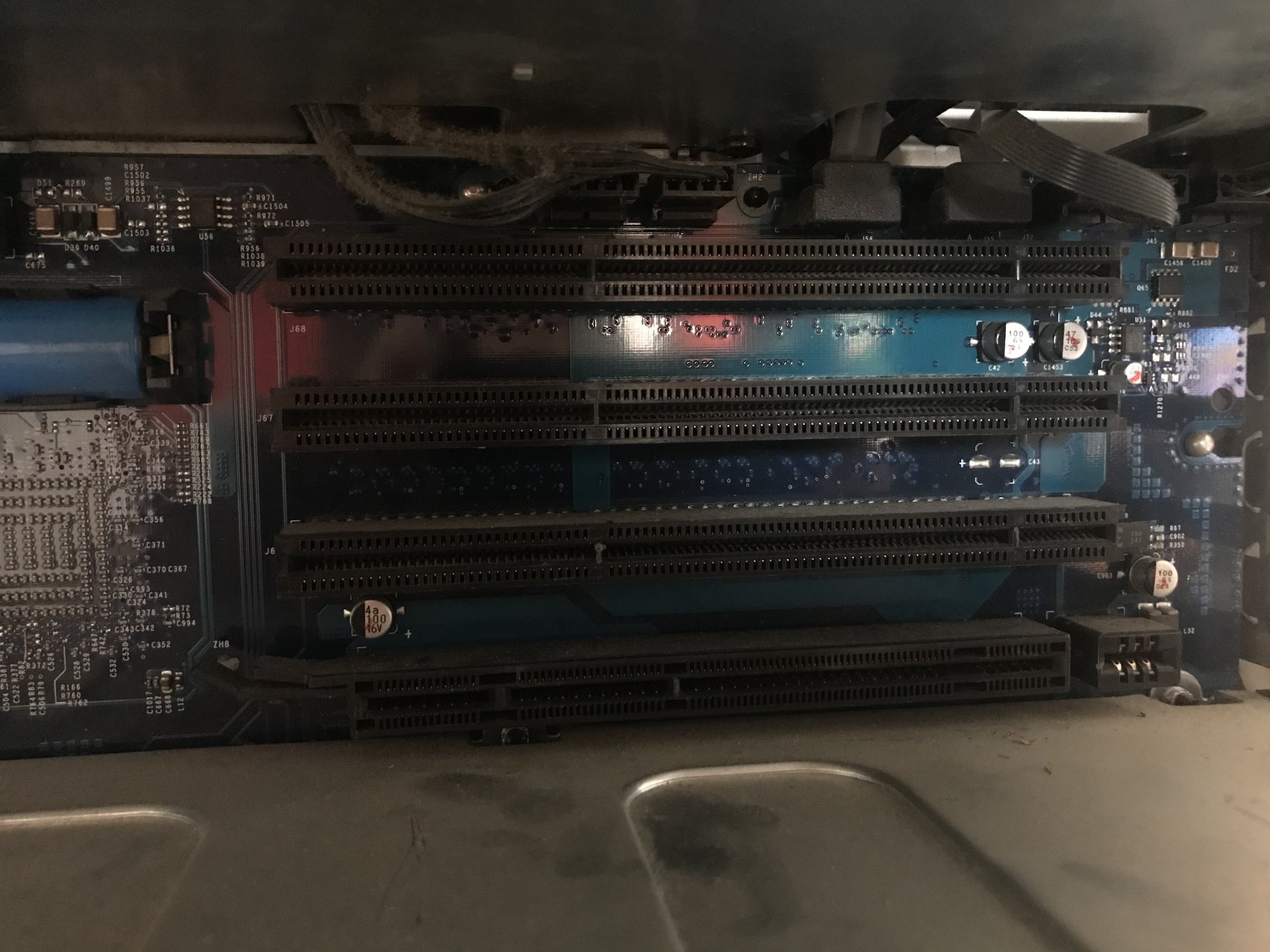

can you help me in finding a video card that can be adapted to my power mac? i am changing slot because i am not sure if it is the broken agp video card. I wanted to test with a pci to see if the motherboard was working. the initial startup boom feels!
The G5 in the picture above is an AGP based G5 for sure. For testing purposes you could use a PCI (not PCIe, just regular PCI). Such as a Radeon 9200 or something. Even a Rage 128 out of an old G3 should work.
As for other AGP cards, a Radeon 9800 Pro. a Geforce 5200 (both of those are AGP Pro, and native to the G5).
