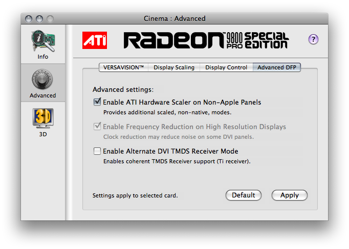

I'm not sure if would help, but try downloading the ATI Displays panel, and under advanced there are a few options to experiment with.
Settings under Advanced DFP might apply?
