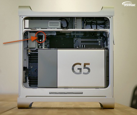

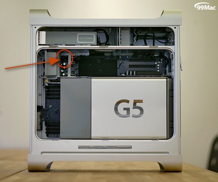

As for the power you'll need this which connects to the top of the motherboard just behind the front speaker.
