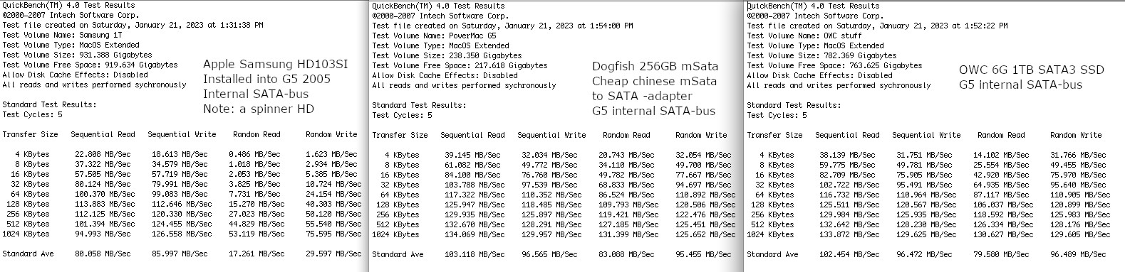

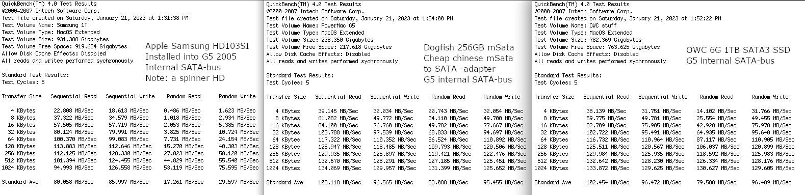

Here are some comparisons I made earlier.

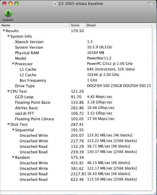

Pic 1: Spinner vs cheap mSata SSD vs expensive 1TB OWC SATA III SSD in the internal bus. Yes, much faster than the spinner but notice how the SSDs are bus restricted and basically equal (and slow vs how we think SSDs should perform).
Pic 2: same mSata SSD in internal SATA -bus, different benchmark. Compare to pic 3.
Pic 3: 1TB OWC SATA III drive in a OWC Accelsior S PCIe -card. Compare to pic 2. Notice the difference between the 2 SSDs? They were equal when connected to the internal bus (pic 1). Still not 100% of what the drive can do (in a modern machine) but totally transforms G5 disk performance for around 40€.

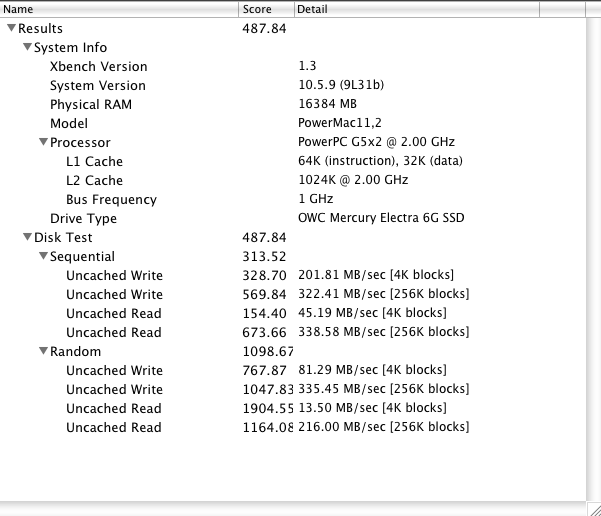

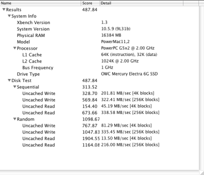

BTW, can you confirm that the combination of an Excelsior S PCIe card plus an OWC Mercury Electra 6G SSD is bootable by a Power Mac G5?
Reactions: MarkC426
No, I cannot confirm that nor have I implied it would. I probably tried it but cannot remember, I doubt it. My suggestion was: boot drive to SATA I bus, other stuff to the SATA III drive on the card.
I can only recommend the card. I have no comments about the OWC Electra 6G. It has worked fine in my use but I remember seeing some complaints about OWC drives on line. And they are expensive (I bought mine as one component in a bigger batch or parts so I paid very little for it). Personally if I was buying a SSD drive now I would opt for some of the real SSD brands.
Ps. OWC doesn't list G5 or 10.4 or 10.5 compatible with Accelsior S but I have run it in G5 with 10.5.8 & 9 with no problems at all. So, recheck that it works with 10.4 if you need it.

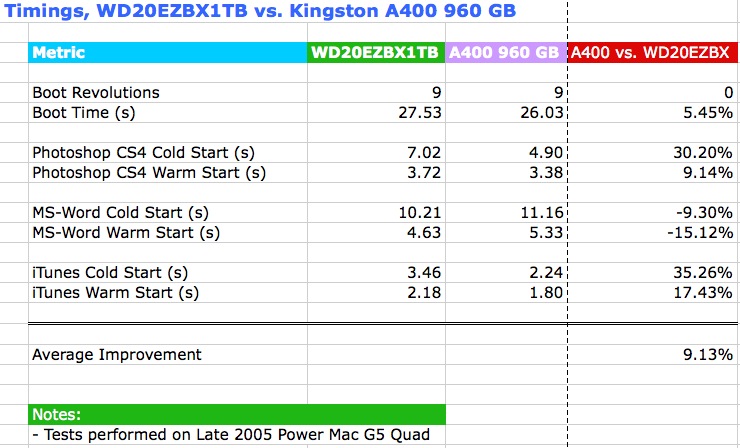

Well, I was sort of right and sort of wrong about the possible performance gains of an SSD vs. the Western Digital Blue WD20EZBX 1 TB spinner in my late 2005 Power Mac G5 Quad.
Boot times are not materially changed, and app loading times are a mixed bag:
MS-Word was actually SLOWER to start up from the SSD than from the spinner! I have no thoughts to explain that except to say that Microsoft has always seemed to "dumb down and slow down" the Mac versions of MS-Office up until recently.
Overall, the best I can say is about a 30% decrease in app load time for some apps, but not all.
Surprising (and disappointing) result, but the SSD will stay in place and will soon host a Tiger install as well.
The SSD that also work and is probably one of the best for a PowerPC is Samsung Evo 840 (or Pro). Why that exact model? Because it has hardware TRIM support and lots of other "fancy" stuff.
Samsung SSD's have cache memory (around 500MB for 500GB i think..1GB for 1TB etc..).
Also, Samsung has a technology (i can't remember what it's called, i can check it up later) where when you write to an SSD, for the first few GBs it behaves like SLC instead of a TLC for evo or DLC for Pro models.
Here is a link for SLC, DLC and TLC info:
Kingston A400 doesn't have cache nor that samsung fancy technology..so you get an idea why it behaves similarly to an WD HDD (the HDD has 256MB cache compared to none on the SSD)..
Hope i helped you somehow 😅
