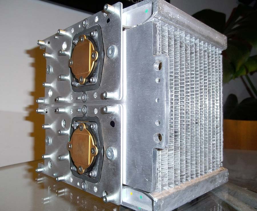

Other than for the Dual 2.5/2.7 leaking of the liquid cooling system wasn't that much of a problem for the Quads as their LCS was of much better build quality. But after all those years it almost certainly has to be opened, cleaned, flushed and refilled to get proper temperatures and fanspeeds (noise level). An this might not be an easy task. All of the tube connections are not only clamped but also glued together. And the phillips-screws at the cooling blocks...
..., which have to be opened to get things cleaned properly, are also glued/secured with Loctite which makes it very difficult to get them out without major damage.
Also forget about replacing the PSU with some common part! This thing is 1 KW an laying flat on the bottom of the case. There is no room in there for some ATX-formfactor stuff. Also the Quad's PSU has some very proprietary connectors.
