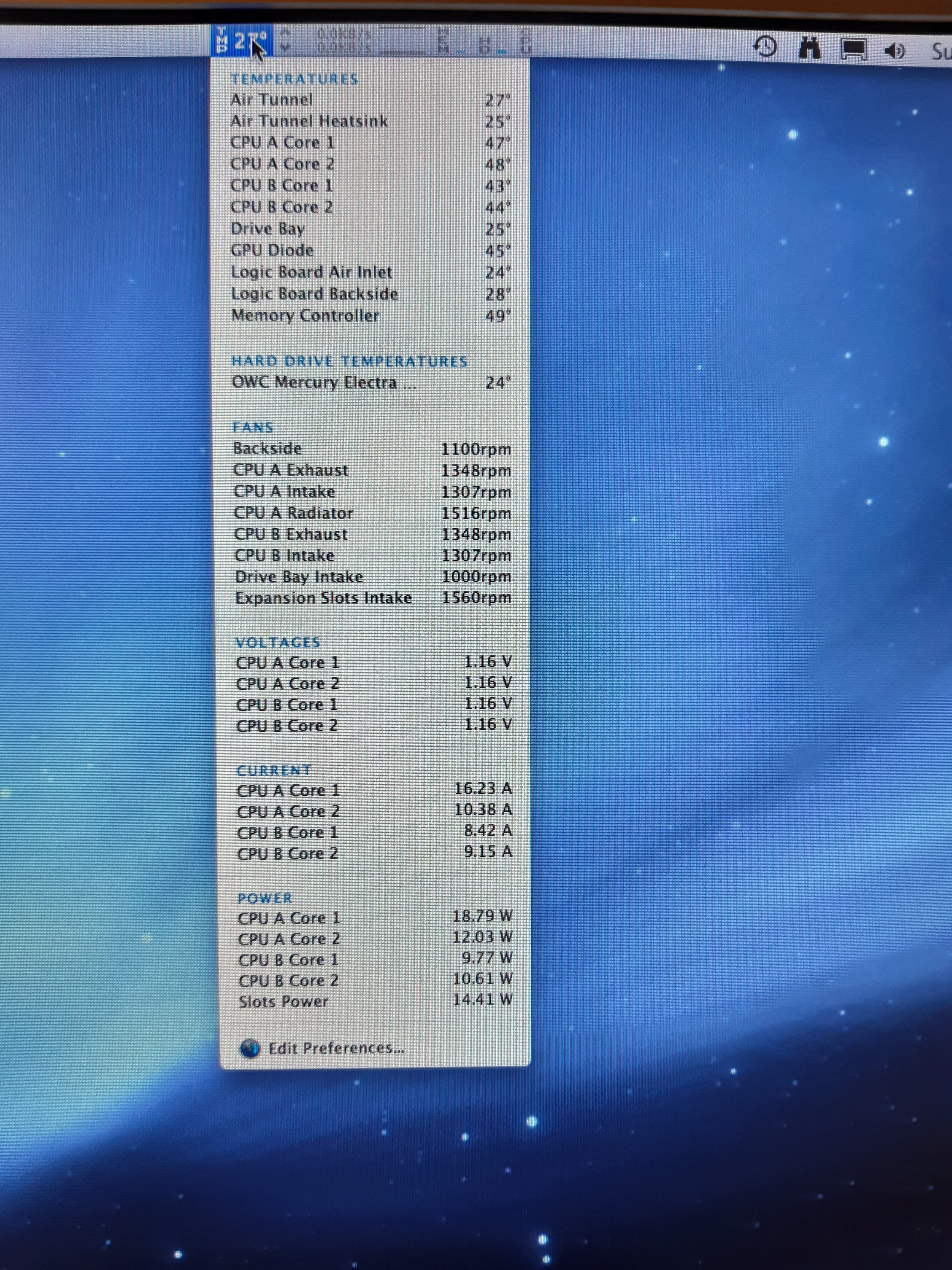

Update:
I finished the BIG G5 cleaning project.
I felt so relieved when I heard the chime after putting everything together again.
Despite the chime I got 3 red Leds turned on briefly after.
I thought that's ok as I didn't had the graphics card in yet and the plastic panel still off but then I saw that I forgot to connect the pump...luckily that didn't damage anything.
So I switched it off and throw in the graphics card.
The next try got a black screen and again some Led's. I began to fear again that maybe the processors aren't seated properly or something worse but why a chime then ?
Stay calm!
I decided to do a SMU reset and that did the trick.
I did that whole procedure to my quad because I recently saw what corrosion did to my 2.7Ghz dual so I had to take a look what's happening inside my quad.
Fortunately there doesn't seem to be any leaks but I could hear the liquid moving while I was turning around the LCS assembly. Air bubbles ?
Despite that I decided not to mess any further with the LCS because it didn't have any temperature problems during operation.
My goal was to take a look at the backside of the motherboard because it always had way too high memory controller temperatures. Easily 80°C while idle.
So everything had to come out. A painful job.
I came across a broken standoff while taking out the power supply but could glue it back again with epoxy. Someone had been here before...
I expected that maybe the plastic pins of the memory controller had broken like I read but that seems to be the case with earlier models. Mine's were perfectly fine and I finally managed to get them out with help from a wood stick applying pressure from the downside while pulling from the upper side. I renewed the thermal paste with Artic Silver 5 because I had that around.
So after putting back my boot drive I was looking forward to see the temperatures.
What can I say...
Instead of the usual 76-80°C of the memory controller I saw 50°C!
Wow...instead of the 3000rpm of the backside fan I was used to it now was chugging away at 1100rpm.
This screenshot is after only 5 minutes runtime but even after 15 minutes more the temperatures didn't get much higher.
So quite a success after all and worth the hassle.

Great work @philgxxd !
Those are impressive running temps.
