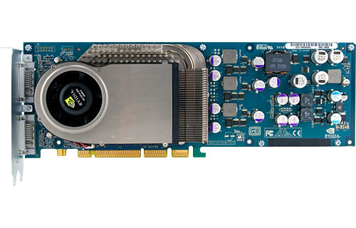

Is replacement 6800 Ultra Mac one? It's easy to differentiate PC from Mac one:
PC:
images
Mac:

That's perfectly normal. AGP Macs do need graphics card to POST. If card is dead (i.e. its device ID cannot be read by computer) = no card = no chime.
That's why it works with your old card (not completely dead). Even unflashed PC card is enough to POST, you won't see video obviously.
On the other hand, PCI and PCIe Macs do not need graphics card to POST.
