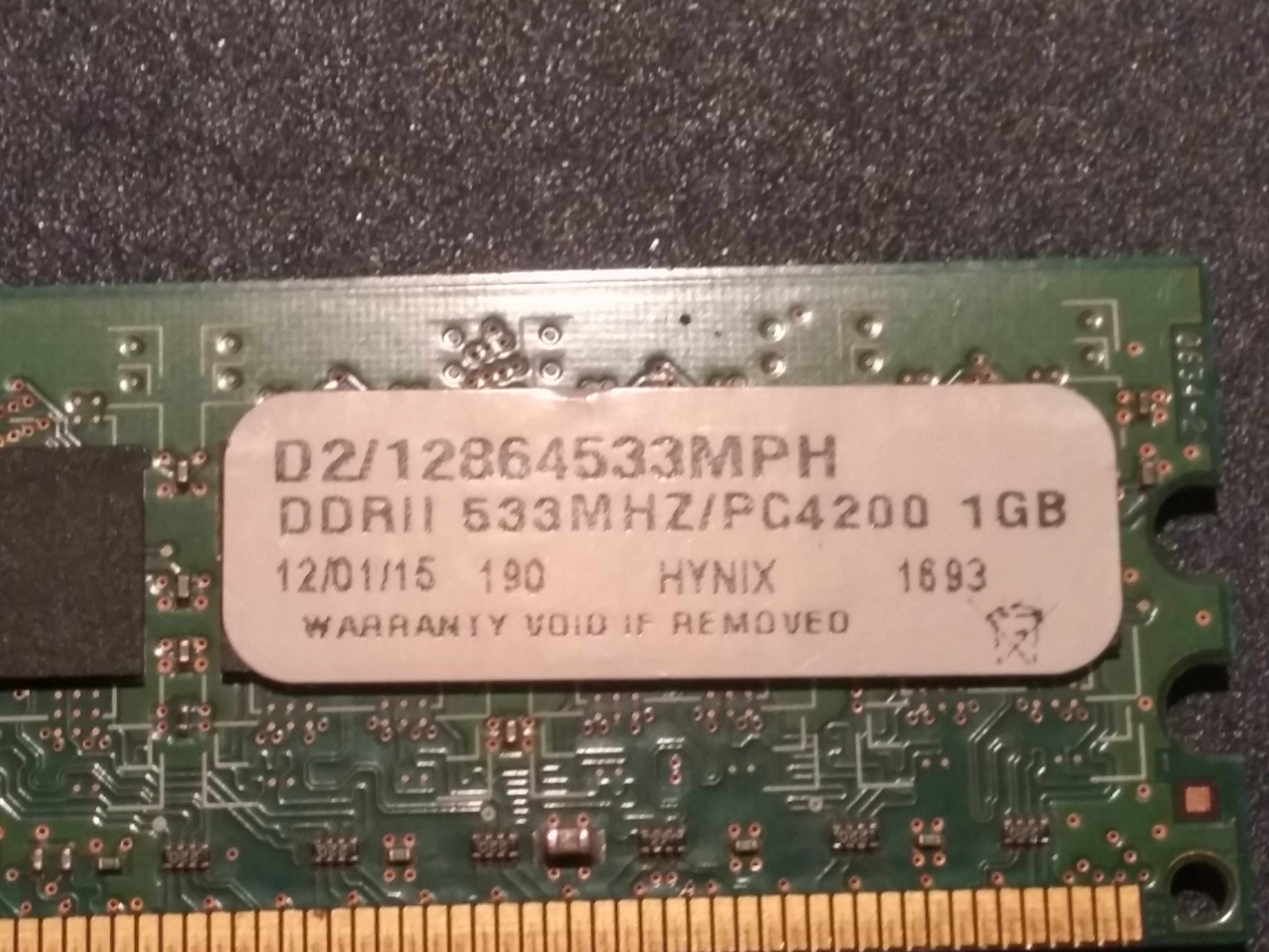

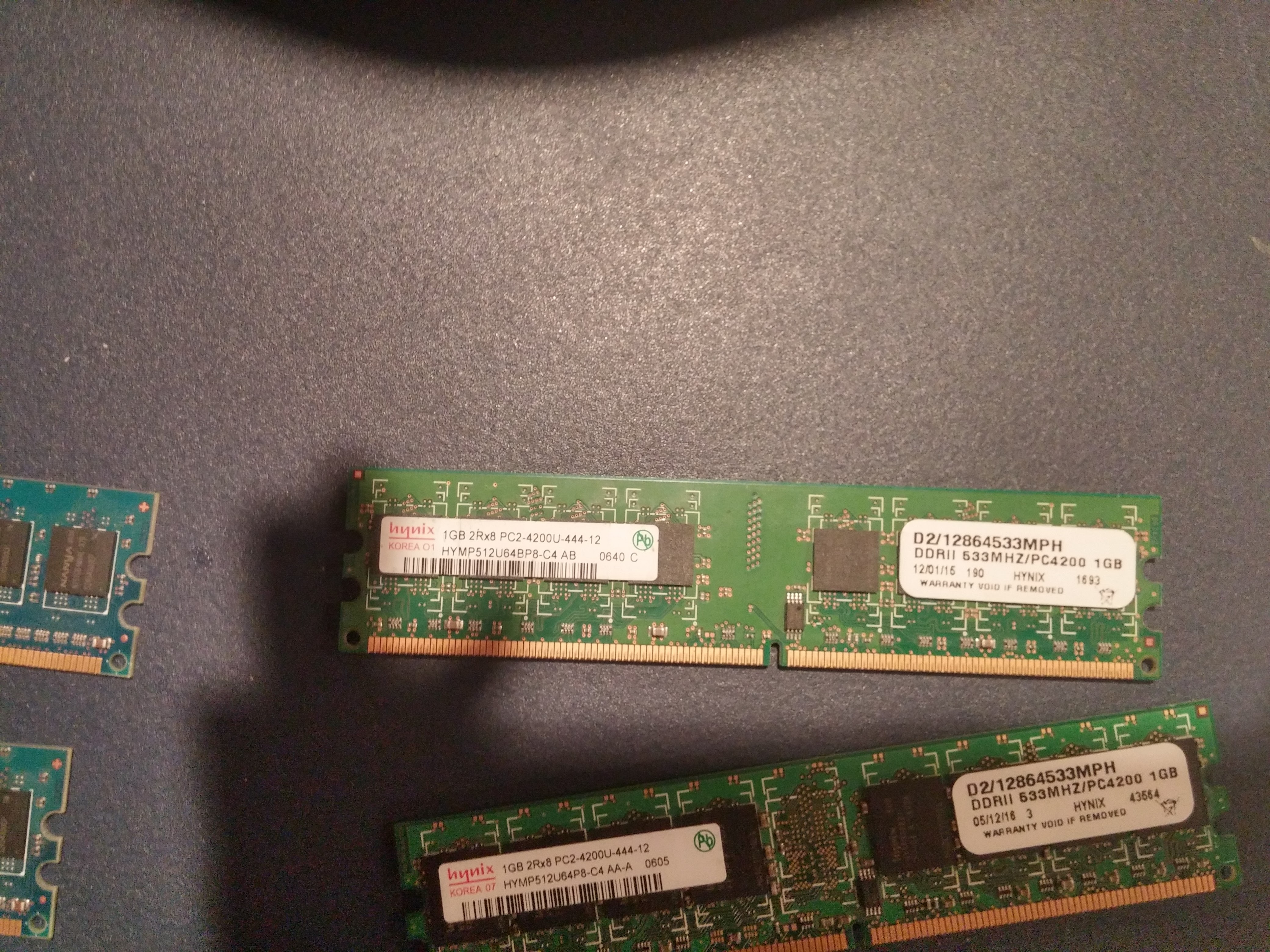

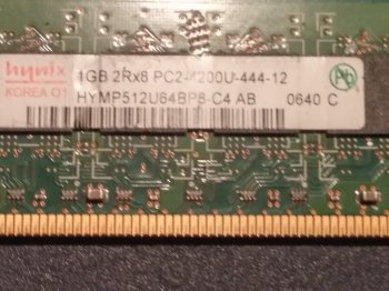

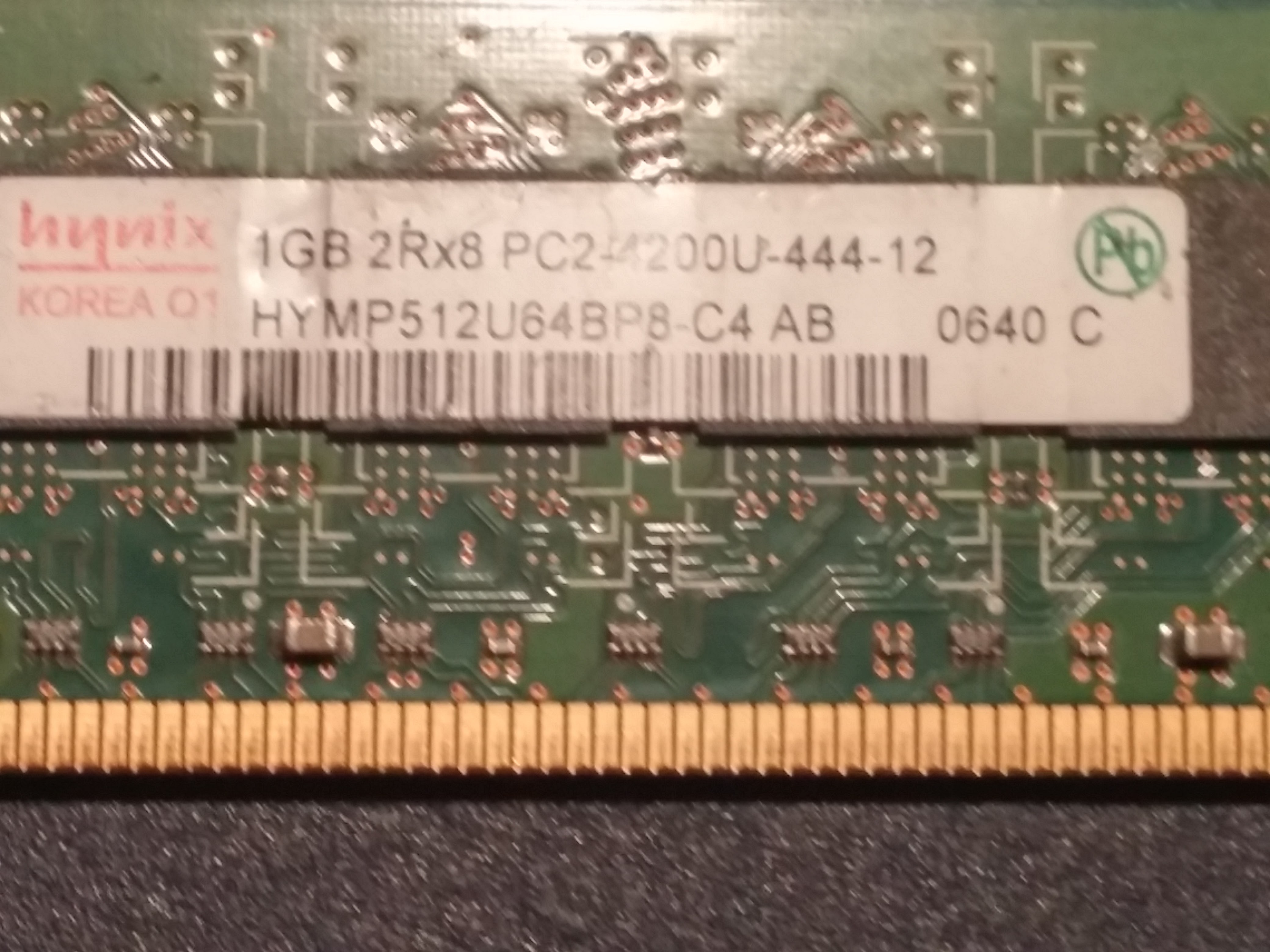

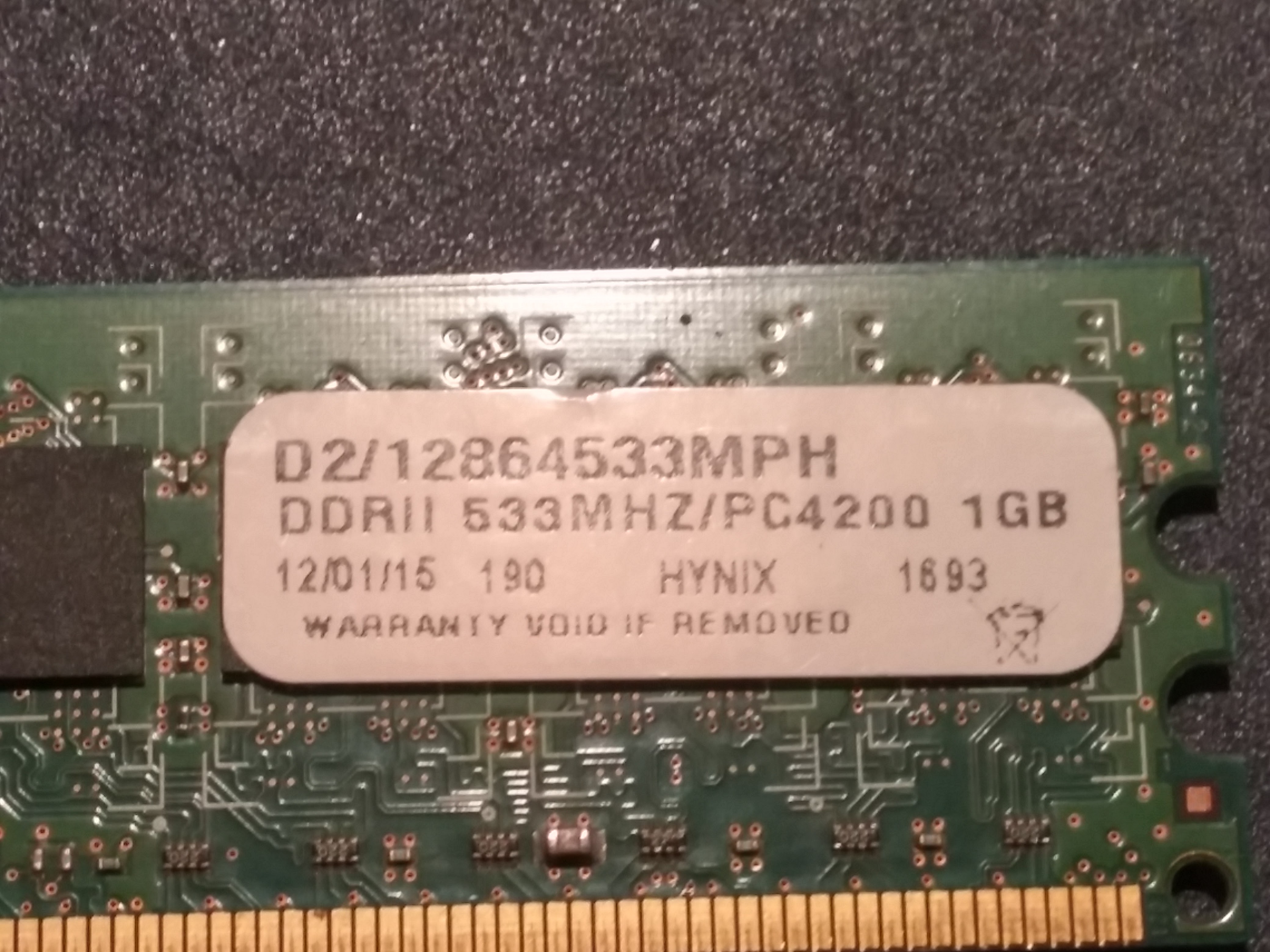

I bought new ram for my power mac G5 4 1 GB sticks and it doesn't startup! I'm not sure why I bought ram withe the same specs. Thanks for any help! 😀

did you do the cuda reset? does the old ram work without? did you put it in as a set in set slots? You will need to look up the ram install from apple guide to do it right. Its very finicky and must be installed a certain way in pairs.

So as you say that you have a late 2005 machine you have the right ram, assuming you're installing it correctly and that's it's good ram, it should work,
I had the problem on my early 2005 when installing ram can be temperamental as the solder joint in the ram slots become "dry" and micro crack. I think it's happening in mine and it took a couple of tries to get the ram to be recognised. So this might be what's happening to you as its quite a common issue.
Which slots have RAM installed now?
The RAM should be installed in identical pairs, from the center slots outward.
You said it won't boot up.
What does it do? (fans, blinking power LED, boot chime, no video, etc)
