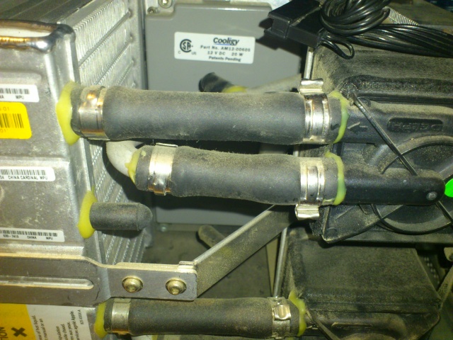

However, it often shut back down on startup and when I checked the stats, CPU B Diodes 1 & 2 were running around 89/91* whilst CPU A Diodes were running around 33*, which are where I believe they should be.
THE QUESTION!
Why does one CPU pair run so hot whilst the other runs so low? It seems as if either the workload is being routed solely to the CPU B pair, or that the Liquid Cooling System (LCS as we know it), is only cooling CPU A very well and not cooling CPU B very well at all.
This sounds like a thermal conduction problem, leading to either a malfunctioning LCS or even poorly applied/dissolved thermal paste. (I've heard the thermal paste used was highly toxic so any honest answers regarding changing this, please consider safety 😉)
There is hard green stuff around the tube connections of the LCS and no sign of any leakage, this seems like glue but if anyone has any other proven suggestions? How do I check the LCS is pumping and working well? Or that it is full with liquid?

There's two separate loops i.e. one pump and rad for each processor
On one the pump is broken / the system has leaked.
At least you know the processors not fried (yet) 😛

Do you know if the hard green stuff around the tubes in the picture is dried coolant or glue used to stop leaks? It doesn't look very standard. I reckon it'll probably make it pretty hard to get the tubes free to start the DIY too.
Also do you know which is for CPU A and which for CPU B, top and bottom? I'm thinking why mess with the system working well, and I'll just have a bash at the overheating CPU B.
Looking at your photo I notice a hint of green coating almost everything, this might be a sign of coolant leaking.
Tryp, that yellow stuff is epoxy glue to seal it shut. over by the pump it looks green because its translucent yellow over black. Its not leaking at those points in the picture. It may have clogged on the bottom cpu and needs to be cleared out, in the radiator/cooling block underneath.
They used the epoxy as a fix to ensure no leaks, sadly overtime the coolant crystalizes and clogs, like a car, without a flush.
CPU0 or CPU A is the top one, CPU1 or CPU B is the bottom one.
Thanks drorpheus, that confirms my earlier suspicion. Can I ask if it was practise at Apple to apply this epoxy glue or does this look like a user repair? I've seen a few photos of other LCS units, and the lower port on the left of each of the two lines looks like a screw cap, whereas on mine it looks like a glued end of some rubber tubing.
It sounds like I'll have to get my hands dirty on this one, but anything's worth a shot. It would still be a serious computer if I could fix this one problem.
@Jbarley - I think this must be the hue on my cameraphone, it's actually a horrible, fine, sandy dust which covered almost everything inside when I received it! This photo was before I plucked up the courage to start unscrewing everything and getting in with the air cannisters. Which worked to a certain degree!
