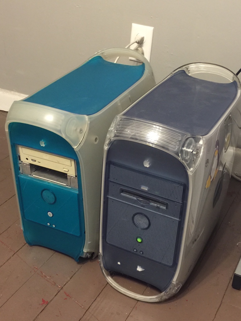

I picked up two more Power Mac's yesterday on Craigslist. I got a 300MHz G3 and a 450MHz G4. It got me thinking about upgrading them to the best of their ability. So I was just wondering if someone could point me in the direct of where to purchase these upgrades or is just keeping an eye out for them when they pop up the best options? I also have a 450MHz G4 Cube that I would like to upgrade as well.

Your G4 looks to either be a Yikes!(PCI graphics) or Sawtooth(AGP graphics) model. A Yike! uses the same ZIF CPUs as the G3, and many upgrades that will work in a B&W G3 will also work in a Yikes!. The Sawtooth uses a totally different CPU socket, so you will need to look for Sawtooth CPU upgrades.

Thank you guys very much. The G4 is definitely a Sawtooth that does still have the Rage 128 in it. Everything looks stock except for the ram. Installed Panther on it and everything works fine. The G3 I haven't even tried since it only has a VGA port which I don't have anything to connect it to at this time. It still has its original 6gb HDD. I just have to keep an eye out on upgrades and try not to spend to much on them. This gives me a pretty good idea what to look for now.
If you have a Sawtooth with the stock Rage 128 Pro AGP then you will want to ditch it and swap it with a Radeon if you want to use a HD monitor. I have been messing with the Rage on mine and the best it can manage is 1920x1080 from the VGA port with the screen display heavily offset to the right on OS9 or only 1280x1024 under OSX or from the DVI port.
The same card in a Quicksilver had no problems displaying 1080p correctly, so it seems to be some funky firmware/hardware glitch in the Sawtooth that doesn't play nicely with this card - at least for me. Luckily, Radeon 9000s are cheap and plentiful on eBay.
