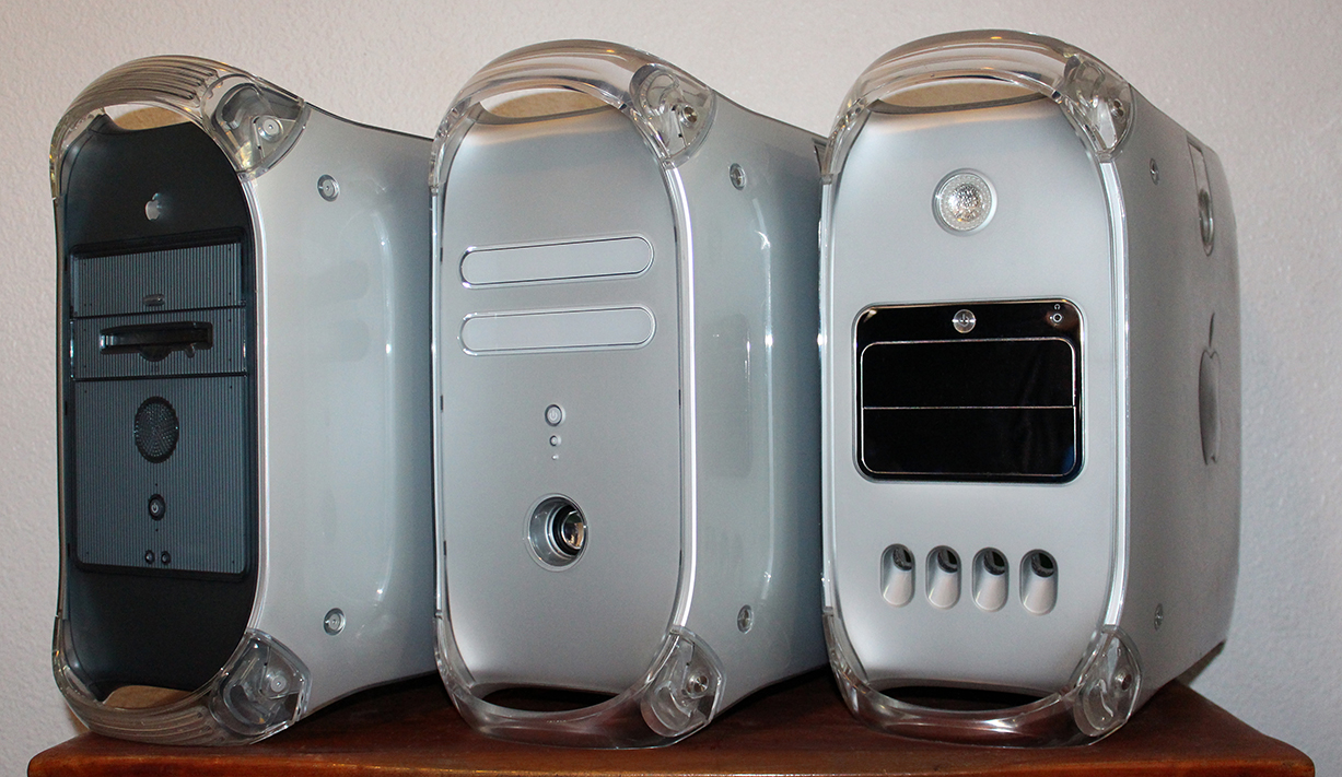

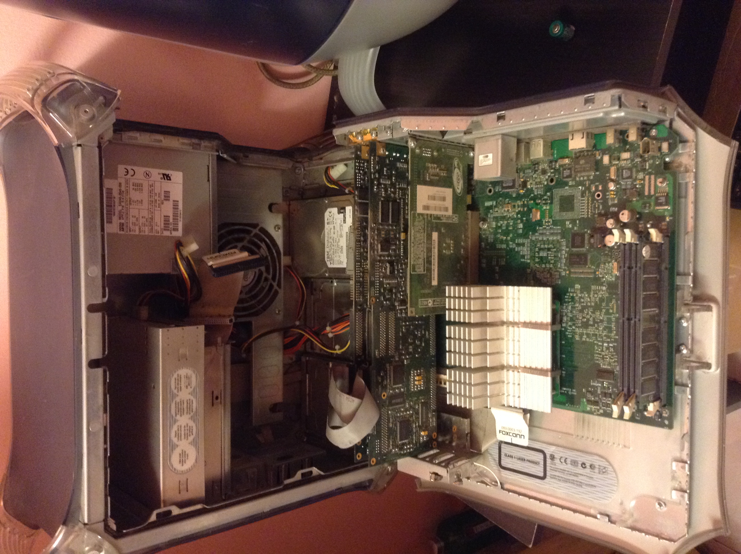

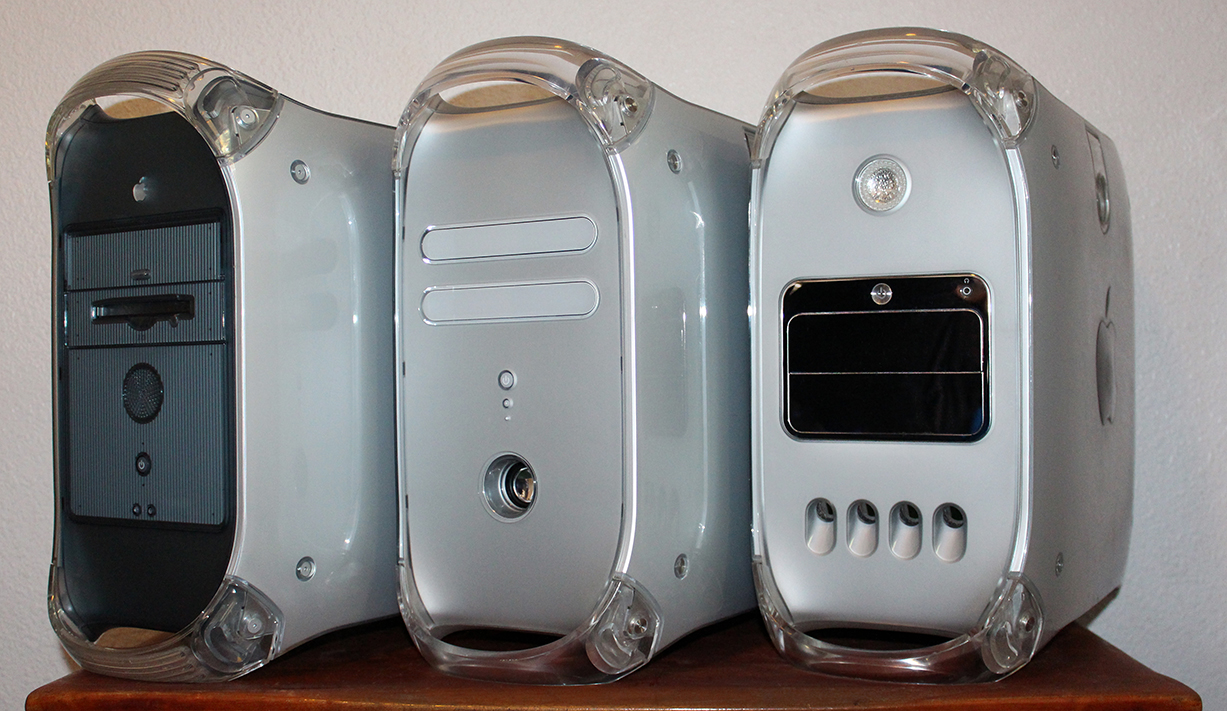

Though i was having difficulties in obtaining the last piece of my collection of the Power Mac G4 Tower series...the wait is now over !
The Power Mac G4 (AGP Graphics) model had put an end to it, thus completing my Power Mac G4 'Trio Collection'. It is smoothly running 10.4.11 though a physical clean up of the tower was much in need!

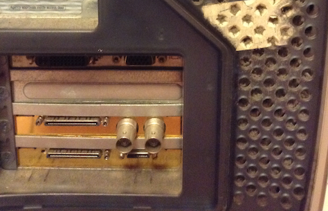

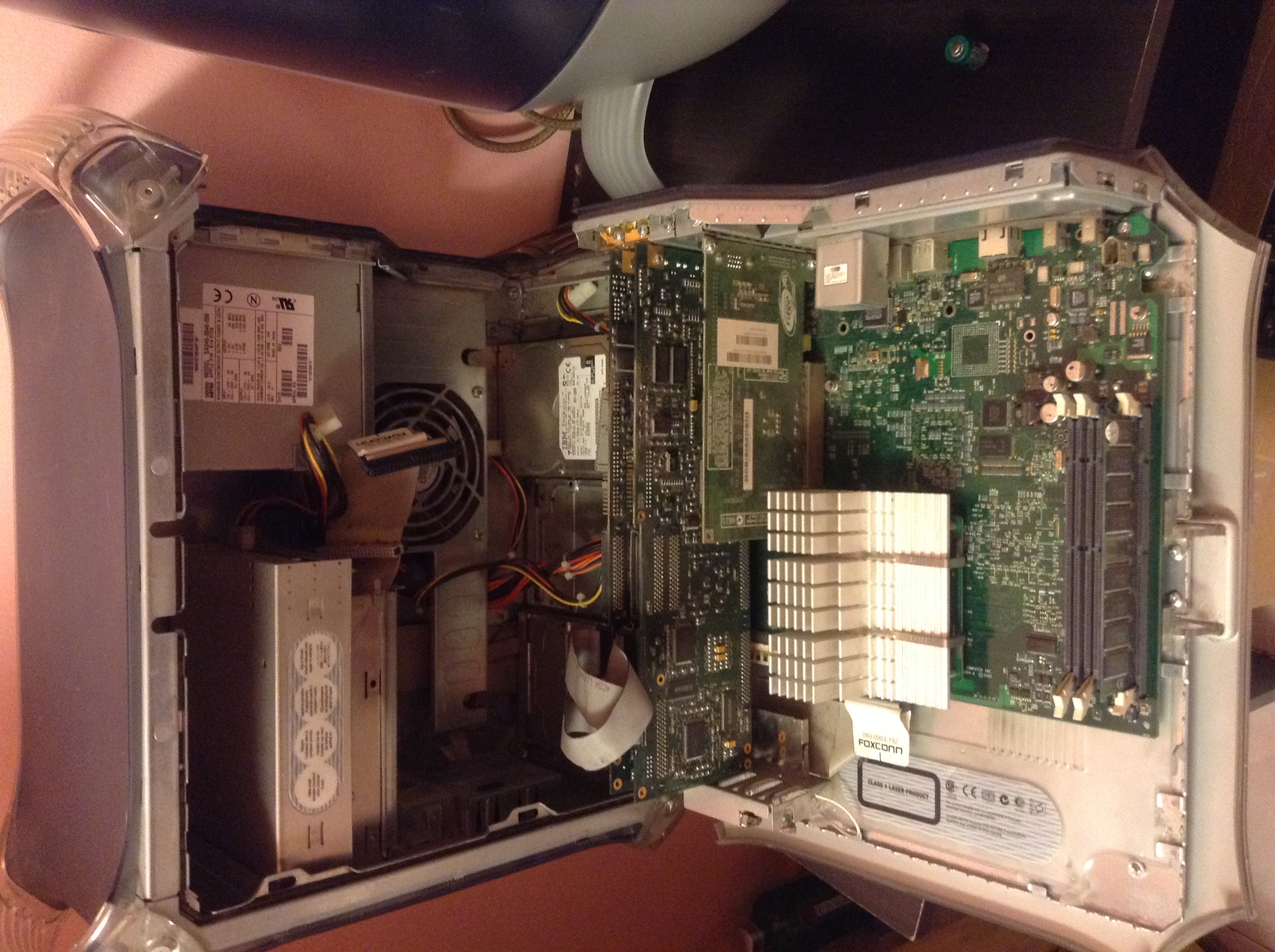

However, i am a bit curious of the add on card, which i am not sure of its purpose .... Any of you guys can enlighten me ?

The only needed card is a video card. The AGP Graphics G4 would have one in the AGP slot, but could have that AGP slot empty when using a PCI video card.
Or, an AGP video card, with an additional PCI video card for additional monitors. There's a variety of other possible PCI cards, and could be one that someone added at some point.
Maybe you could describe the ports on that card, and there may be internal connectors on the card - for a SCSI card when someone wanted to have a SCSI drive, or multiple internal drives - which could be up to 4 internal hard drives.
So, lots of possibilities.

sorry...there was an up load error, some how the pictures which i loaded did not make it with the initial post...i have rectified it.
true, it must be a card added by the previous owner...

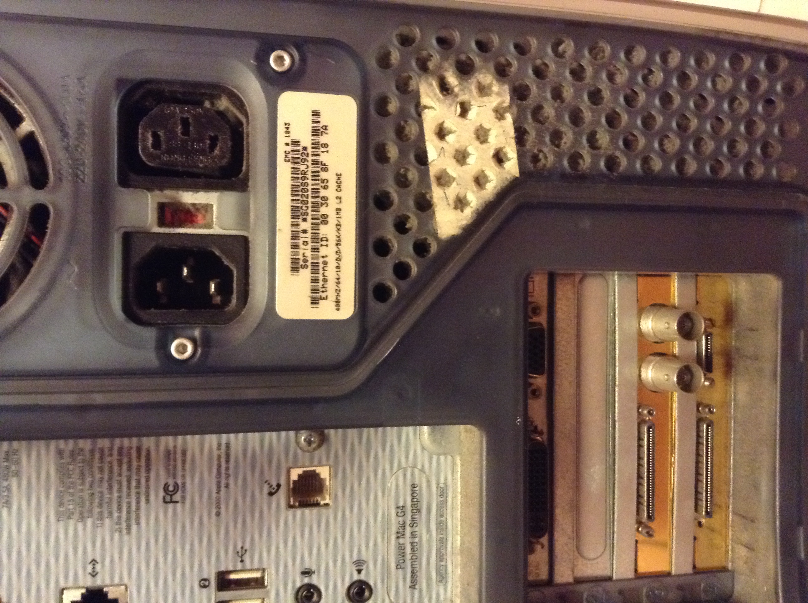

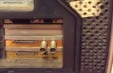

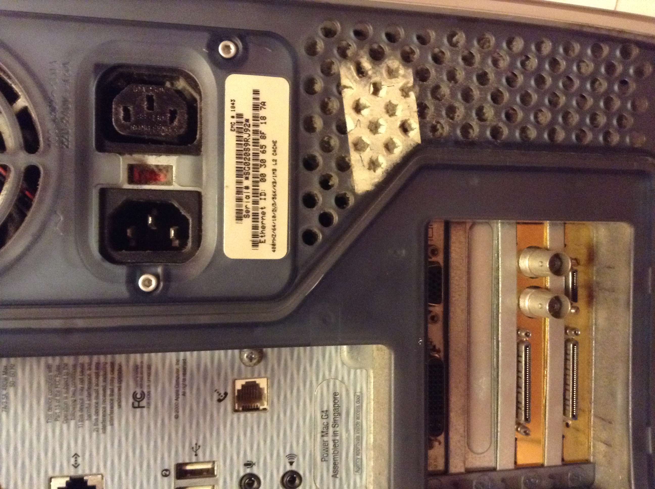

The connectors along with the BNC plugs would lean me toward thinking that they're interface cards for a scientific instrument of some sort.
If this is indeed what they are, the cards are likely marked with the name of the instrument company on them somewhere. If you post all the markings on the cards, this could help confirm my thoughts.
Also, if you are still running on the original install of the OS(or have the hard with that install) any software installed can give a clue.
If they are indeed instrument interface cards, those can be worth fair bit of money to the "right" person. Scientific instruments often have a fairly long lifetime and are kept in service "past their prime" as they are still needed and the money doesn't materialize for replacements. I use a TGA (thermogravimetric analyzer) from the early 90s on an almost daily basis, and we have a couple of potentiostats from the mid-80s kicking around our lab. Often times, a computer and/or interface card is the least durable part of the set-up.

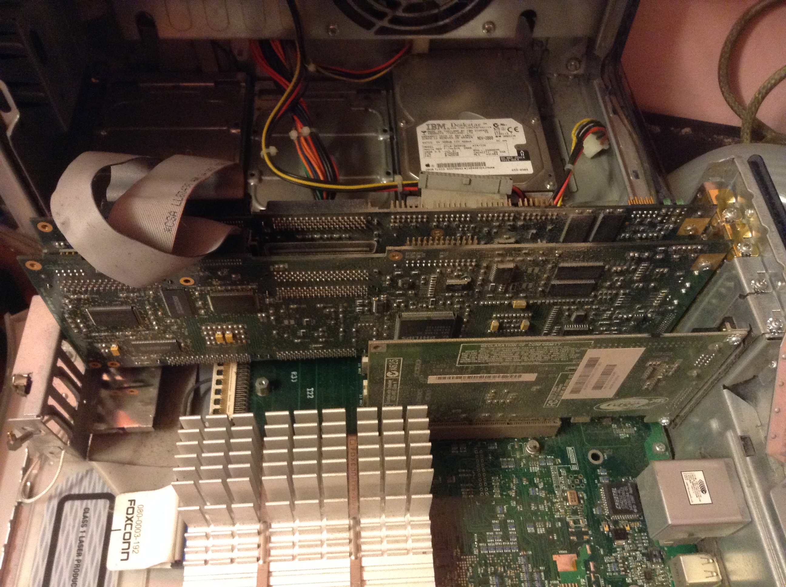

Could you post clear pictures of both the top and bottom of both of the mystery cards? You'll have to remove them from the machine first.

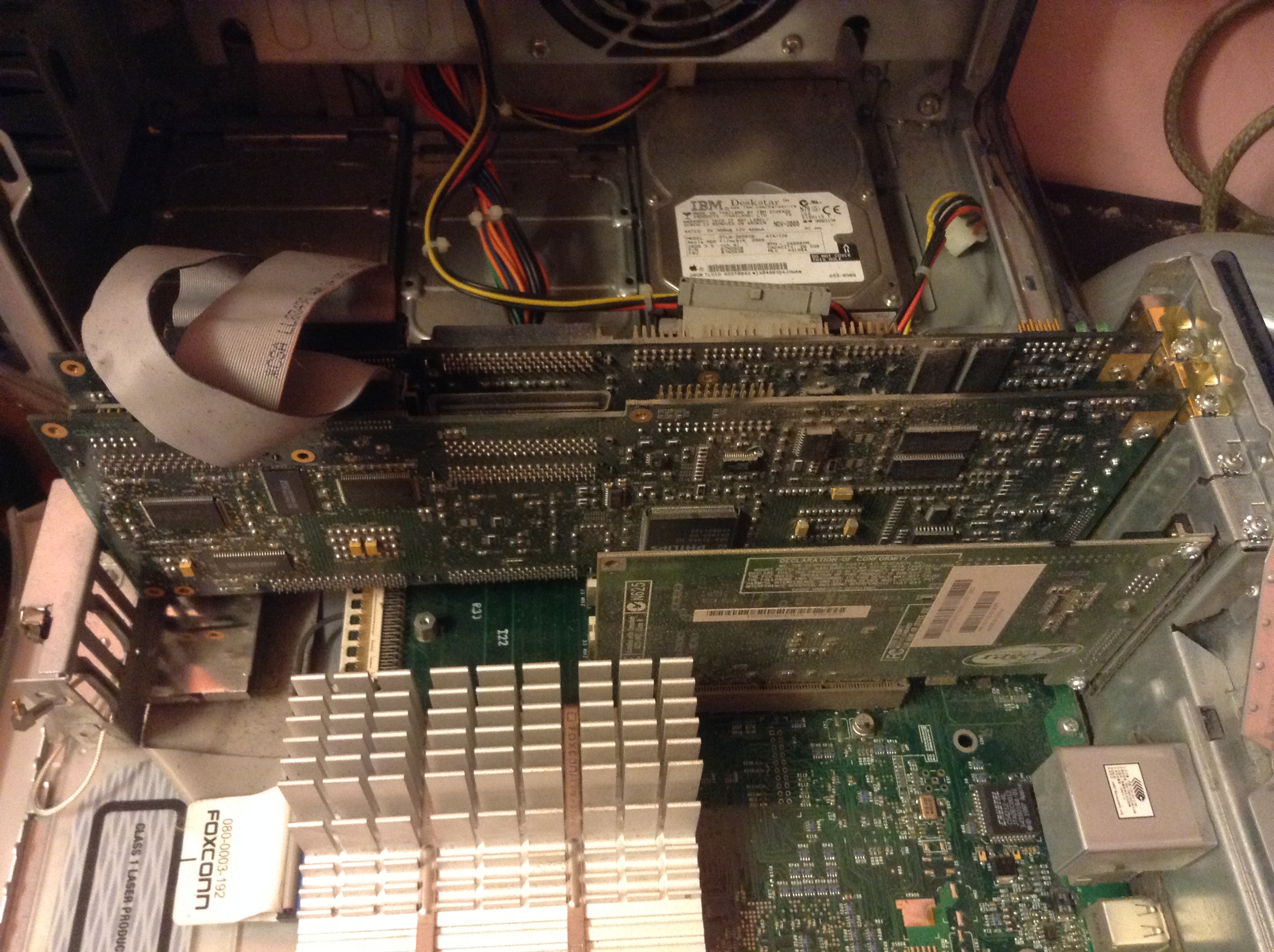

'Mystery Cards'. Ha ha.... That makes it mysterious. I took a peek into the tower....My Goodness...the cards are almost A feet in length! It shocked me, honestly I've nvr seen an add on card such as this ....
Will post sm pics whn I get back home

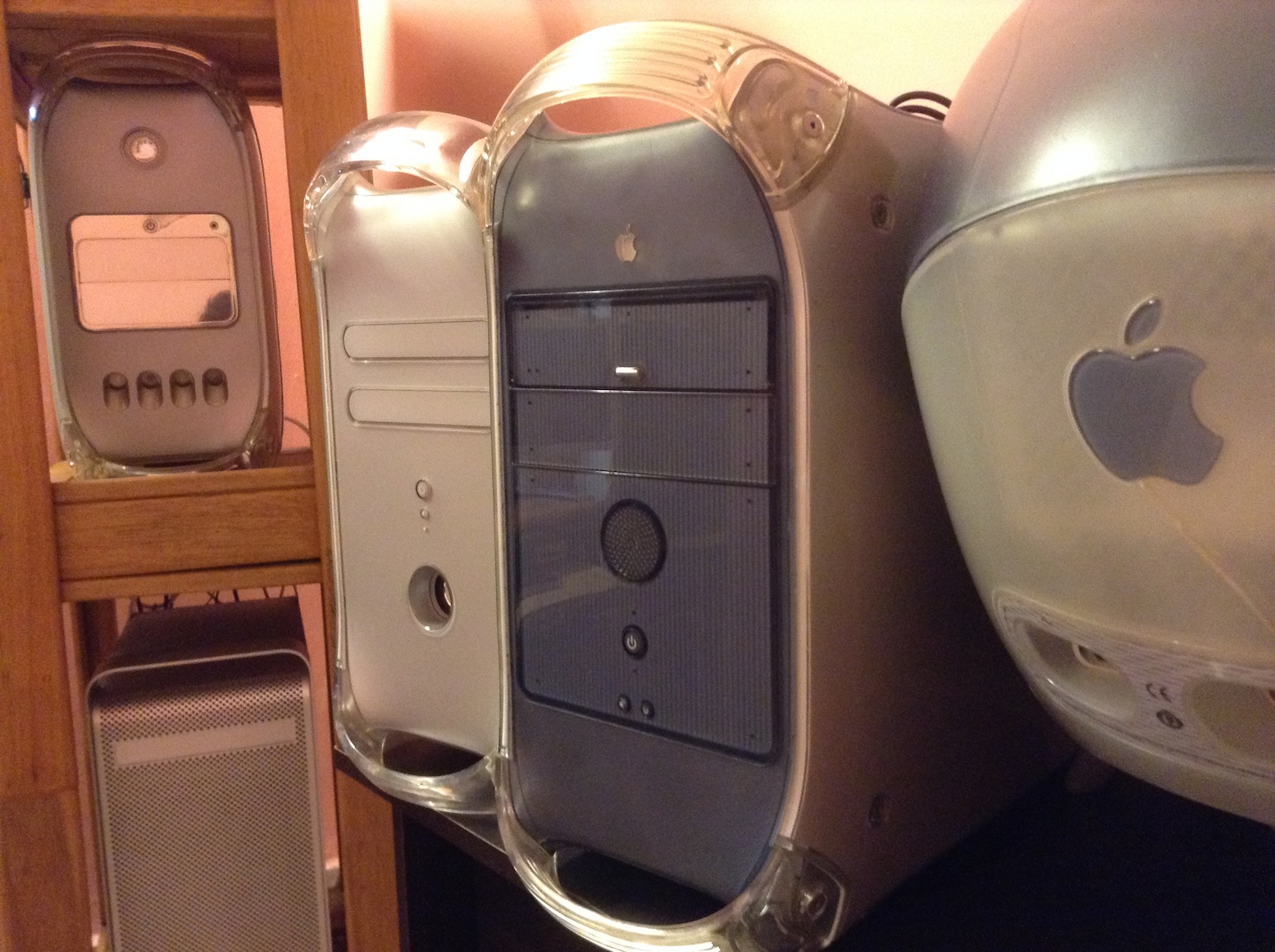

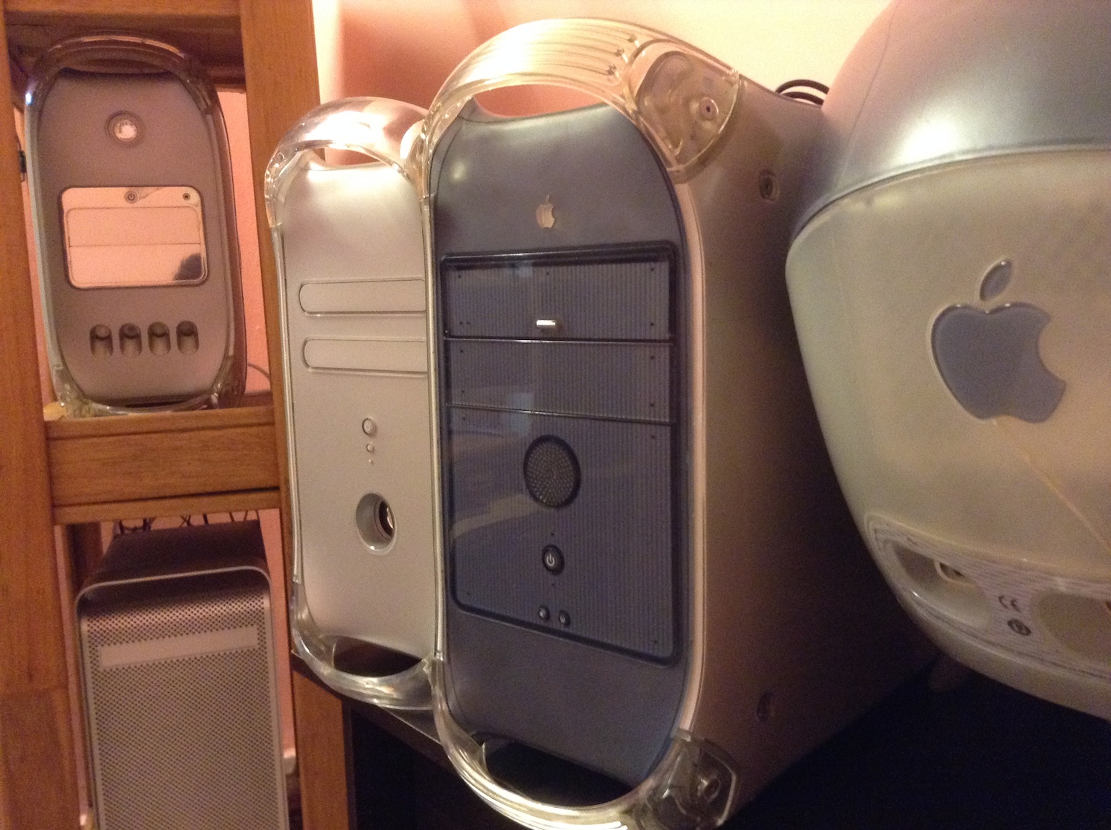

I've got the collection as well. 466MHz DA, Dual 1GHz QuickSilver, and a Dual 1GHz MDD. The MDD may be leaving soon!

I am probably about to be proved wrong but those look like external SCSI ports.
SCSi ok, thanks for the keyword. i googled but dddnt find any SCSI which was an exact match. I guess it was some version of SCSI. I just wished that it was a SAS card, coz i have a need for a SAS card.
Thanks.
Thanks.
See if any of these ports exactly matches. I couldn't tell really when zooming in on your image.

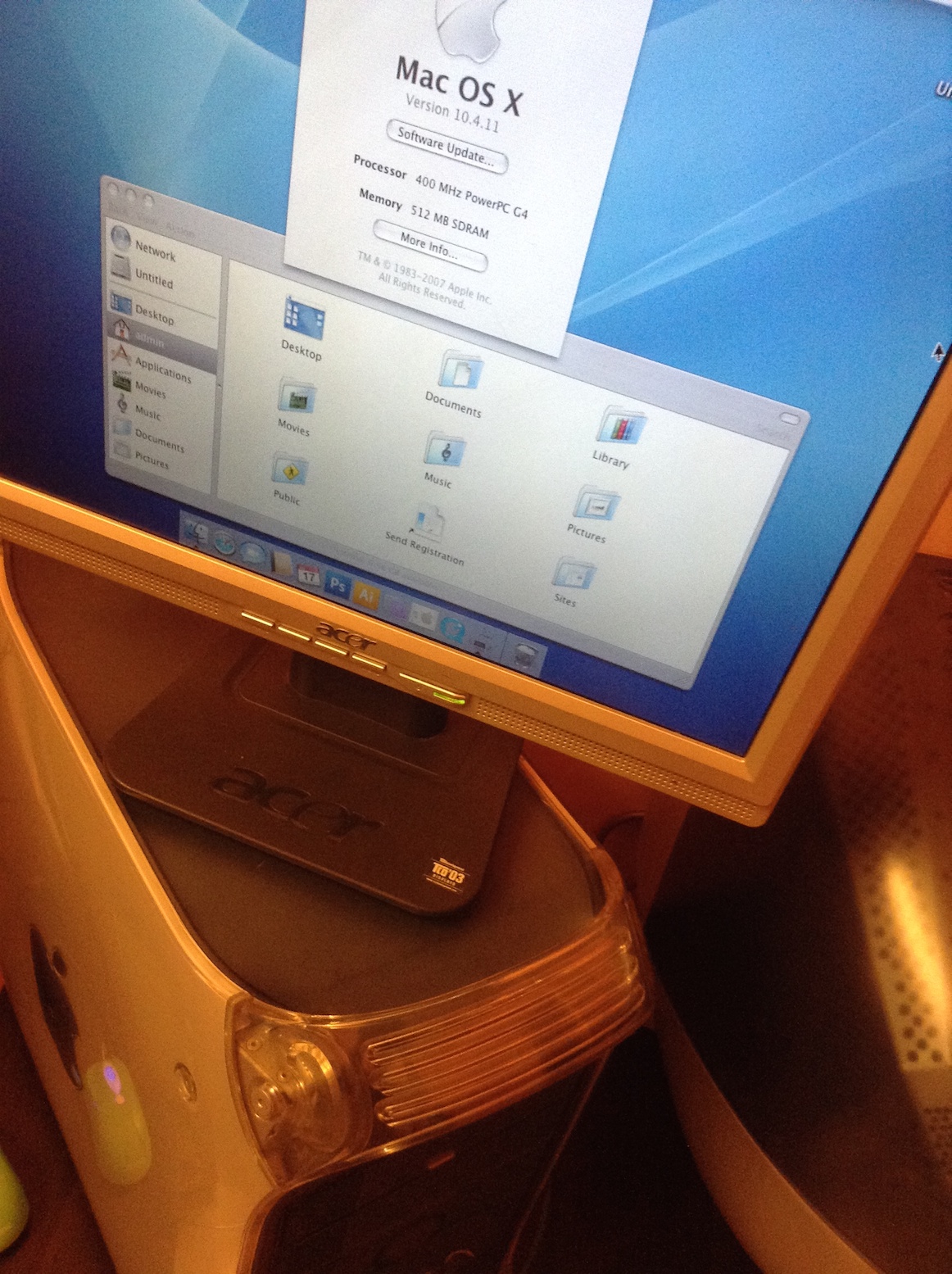

What does System Profiler say? It should give you at a minimum a Vendor ID and Device ID, which should help you identify the card from googling.
oh yeah, i did check...but it says nothing much. just mention about ...(ok, i forgot, what it actually mentioned !, but nothing out of the ordinary)
The thing is, i dot have the G4 connected to a monitor, every time i boot it, i have to haul a monitor from another machine. I did take a screen shot of the system profiler, but forgot to copy it out.
I know that i can share screens through my local network, which i rushed to do...sadly i dot know the password for the user account !
Ive seen posts about getting around a password in an Intel Mac, i guess i need to google that first.
It would be easier to get the monitor connected, look at the aforementioned IDs, which SP will give you and google for the answer than to pull the cards out, photograph and hope for someone to guess what they are.
And FWIW, they do look like external SCSI connectors to me.
