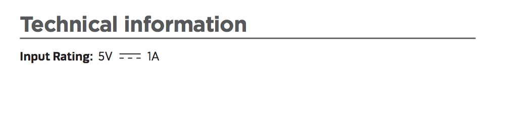

And then I checked the documentation for the headset but I cannot really figure out what it is supposed to be drawing in order to charge, however I feel like 500 mA is adequate enough although should take longer.

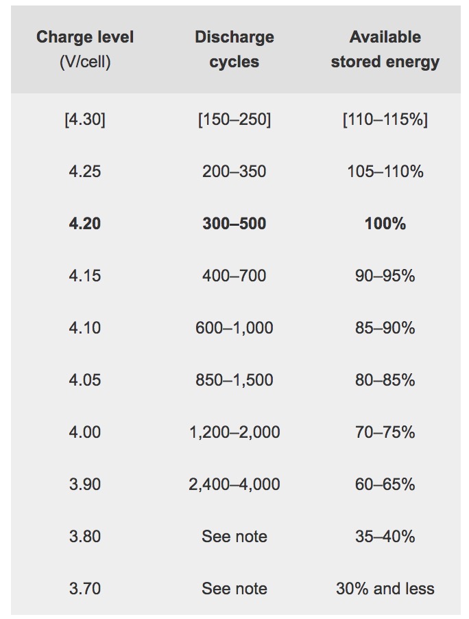

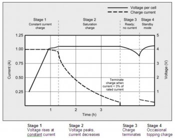

In regards to many devices using lithium batteries, even when a charge indicator says that the unit is fully charged (whether that be a green LED, or a 100% message on a screen), it's not true. Often the full charge indicator presents after the fastest charge cycle of the LiCo is complete, where it has reached near full but not full capacity. (For example, a device may report full capacity at the end of stage 1.)
Presumably, this is done by Makers for at least two major reasons, 1) it means a consumer can use the device faster (the rapid portion of the charge cycle is fast, and gets the battery to near full capacity, so a consumer can do a quick charge-and-go and will get nearly as long run times without waiting for the slower part of the charging process to finish), and 2) it prolongs the service life of the LiCo by not charging it to its peak voltage (where the battery is inherently at a point of greater stress.) When a consumer sees a message/indicator the charge is complete (even though it isn't) and they remove the device from charging, they may be (unknowingly) increasing the service life of that battery.

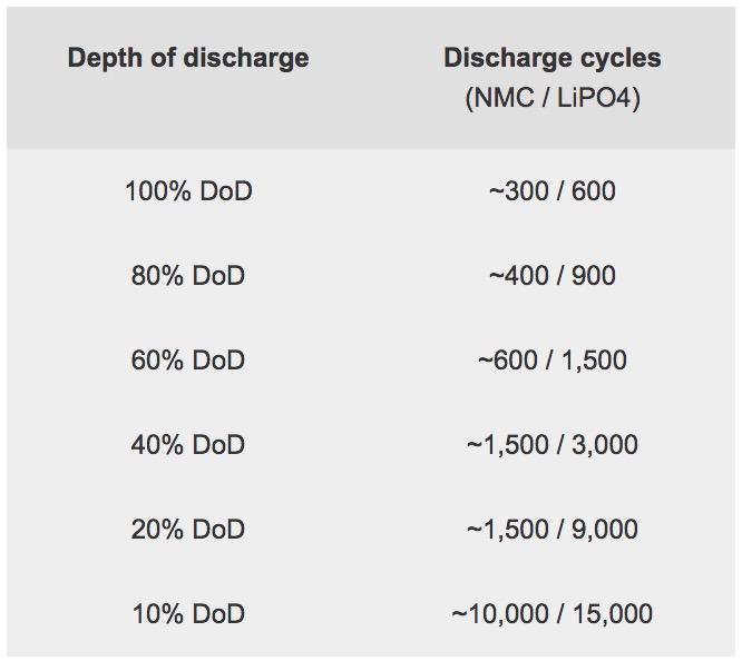

(Similarly, 0% almost never means 0% [as this would ruin the battery and present a potential hazard if stored in this state for an extended period] - the device terminates functioning at a set point to preserve the service life, as the lower the depth of discharge, the shorter the service life, and most consumers will run LiCos completely empty with the incorrect belief that deep discharge = good)

Just so you know, it looks like your headphones will take up to 1A (1000mA) while charging, but your MBP is limiting current to stock USB-A spec of 0.5A (500mA). You may want to try charging your headphones using a charging brick that provides higher amperage (iPhone chargers provide 1A and iPad chargers can go up to 2.4A depending on model) and time it to see if if your headphones recharge at a significantly (~2x) faster rate.
