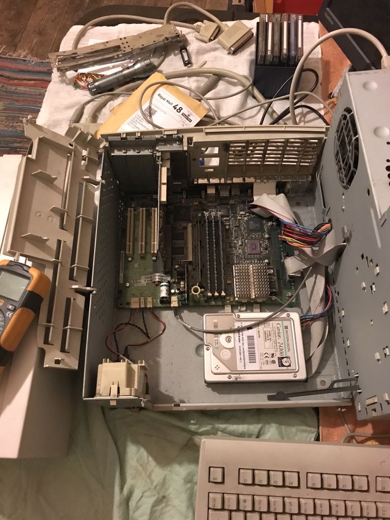

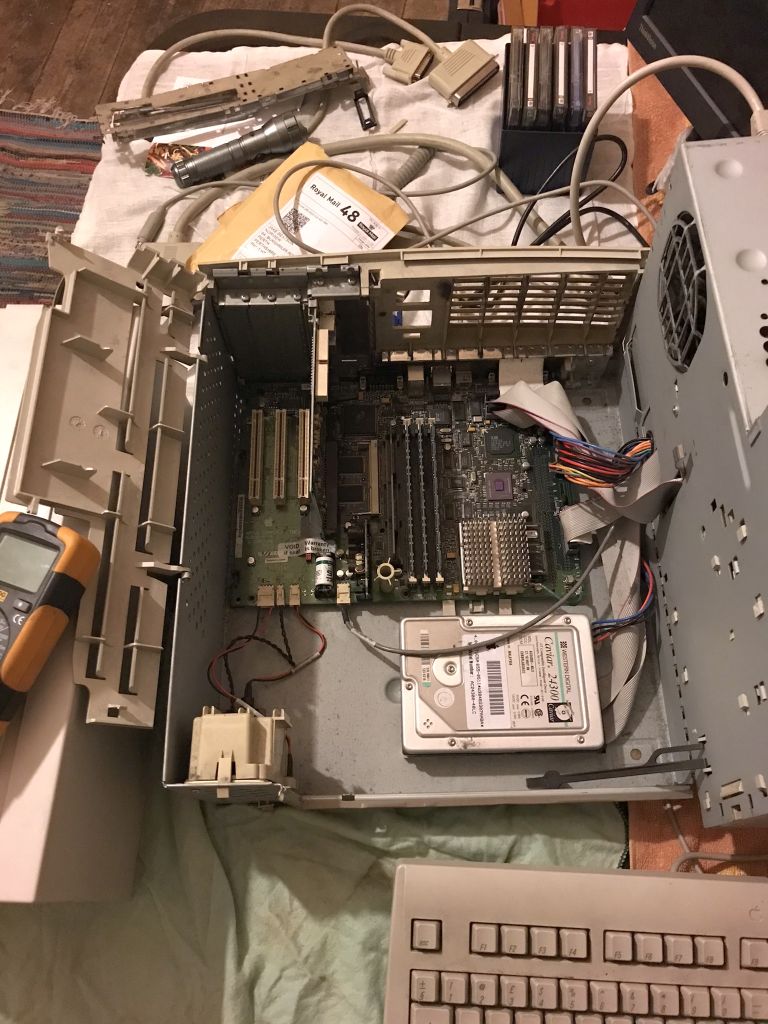

Just joined, and first post from a cold and wet Scotland... 🌨️
In the dim and distant past, our company was taken over, and we were forced onto PCs.
At the time we had the option to buy our Macs, which I did, and it's been lying there unused until now, when I was supposed to be starting my retirement project of hooking up all my old hard drives, and recovering all my old photos.
Of course, it hasn't gone like that...
Instead of the welcoming 'boing' I have a machine that's completely dead: no sign of life at all.
I tried fitting a new 3.6V battery, in case it was related to that (I didn't think so, but it was cheap enough to try), and of course it made no difference.
Question is, what sort of thing can go wrong to give this problem when the Mac's been lying doing nothing, and is there anything I can do to try and bring it back to life myself?
I can handle a screwdriver and a voltmeter, but electronics are completely beyond me...
Any tips of things I can try to bring it back to life would be very welcome.
Is there anything I can do to check the output from the power supply?
Do the start buttons fail?
Look forward to any helpful suggestions, and thanks in advance

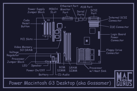

Yeah. I removed that in my edit because i saw you already replaced it. I didnt read carefully enough the first time. Check the battery with a multimeter to make sure its actually good, its possible to get a defective one. It should also boot with the battery totally removed if you want to try that and see if it does anything. Im not sure if the beige g3 has a pmu reset button. Look for a button labled pmu on the motherboard and if it has one press it once and only once. Do not hold it down or press it twice or you could corrupt the power management unit.

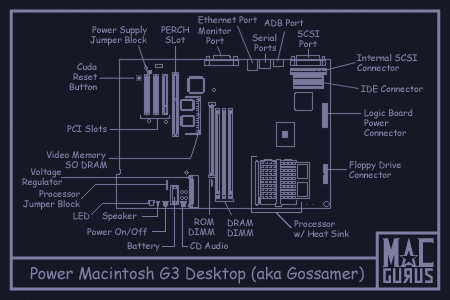

I found a diagram for that logic board. The button is labeled cuda but the same instructions still apply. Press once and only once, dont hold it or press twice. Did you try the power button on the keyboard. Im assuming you have the proper ADB keyboard for it. It should have a power button somewhere on it that will probably be labeled with a weird triangle.

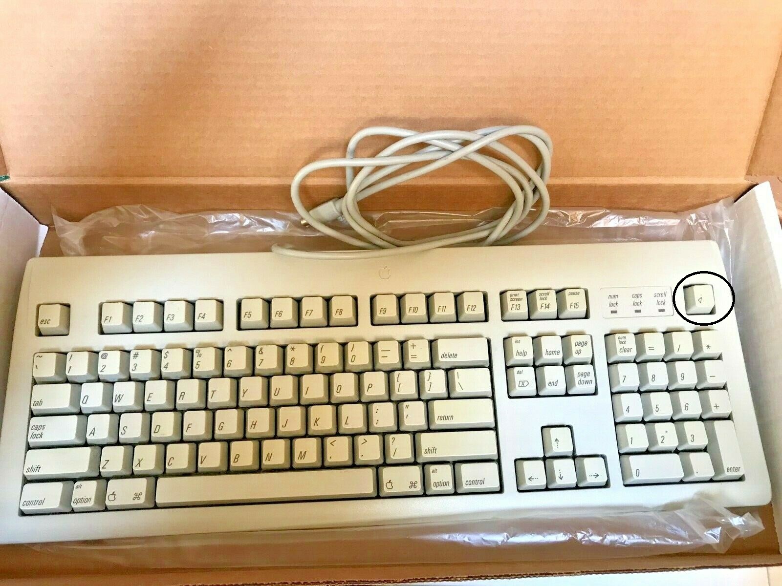

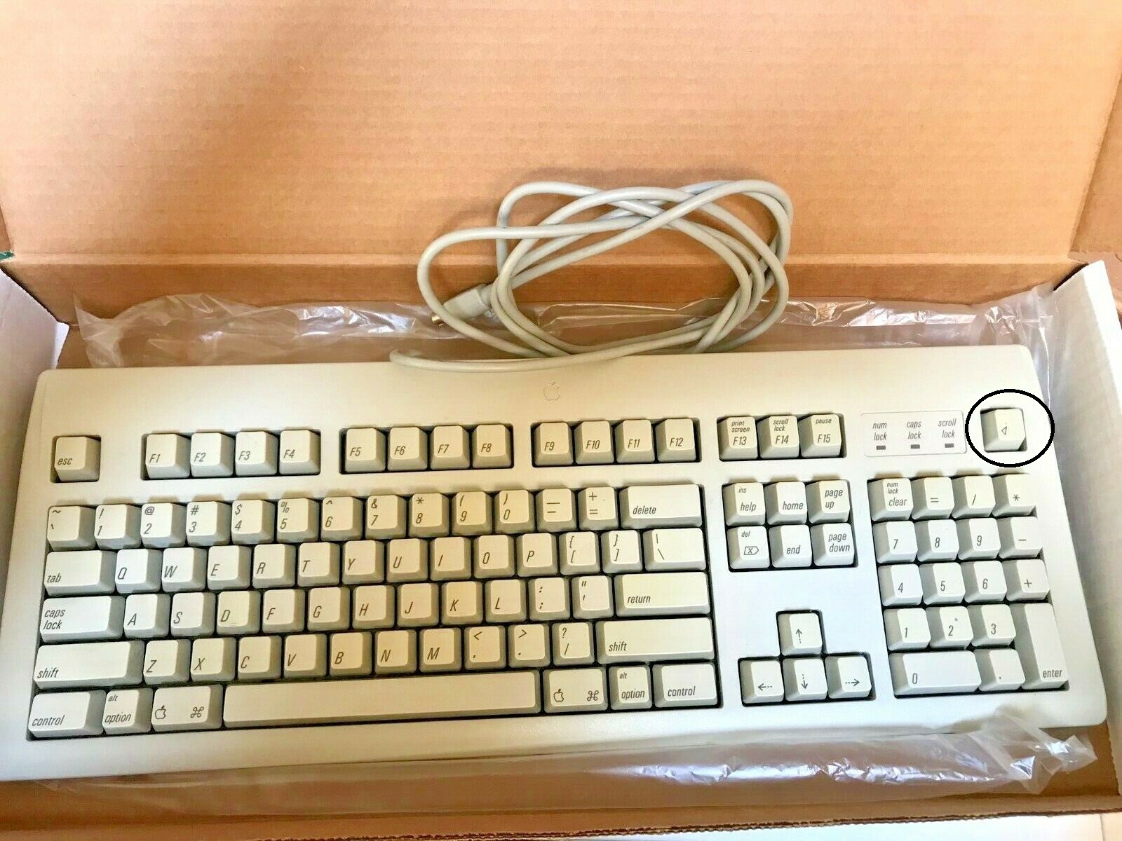

Are you sure it doesnt. Most ADB keyboards did. Sometimes it doesnt look like a power button. I attached a picture with one style of power button circled. Yours might not be the same but i think they were all labeled with that triangle symbol.
Yes, you're right. It does have one, but not along the top where I was expecting it. No joy though, but thanks for the tip

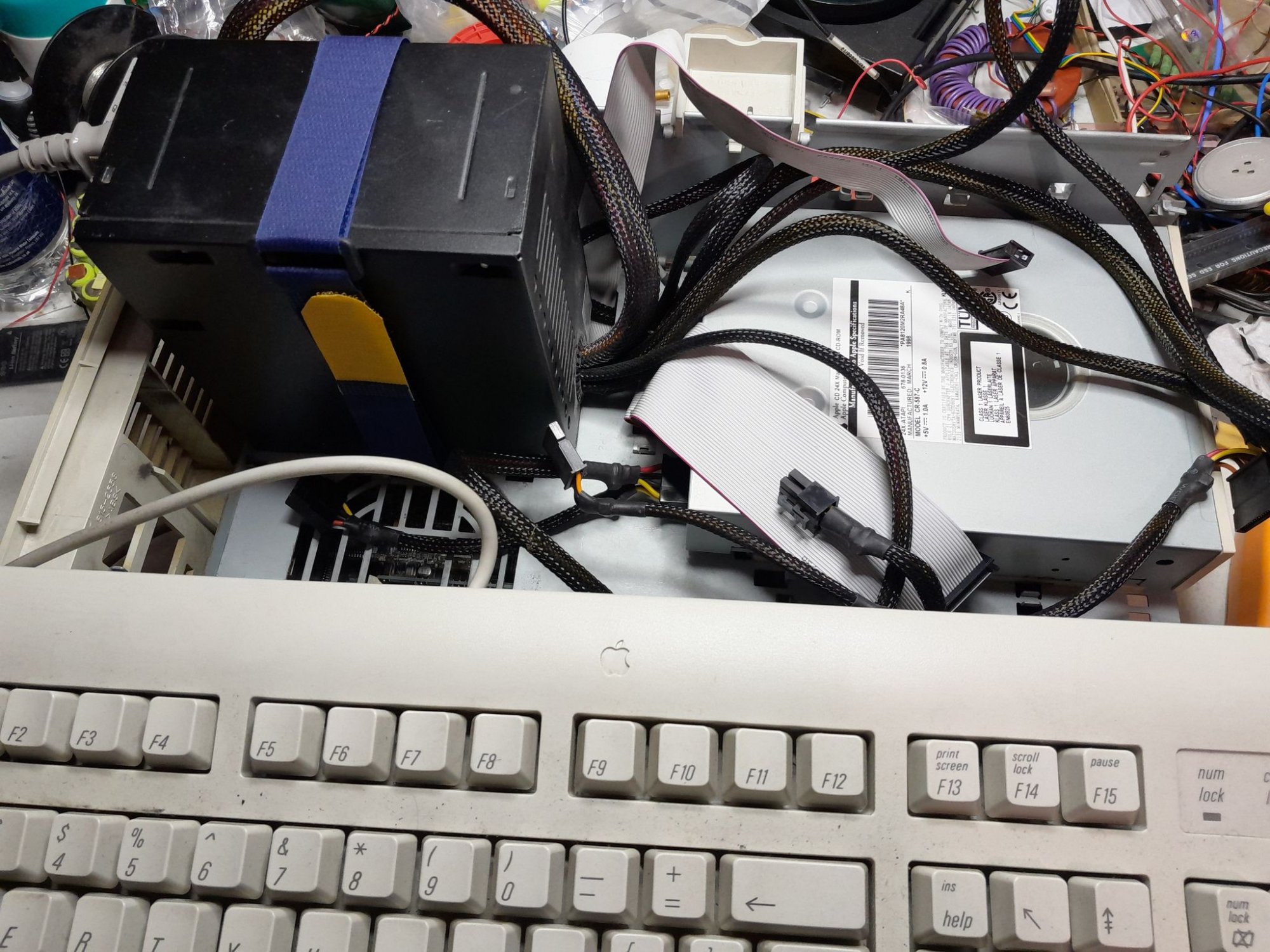

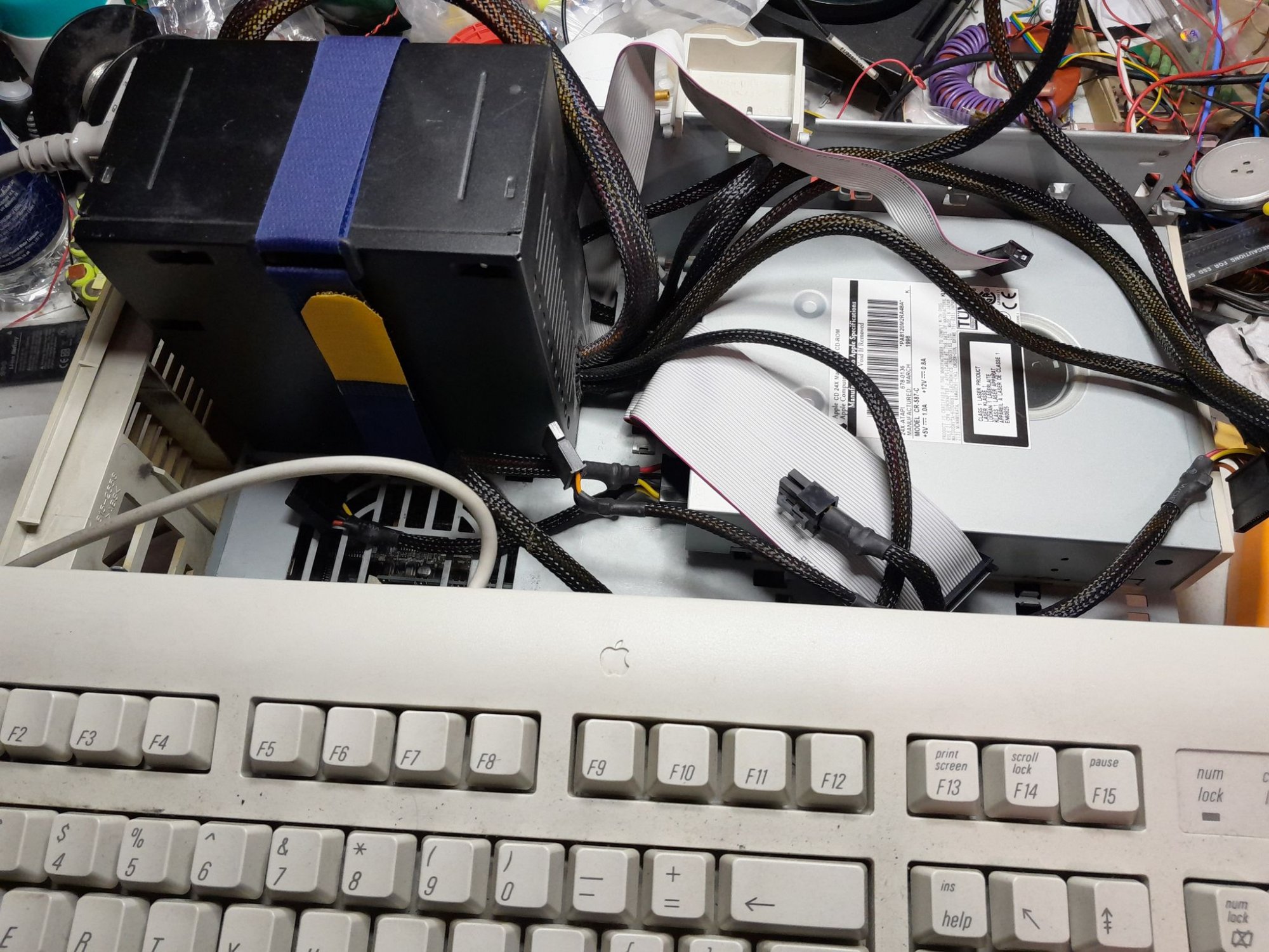

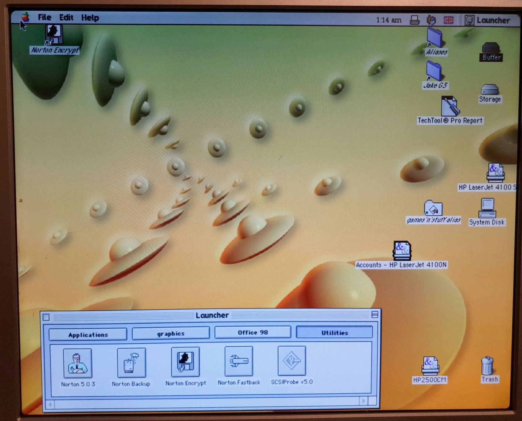

Just an update for all those helpful replies.
Got nowhere with anything, but a friend who's an electrical engineer volunteered to have a look, on the 'we've got nothing to lose' principle. He wasn't able to do anything with the power supply, but got some info on line about adapting a PC supply to suit.
"The power supply had none of the obvious faults and the area I think has the problem, is full of unidentified components and the internet provided no circuit diagrams. So instead, I found online how to make the Mac work with an ATX PC power supply and have bodged one in, as ATX is a different size. It looks horrendous but does seem to work, so you should be able to use it and then see and hopefully extract anything you want"
Hopefully on the home straight now!
Again, thanks for all the help.
