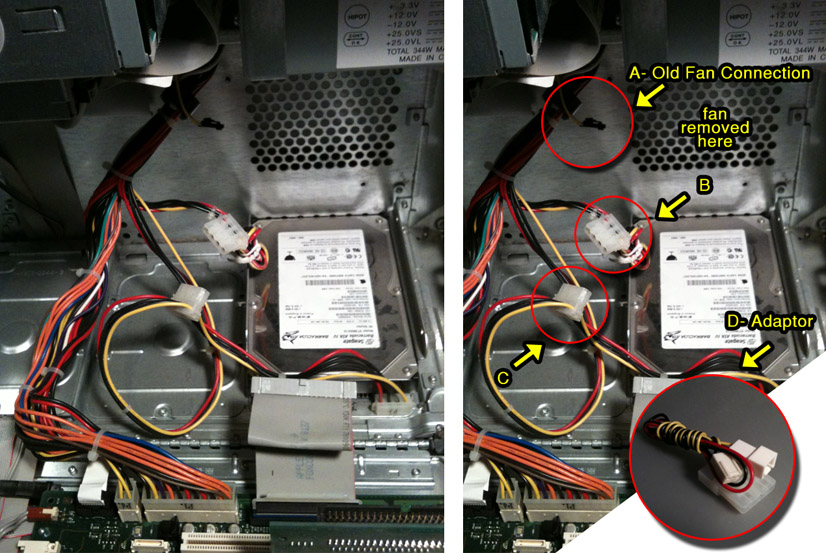

I have a Power PC G4 that I am trying to get rid of but wanted to wipe the hard drive first. After turning it on I heard bad sounds from the fan region. Sure enough, the fan blade is cracked. I also spotted something that doesn't look right though I have no idea what it is or what happened, and I fear heat may have been the culprit (images B and C.)
So, 2 questions:
1- Where might I find a replacement fan?
2- Is there something wrong with that black wire (terminates in white plug) that seems to connect to nothing, and the melted brown scab peeling away from the rest of the board below it? (See B and C.)

Do either of you suspect there is an issue with the apparently unconnected cable (images B & C) and the crispy-camera-film-looking material peeling away from the board?

Are you able to tell if I should be concerned about the other issue shown in images B and C? I don't want to replace the fan and sell the device without knowing if that is a problem as well.

no, the brown stuff is just a pice of tape and that wire looks as if it is to connect to the dialup modem (which probably isn't installed)

I purchased the Akasa fan you linked to, and have the whole thing apart and ready to install. The fan I bough appears to be 3-pin whereas the one I'm replacing was a 2-pin. Also, the old fan's connection had visible pins, whereas the new fan't connection seems to be female.
Do I need a female 3-pin to male 2-pin adapter for this thing?
@ Dave H:
The yellow wire is an RPM sensor, and does not need to be connected on a QS.

So I should use the adapter (D) that came with the fan, but where (B or C) should I connect it then?

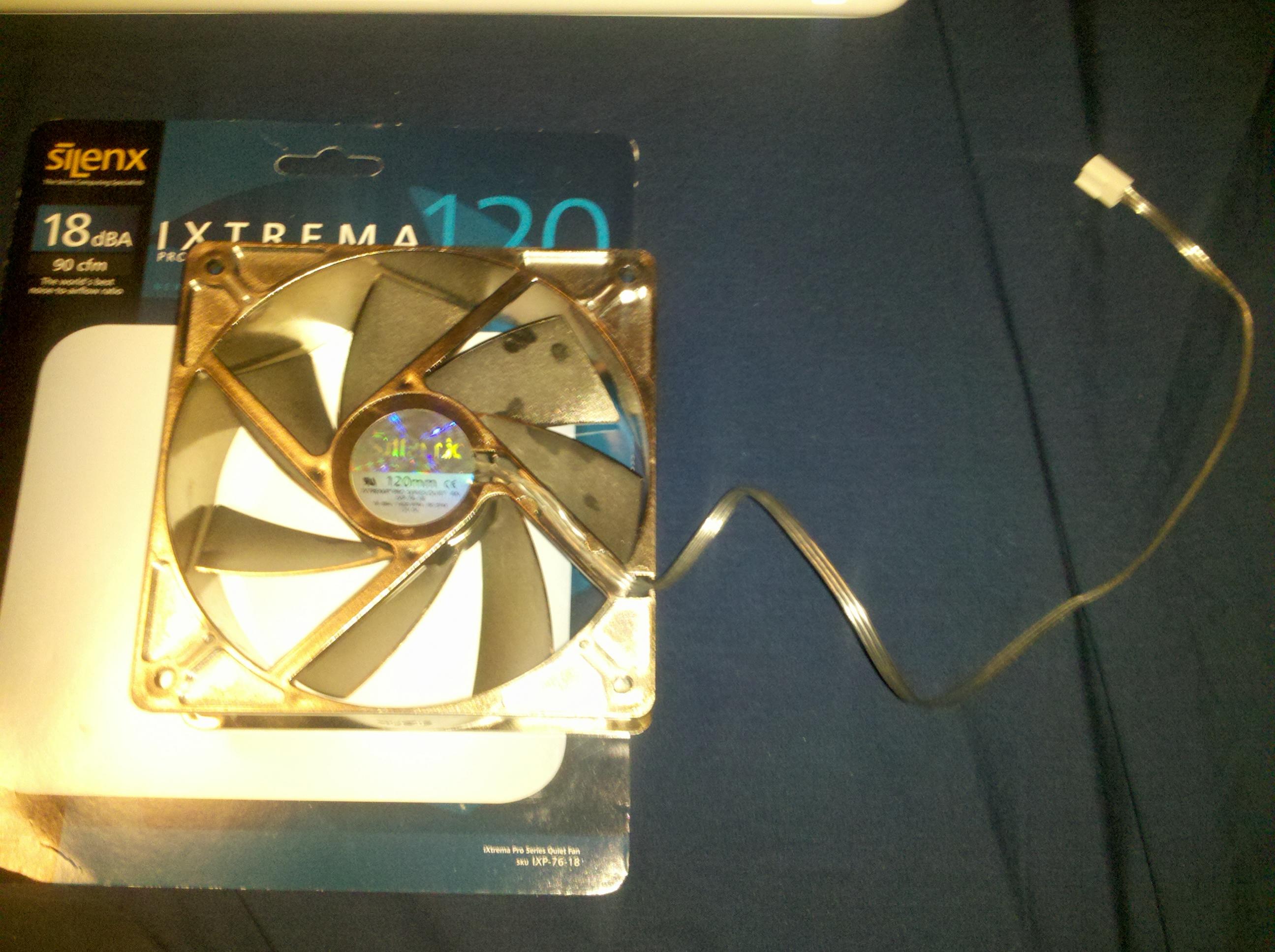

Alright, new fan is installed and connected.
I closed the case, reconnected power, monitor and speakers and fired it up. Everything boots up fine, but I couldn't hear the fan at all. This concerned me because previously I could hear the old cracked fan blade hitting the cage right after hitting power. I thought I may have a very quiet fan, but I opened the box and the fan wasn't turning.
How should I check to see if the fan is working? How long do I have to run a diagnostic before I cook everything in there from over heating?

The connections seemed fine, but I plugged it into the other spot to see if that made any difference.
I powered it up, and still didn't hear the fan. I open the case and took a look, and the fan blade jitters every so often, looking like it's getting power but doesn't know what to do. A video of this is available here:
http://www.blueapplestudio.com/misc/Fan.MOV
I'm guessing it isn't working right. I'm going to do some more research, but if anyone is familiar with this behavior off the top of their head I'd be thrilled to know a solution.

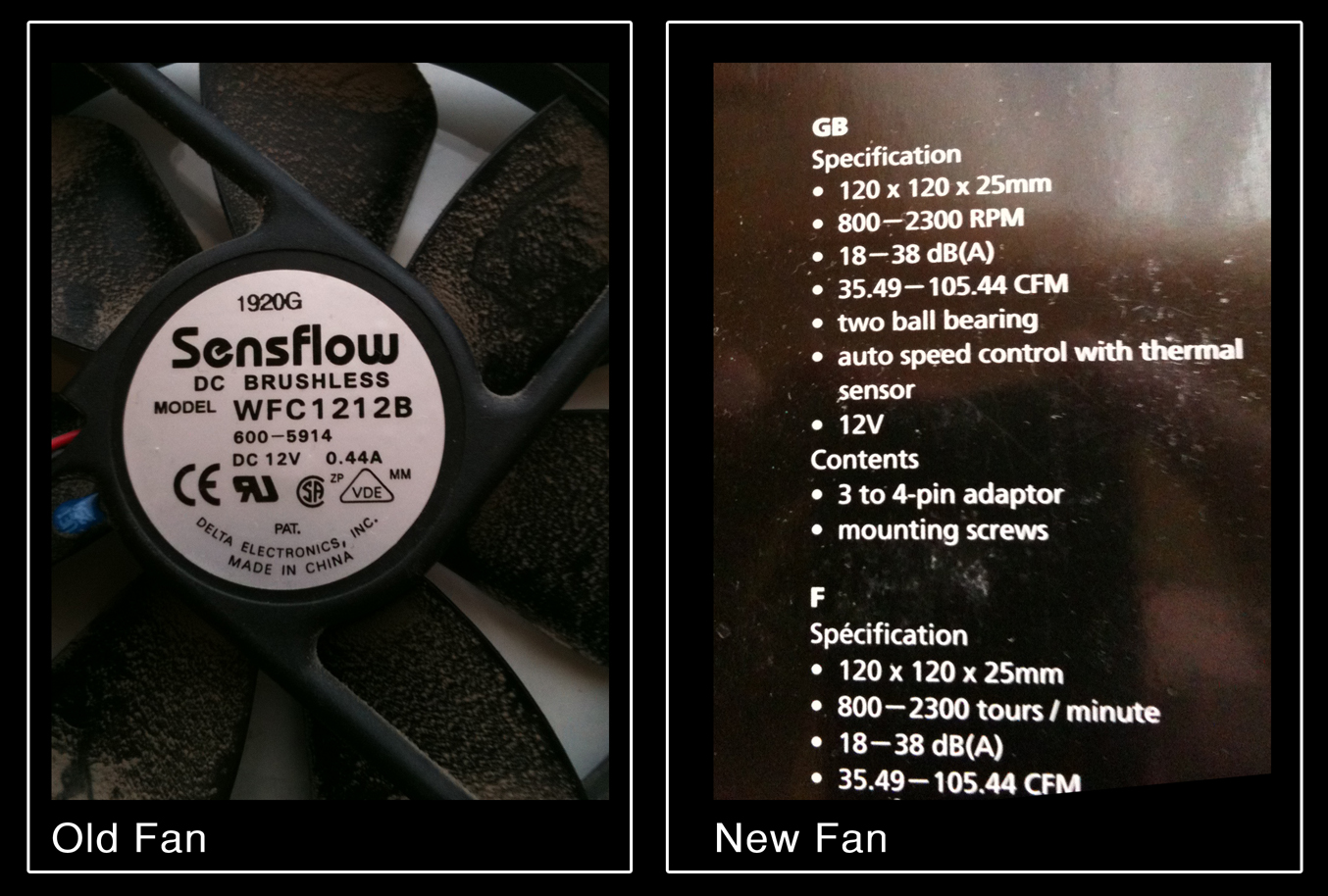

I think the pins are fine, though I am no expert, and the connections are as tight as I can get them to go. If I had a dead fan would it even do the intermittent stutter turn that it's doing?
I replaced a 12V fan with a 12V fan of the same dimensions with (what appears to be) an adequate CFM rating. I am at a loss at this point.

The new fan has an adequate rating though, right? I assumed that since the new fan states 35.49 - 105.44 CFM that I'd be safe. Though I'm beginning to feel like someone that did some reading on a Wikipedia biology page and assumed they'd understand appendix removal.
The fan rating means it starts at 35.49 CFM and moves more air as the the temperature rises, up to 105.44 CFM.
The old fan has a built-in heat sensor too and works the same way, but it tops out at 86.5 CFM.
Like I said in a previous post, I have the same new fan (and it replaced the same old fan) in my G4. It has run very well for two years, and that's with a hot-running processor upgrade and a hot-running video card upgrade.
