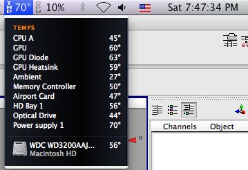

Thank you for that very complete and helpful post!
Yes, as vansouza also suggested, I downloaded smcFanControl and set the fan speeds as you said. There is now a "small noise" of the fans as I write this, so I know it is working. Here are some screens of a 10 minute difference between default-fan-speed and my New-fan-speeds. I guess that it would be better (and cheaper) if the fans got "toasted" instead of some major computer component... What worries me now is that Apple's sleek and elegant design to build computers is starting to interfere with technical aspects of their computers... How is it possible to build a computer so badly ventilated???

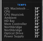

How do these temperatures look
This is how hot mine gets after being on for a while. I'm worried my computer will get messed up, I've noticed the processor has been running at a higher percentage than usual (menu meters) for doing regular tasks.
Any recommended fan speeds for smc or any other advice?

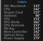

Mine are always low. My 20" might be a fluke, but its coldest Mac I have ever owned. These are in celsius btw...
