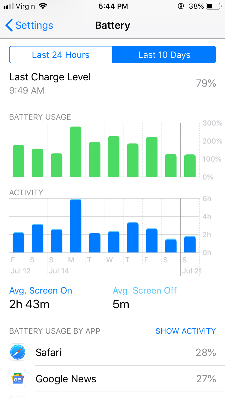

Can you show pics of your battery graph (24hrs, 10 days)?
That sounds like a bad battery. When the battery goes bad, it can have all kinds of arbitrary jumps.
What does coconut battery say about full charge capacity?
You should get a genius bar appointment. This looks weird. And it seems that on many days, you aren't getting anywhere near 2h of SOT on 100% charge. Can you charge the phone overnight (and not use it after midnight), take it off the charger in the morning, use it normally, and then make screenshots when you are around 2%? For the 10-day statistics, additionally tap on the current day and make a screenshot, and there also scroll down to make screenshots of the app %-usages and times.
