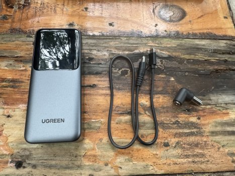

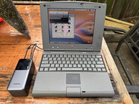

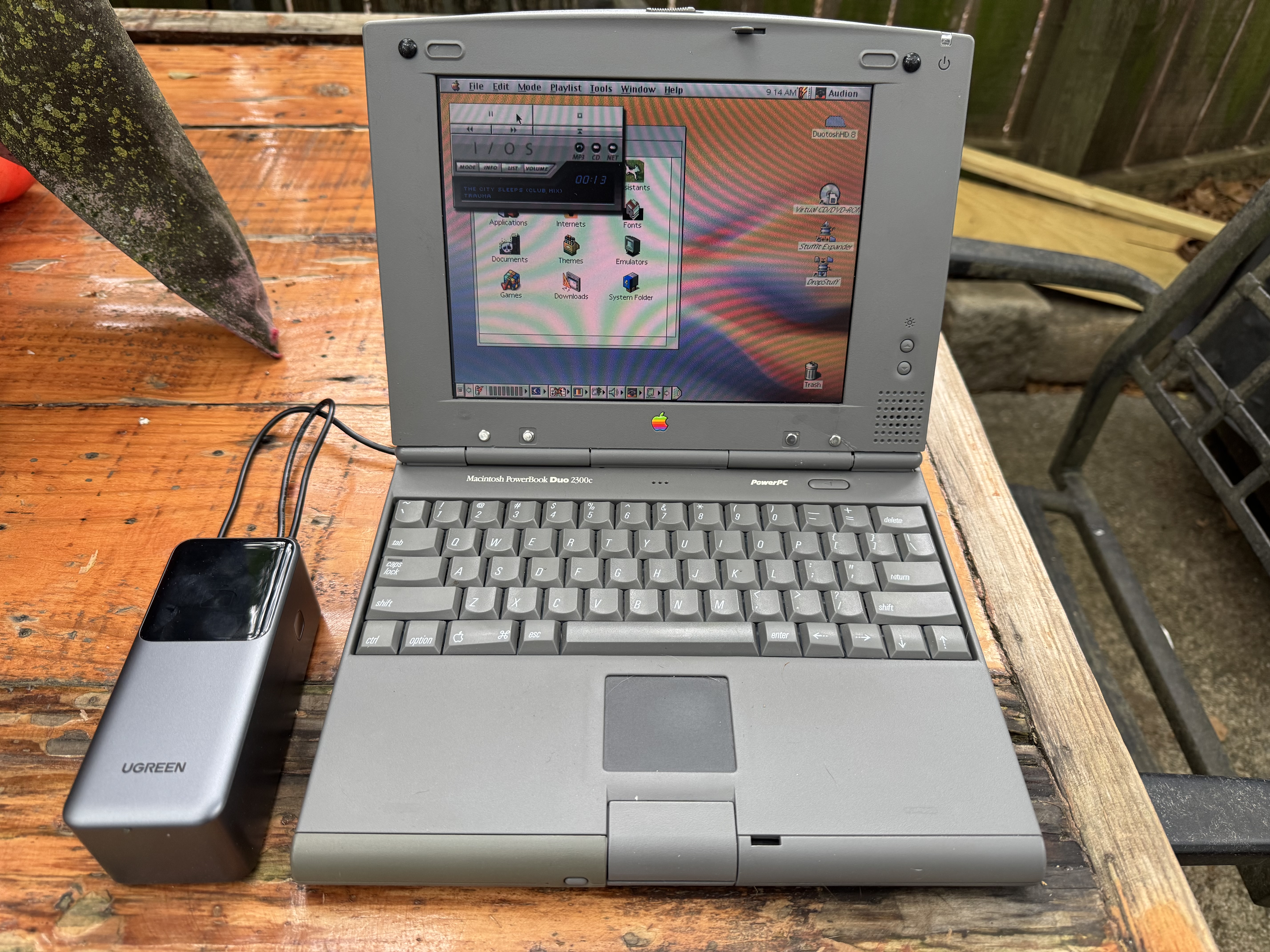

My Maycintosh contribution is powerbank battery power because Powerbooks without batteries kind of suck, and it also solves the lack of MagSafe with my three dogs running around.

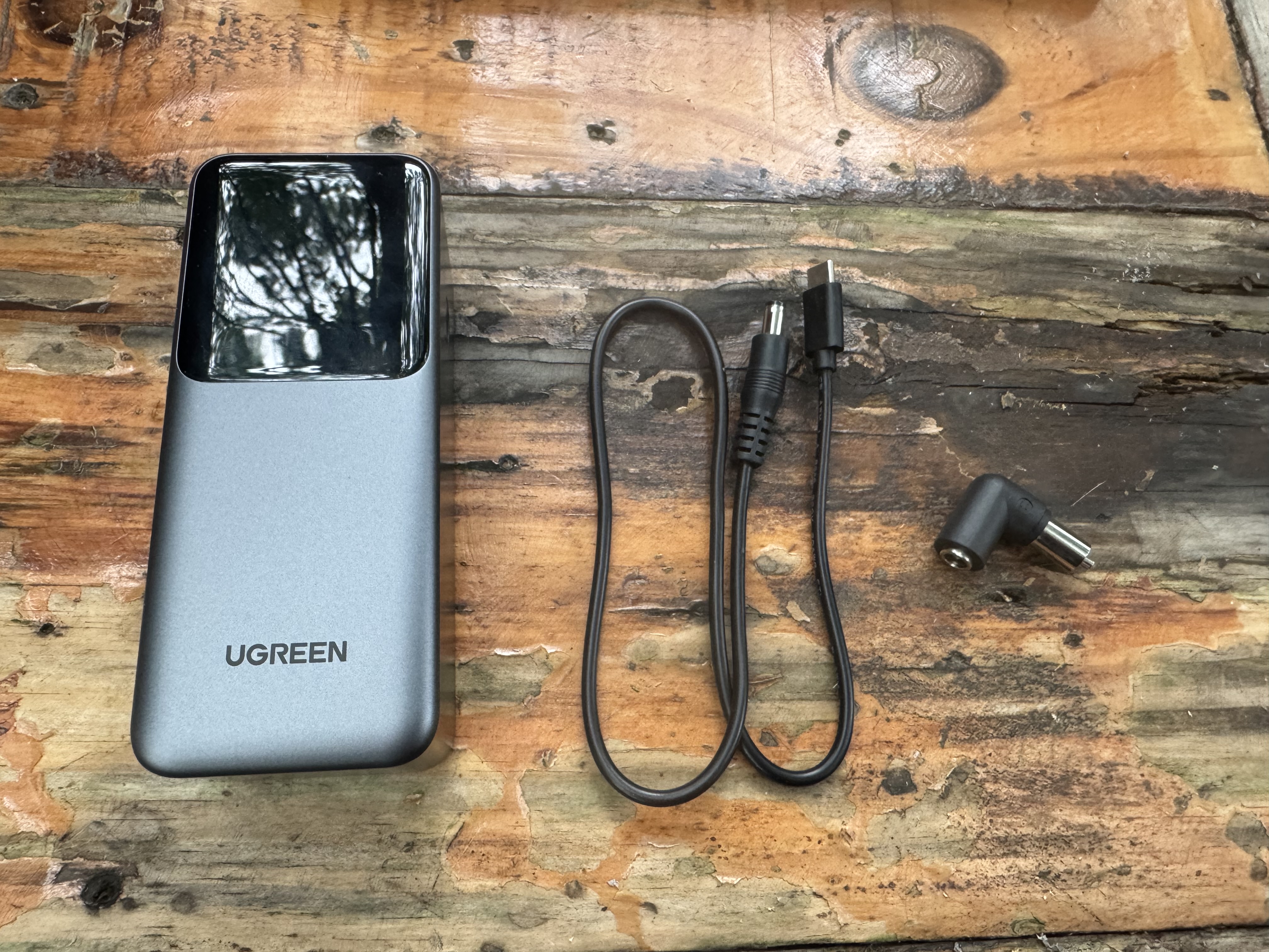

If you’re interested order these two things from Bixpower. This is just for my Duo and 2400C but Bixpower might have plug adapters for other old PowerBooks like the 100s so you’ll have to ask them.
CNT-C11 C11 DC Power Connector for Apple (9.0 x 3.5mm) with 5.5 x 2.5mm Female Jack
1 US$7.95 US$7.95
CAB-UC-20V 20V USB Type C Power Cable with 5.5 x 2.5mm Male Output Connector
Then you need a 100W PD Powerbank. I picked up a 20000k one from Ugreen which is on sale for like $55. You should be good for 5+ hours of use.
USBC is 20V instead of the PowerBook’s normal 24V but I’ve been doing all kinds of things and I don’t think even the 2400c draws enough power for that to matter, it’s not like I’m 3D rendering on these things.
