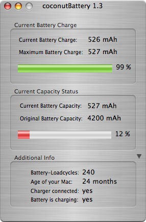

What it's doing now is different. The battery is not charing at all. System Profiler is telling me that the power supply is plugged in, there is a battery present and it's got 0% charged, but it says it's not charging. If I had access to a second battery I'd try that to see if it's my battery or the computer itself, but unfortunately I don't.
Here's a screenshot of what coconut battery says:
notice it says that the charger is connected, but the battery isn't charging.
Weird stuff.
You almost made 500 cycles !!!- I am at 298 on one battery and 45 on my secondary battery. 500 cycles is reasonable. Even with all the batteries smart features, it will still degrade with time. I was guessing that I had only another 100 or so cycles on my primary battery, but it looks like I was way off. There are a couple of possibilities. If the battery is not charging properly the circuitry on the battery will not allow it to charge. Perhaps there is oxide on some of the contacts, try loading and unloading the battery a few times. If the battery is hot, really hot, it shuldn't charge either. If you find a good aftermarket battery, please post a link.
(see above for barrysfarm's image)
Weird stuff.

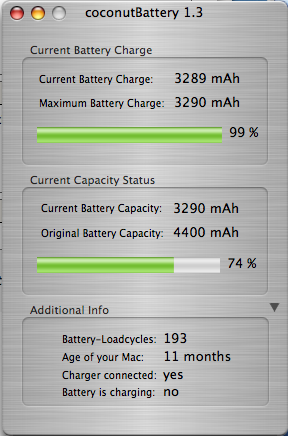

Mine's nothing like as good - 11 months old and down to 74% capacity. And new batteries are > £80 in the UK.
Coconut gives me for 291 cycles, I have 61% (2576 Ah) of an original 4200 Ah, over 19 months. Given this, the average cycle loss for me has been 5.58 Ah per complete cycle.
STEVEP that puts you at a loss of 5.75 Ah per cycle, so given just these two data points, it kind of looks like the avrage loss per cycle is between 5 and 6Ah. Stevep's battery is a 4400, not 4200 though.

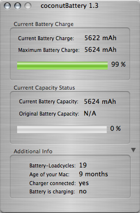

Hmm... Oddness in the coconut battery...
I just ran it and it says my Mac is 8 months old. I got this baby on April 29, so this is 6 months and 5 days old.
I've only had 37 loadcycles in this time, because I go nowhere, but why does it think my baby is older than it is?

Yea, I just noticed the age problem. The battery data seems to be the same as found in the System Profiler. Post your bat stats, just for comparison. Where is the new avatar?

With just 37 cycles, you have lost an average of 1.97 Ah per cycle.
I am beginning to think that this demands a thread of it's own. A battery metrics thread... Humm, perhaps tomorrow.
My second battery has 47 cycles, was a 4400 Ah battery, has a maximum capacity of 4120, so I have lost an avrage of 5.96 Ah per cycle.
[EDIT] Below, OutThere looses an avrage of 6.42 Ah per cycle.
Ugh...I've been mean to my wee iBook...and now it's payback time 🙁 The age is exactly right.
:confused*
Perhaps that's when your Mac was "born", rather than when you received it...?

Looking at Barrysfarm's Coconut report, I'm almost tempted to suggest that maybe not all the pins are connected - Charger connected=yes, Battery is charging=no. ???
