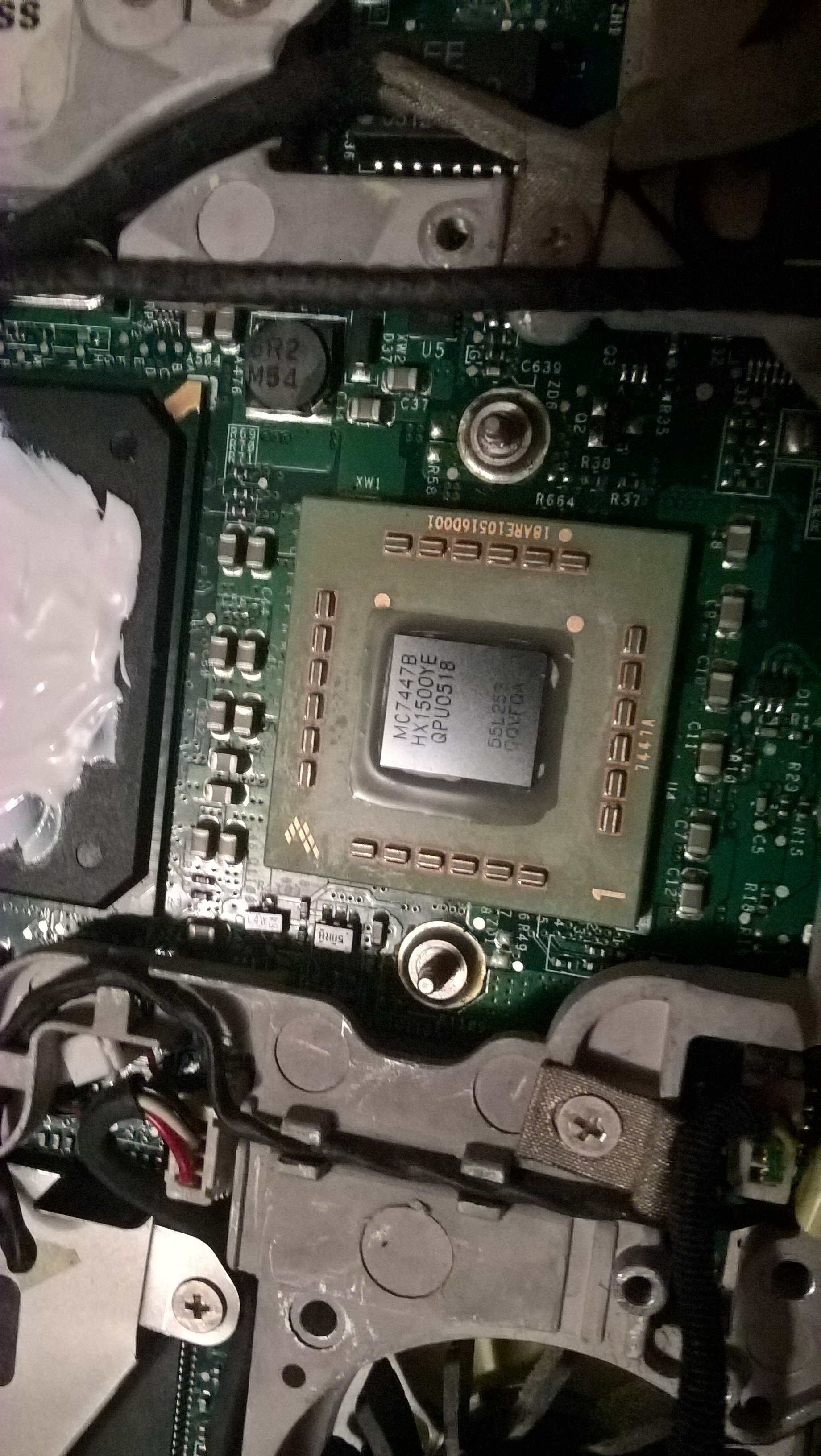

Took it apart again to take a photo.
I just noticed that the bottom of the cpu pcb says 7447a. So which on is it - the metal cap or the pcb?

This is where someone like @dosdude1 or @LightBulbFun could chime in with a definitive answer.
That said, my understanding is the metal cap has precise internal information about the chip within — type, revision, etc. I'd suss that any revisions to the 7447B chip were minor enough to not require fundamental alterations to the semiconductor base (which yes, shows 7447A).
I'm really interested in finding out a bit more about how this little powerbook could have ended up with a 7447b.
