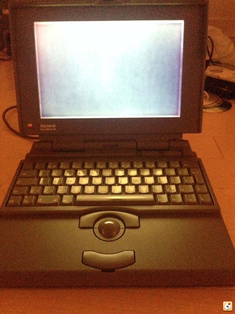

Well it turned on finally! However small problem. Boots to the chime and the screen lights up but nothing comes on. Anybody have any ideas what I should do next?
It may be suffering from the LCD capacitor problem the Powerbook 1XX models with passive screens had. The screen should return to normal after 5-10 minutes of it being on. You may have to fiddle with the brightness/contrast a bit.
Update, played with the brightness and saw the question mark with the disk image. Guess I have to try and find a copy of the os.

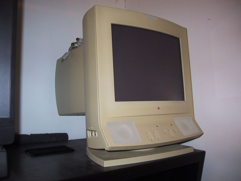

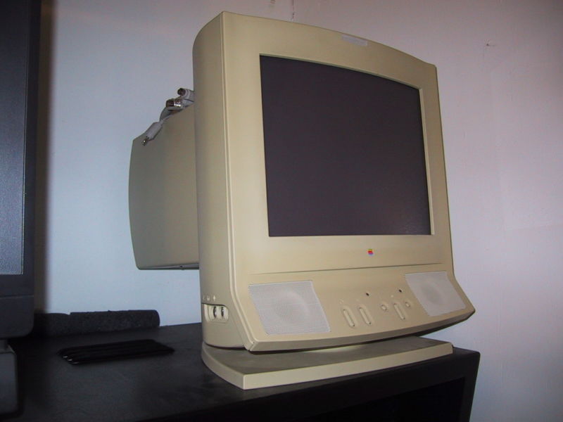

Tries installing the os and the screen kept going off and on and making it essentially a waste. Gonna try again later and with a screen that I am getting for free that the seller had said can be hooked up to this mac. Should have it by this weekend. Here is the screen they guy is giving me.
Tried the screen and some install disks and all the disks get spat out. Screen I got for free doesn't seem to link up to the laptop but the speakers work well. Guess this will just be a cool conversation piece in my place. $10 well spent.

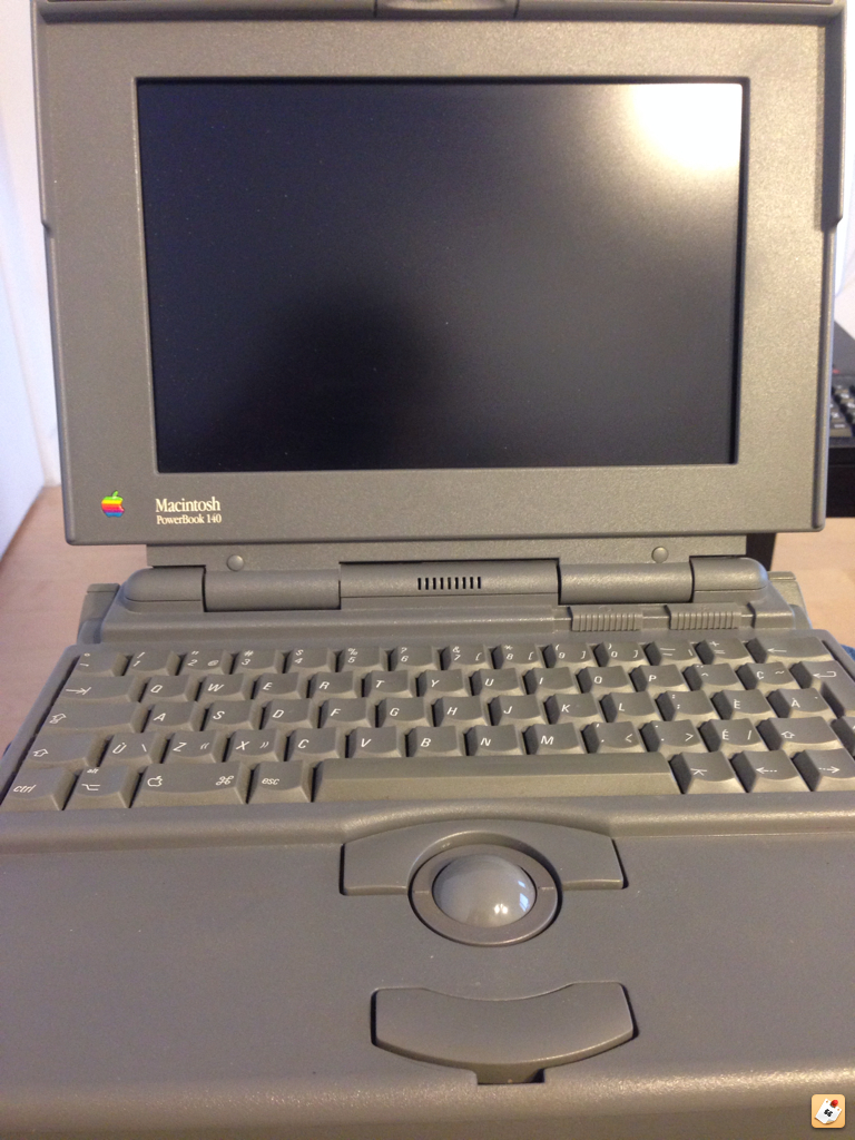

I've got a PB 140 as well and having the same exact problem you are having. Powers up fine to a gray screen, I can move the mouse but nothing displays on the screen. Tried zapping PRAM and resetting power manager. I copied the OS 7 disk tools to a floppy (using these directions: http://lowendmac.com/2008/creating-classic-mac-boot-floppies-in-os-x/ ) and it displays the floppy disk icon on the screen then ejects the floppy every time.
Side note, the resetting power manager instructions always state to remove the battery, however I can't remove the battery. I can get the battery door to slide open a little but can't get the battery out. I don't want to break the door off, so I haven't tried too much more to remove it.
Seems like I'm running out of options. Like you said, still a cool conversation piece ... and a nice addition to my collection!
