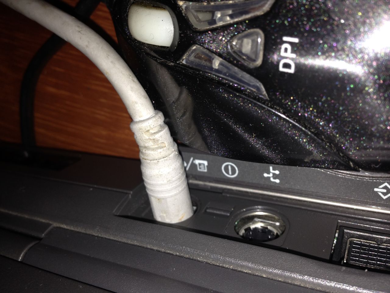

here are the sorts available at powerbook 1400

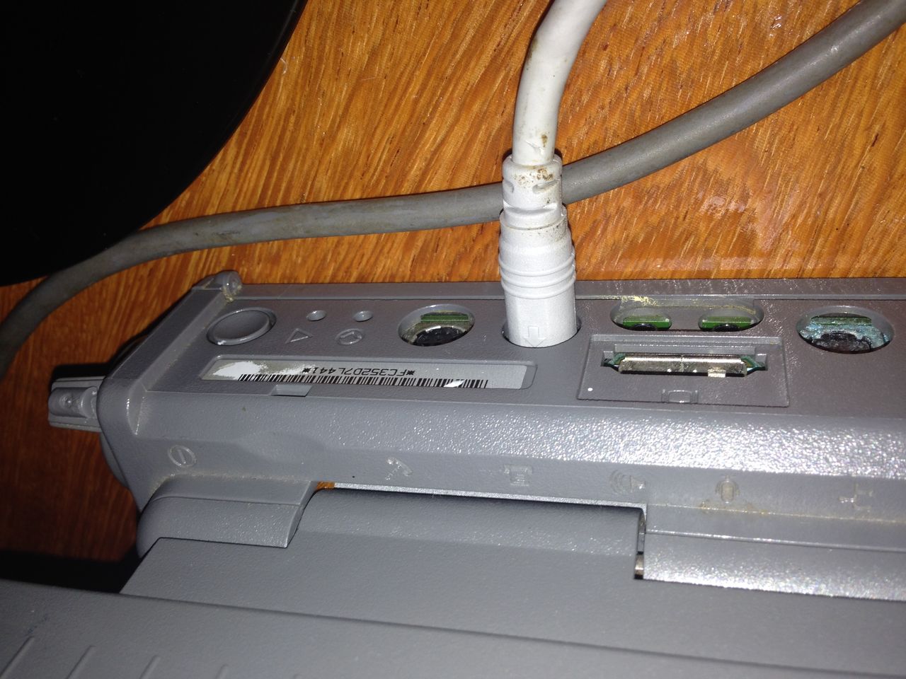

and the ports available at powerbook 180
