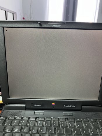

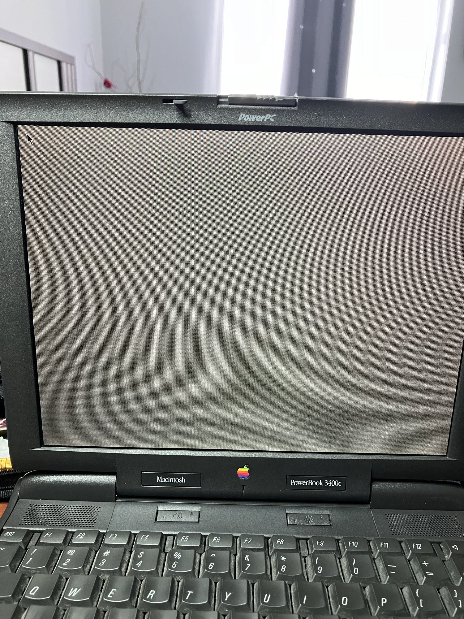

But all I got for several days is a boot chime with the screen you can see in the picture attached.

I am stuck with the image in the picture...that's it..........NOTHING LOADS.

I tried again booting with the external keyboard/moused plugged in and try to zap the PRAM from the PB keyboard and to my surprise, it worked...I zapped the PRAM at least 4 times, then the moment of truth, release the keys....just to be welcome by the same gray screen with the cursor on it as in the picture...
STILL UNRESPONSIVE...SADLY
