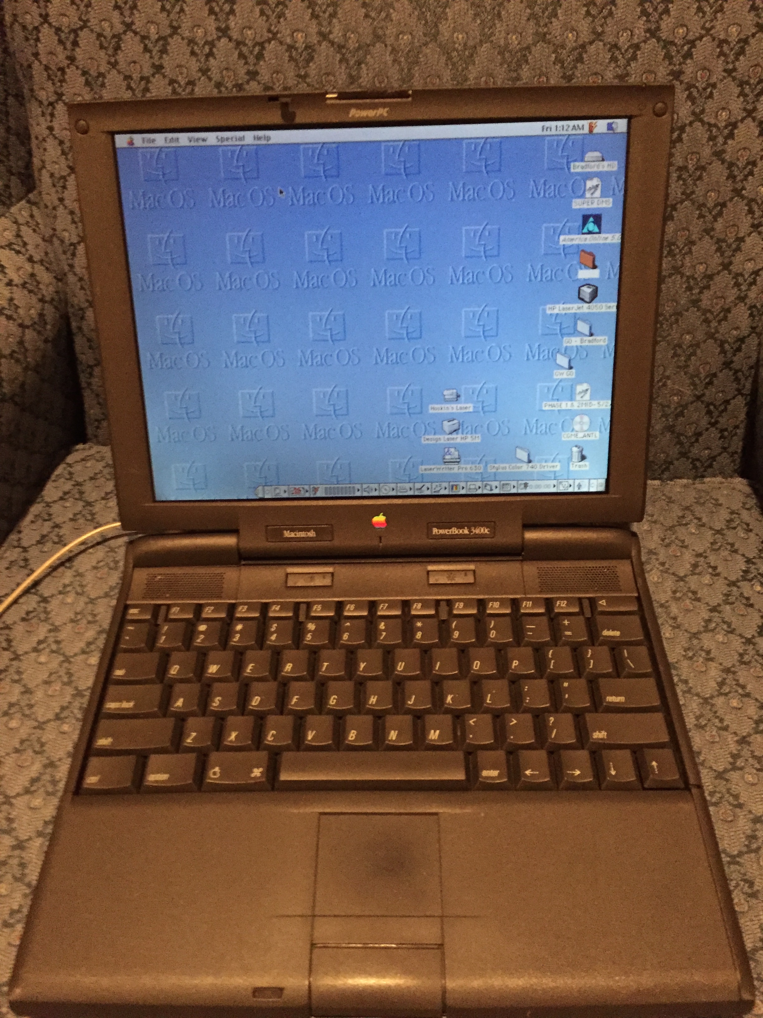

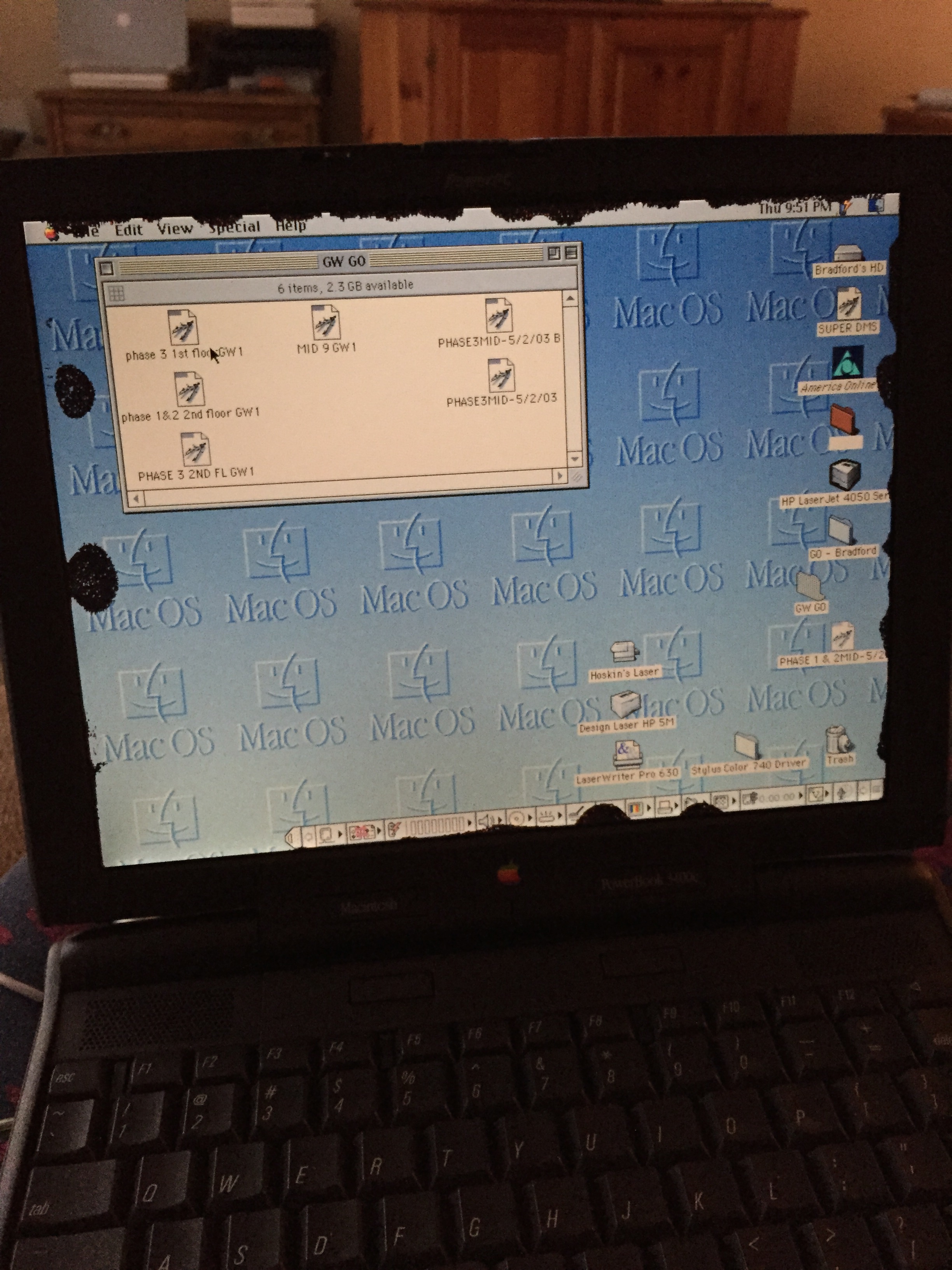

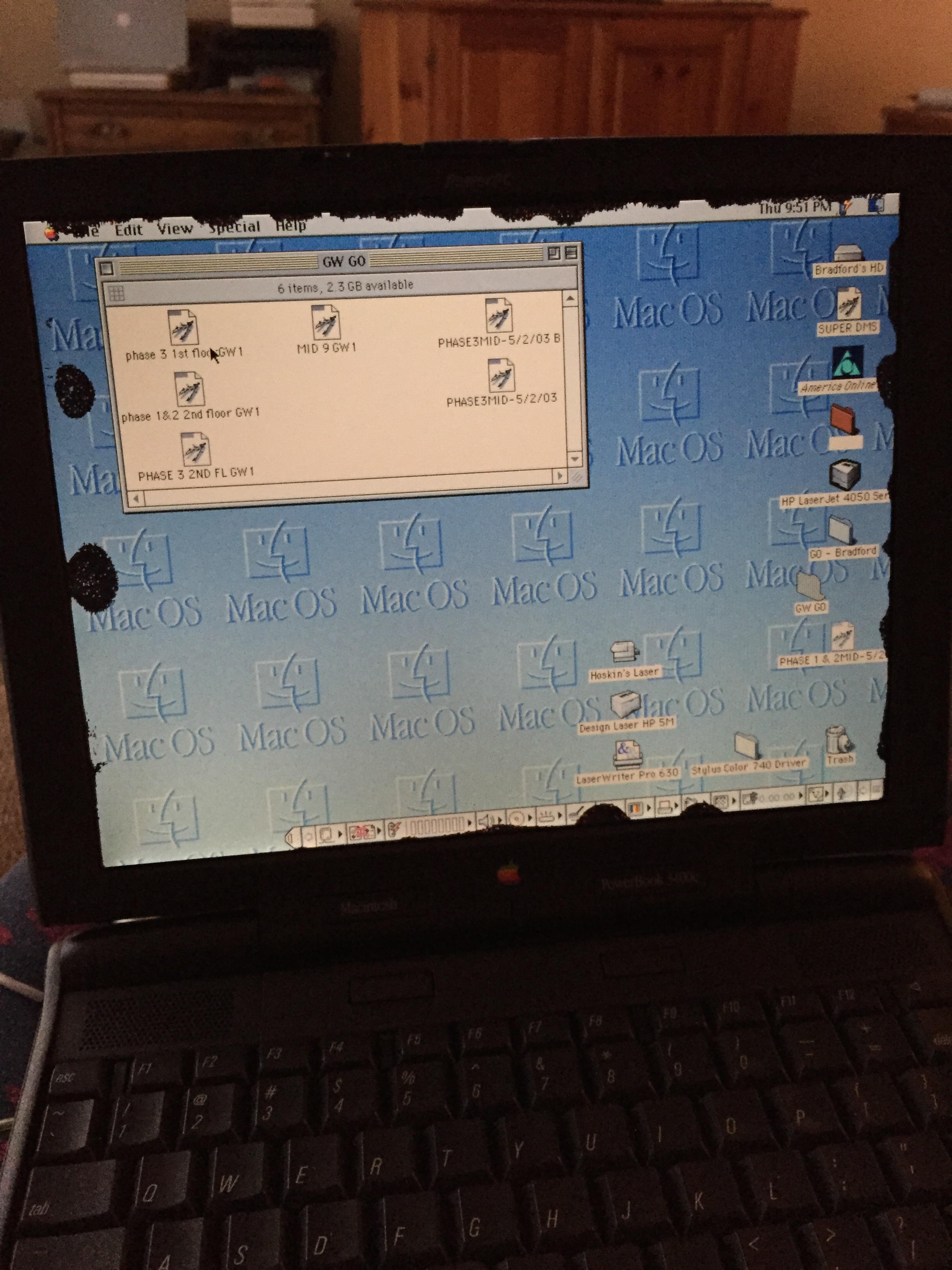

Thought I'd put up a bit more info on this.
After digging into the computer, I found some damage on the board from leaky capacitors.
With that, I went with my original "backup plan" in case this one did arrive DOA(it was advertised as untested/no charger). My other PB had a serious case of dead pixels around the screen, so I just elected to swap the entire panel unit over to my other(otherwise working computer). So, at least I have one good fully functional 3400c out of the lot.
If nothing else, it was nice to go from this
To this
