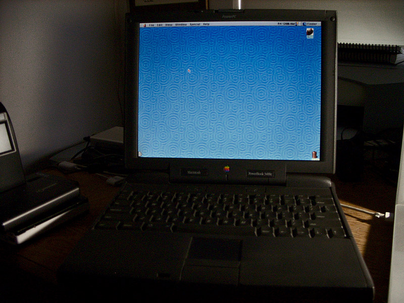

My first laptop, the PowerBook 3400c, is in awesome shape and even has an Orinoco wireless except I am missing the back accessory cover and the selector button doesn't work. I use the tap feature of the trackpad; however, I would like to restore the selector to make the machine collectable. How to fix?

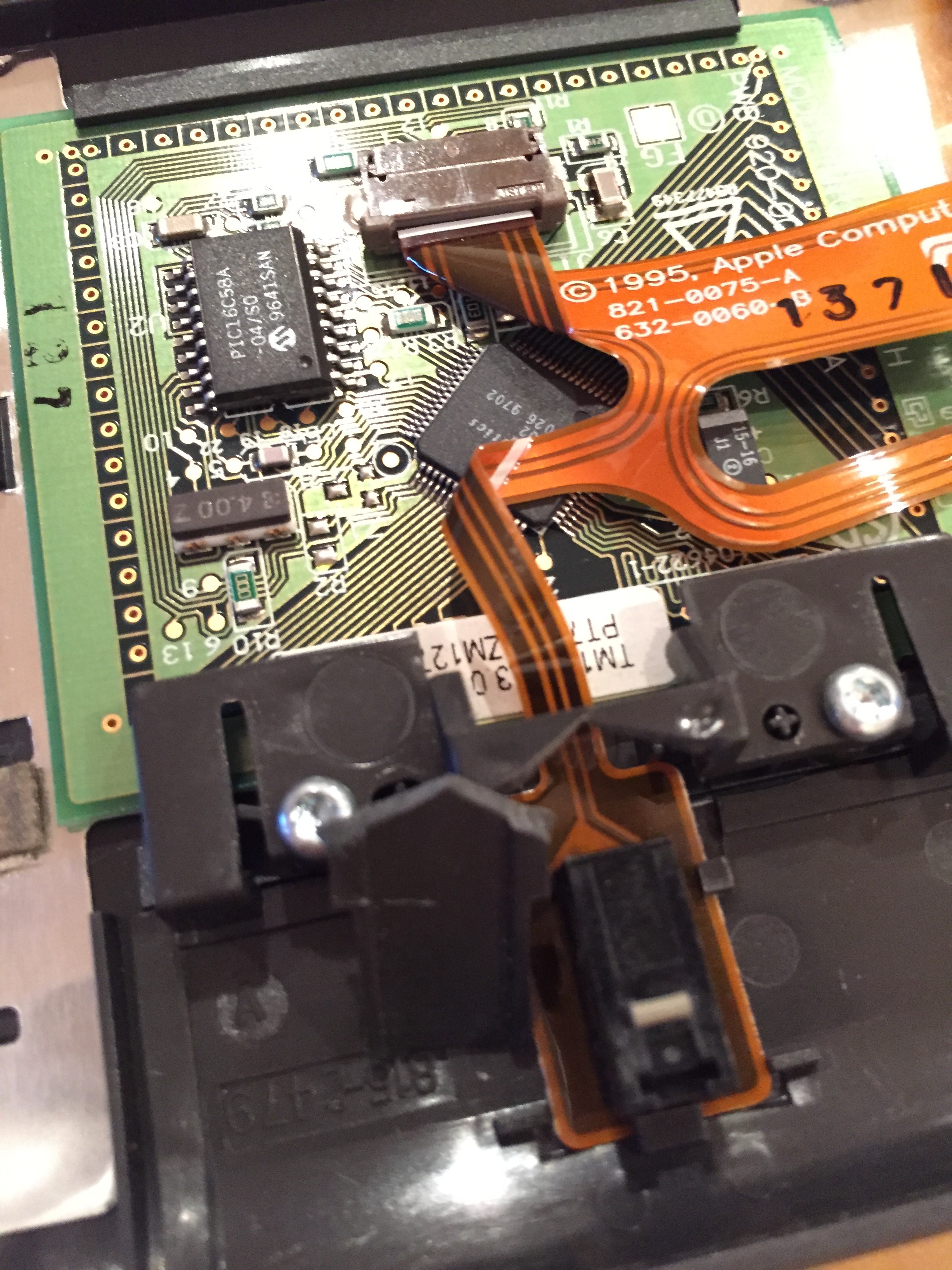

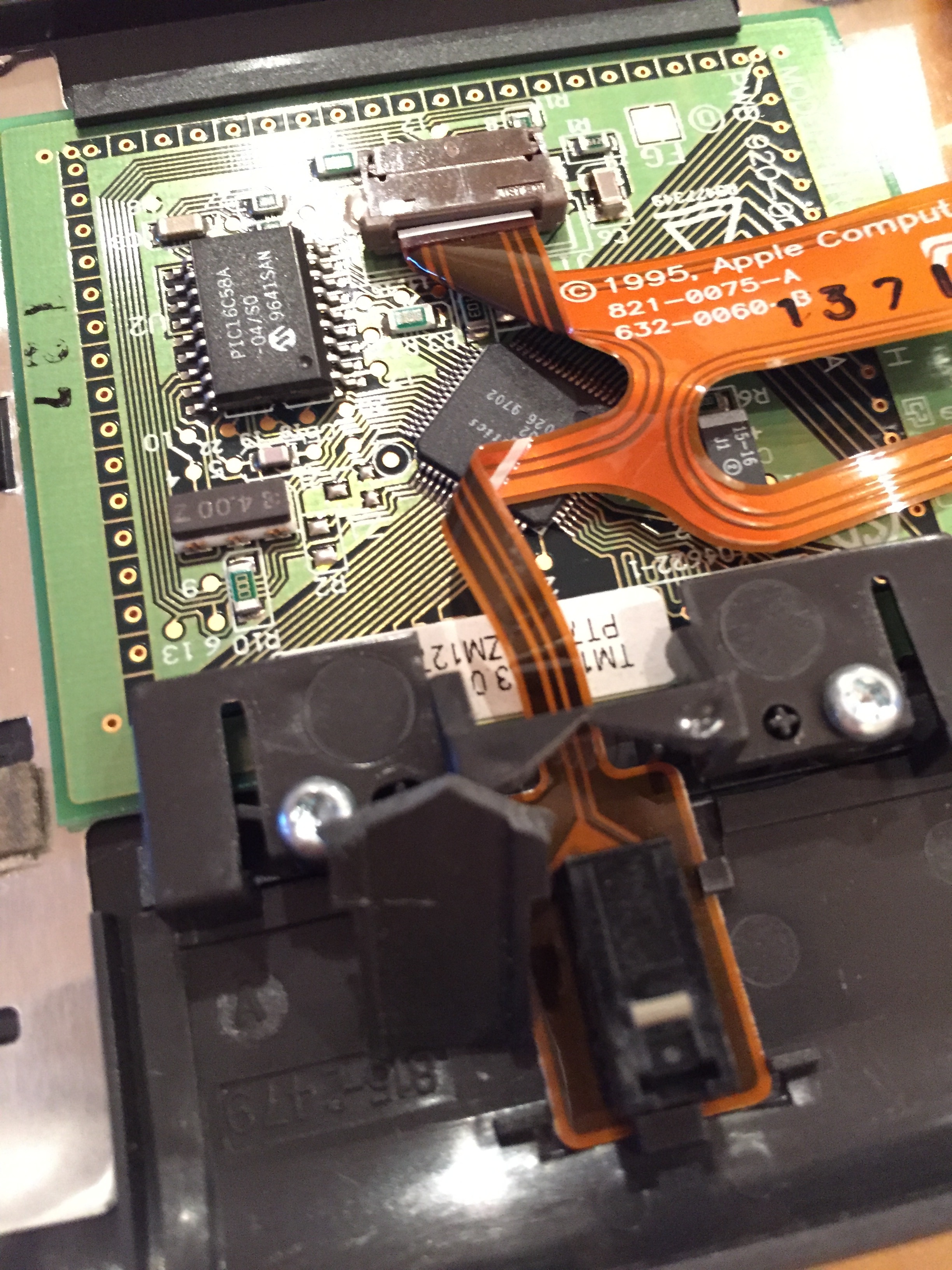

If so, it's actually-from what I understand-it's not super uncommon. I know mine didn't work when I first got it. There is a microswitch attached to the bottom of the button, and it pushes against a piece of plastic to "click." On mine, this piece had broken off-I rebuilt it with superglue and the button now works.
One of the best things you can do is pull off that part of the case and just see what's going on. If you take the keyboard off(take out the three screws on the bottom and you can then lift up the keyboard), you should be able to pop off the trackpad and palmrests as one unit. This is attached to the board by a single ribbon cable, and removing that will allow you to examine it.

Before buying the part, look at what's going on with the one you have now. It may be an easy repair. I used superglue and then followed up by "welding" it with a soldering iron.
I've also seen at least one picture on the internet of someone who made a replacement out of aluminum.

BTW, here's a photo of mine before repair. Notice the broken piece of plastic lying NEXT to the microswitch.

Really nice 3400c though, I'm jealous! :p
