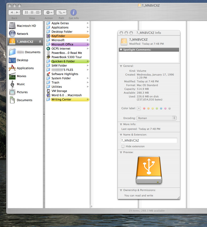

I have been asked to look at a non working Powerbook 5300cs to see what if anything can be done with it. I have removed the 500MB HD and connected it to a G5 iMac using a IDE to USB adapter. The drive powers up and mounts, however it hangs when any of the folders are selected.
My question is should this work like any other USB drive in Finder or is there a better way? I would like to be able to grab a few files off of it, then securely erase it. However when I try to copy a file or open a folder, Finder hangs.
I think it has system 7 installed from 95-96, but I'm not sure, see pic.
Thanks

I get an error when I try to verify the disk with Disk Utility, says the disk can not be unmounted, somethings not right.
If it was running System 7.5.3(?) which it came with,it isn't formatted for/doesn't support HFS+. Maybe that's your problem?

The disk is in HFS which is supported by OS 7. It also is supported in X.

Did you try changing the name of the drive to something different. The '?' or something may be causing problems. Probably not the real issue, but it is worth a shot.
The name looked odd to me too, but this is the first time I have used anything pre-OSX.
Tried to erase it with Disk Utility, but it just hangs and gives the same error.
