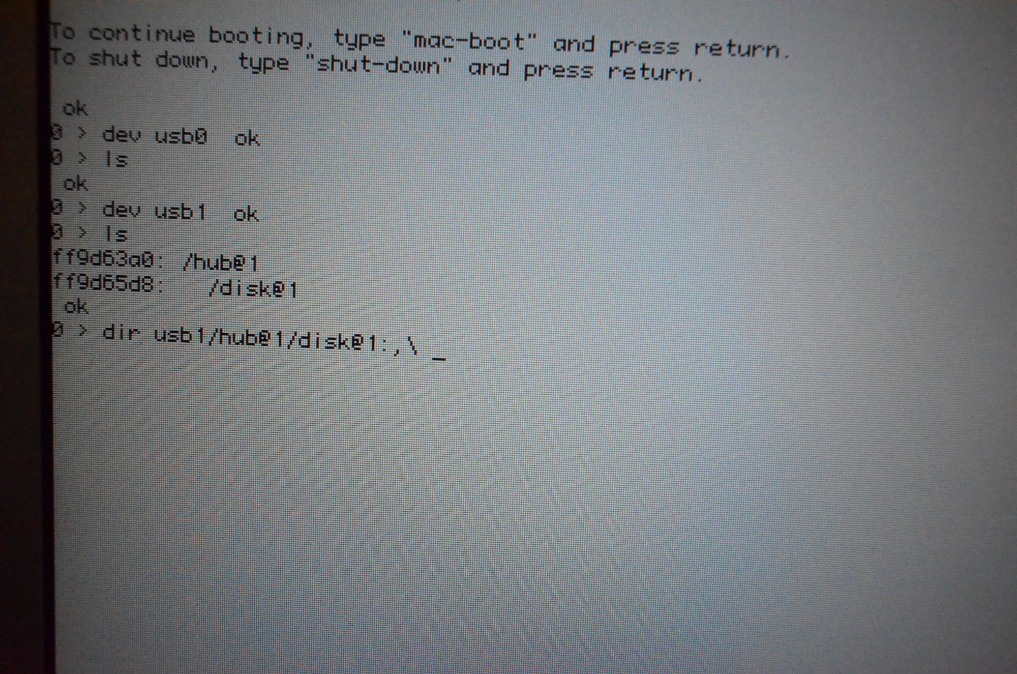

So i don't know what is happening on this machine
I got PB G4 17 A1052 with openfirmware 4.8.6
I can't get this machine to boot from usb stick.
several stick i tried.
The strange the same stick boots fine in a A1138 Powerbook
The stick is shown in openfirmware
dev usb1 ok
ls
ff9d64d8: /disk@1
But when i try to boot with
boot usb1/disk@1:,\\yaboot
nothing happens i wait 10 minutes nothing
even
dir usb1/disk@1:,\
the system hang and shows nothing...

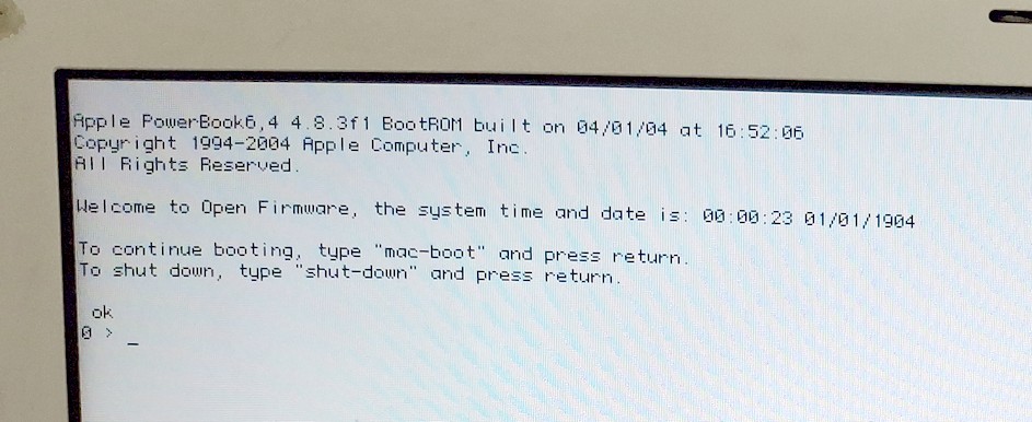

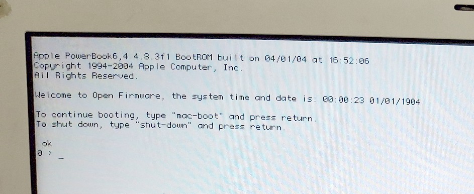

I just checked the OF version on my 2004 Alu PBook, it's on 4.8.3f1 (see pic below), so before automatic usb boot support was apparently removed. Yet never got any "automatic" boot, gotta enter OF and then type the proper command to boot from usb.
Having said that, the boot picker does show the usb as a bootable object, so that's another (simpler) way to boot from usb, however in my case i've coded a simple script that allows me to choose which OS I want to reboot next and from which source, including from usb. ( well, actually that was working great with yaboot, before I installed Void Linux which brought grub with it, need to work on how to have the script deal with grub, if that's possible at all, not really sure from what I've read :-/ ).

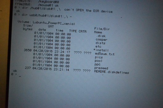

Hi all i think i try now following :
sudo dd if=lubuntu-16.04-desktop-powerpc.iso of=/dev/sdf bs=1M status=progress
i test this in my A1138 machine
And this "crazy" 🙂 A1052
Hangs... nothing ..... 🙁

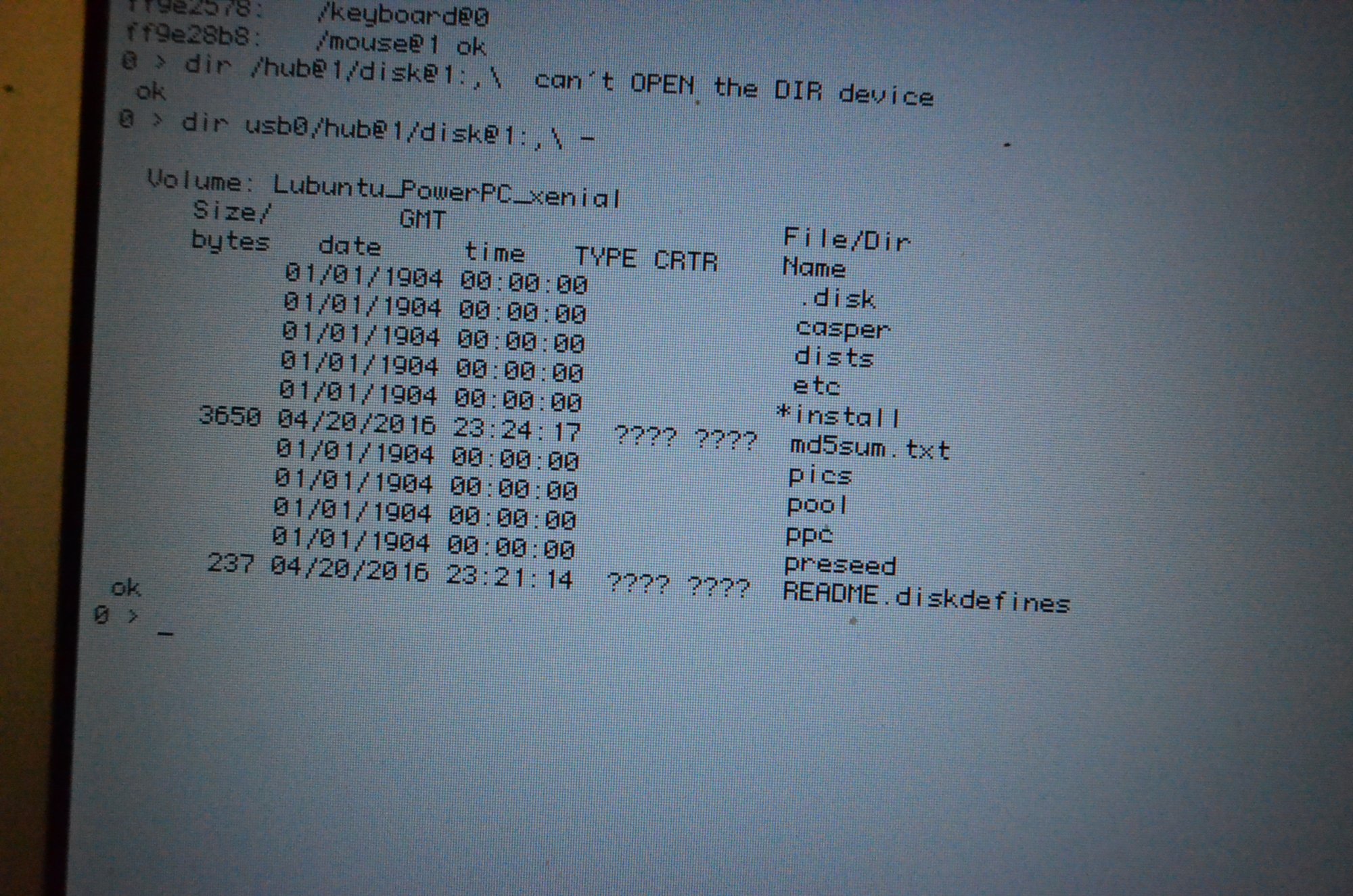

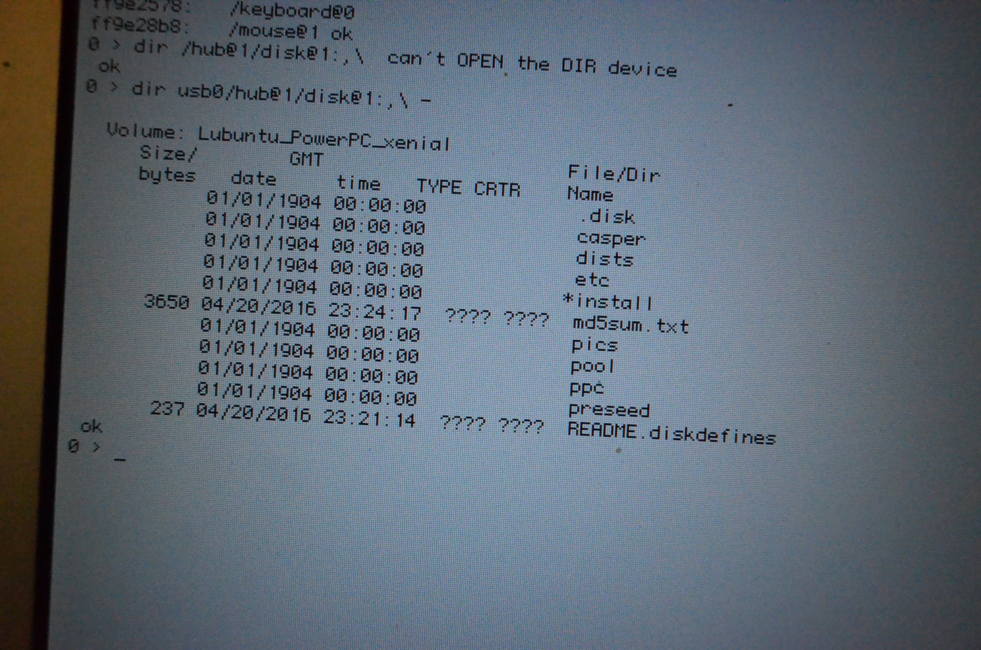

So my A1138
The * next to install means that it is the blessed system folder.
That means the following commands should show the contents of the install folder?
Code:
dir usb0/hub@1/disk@1:,\install
dir usb0/hub@1/disk@1:,\\
dir usb0/@1/@1:,\\

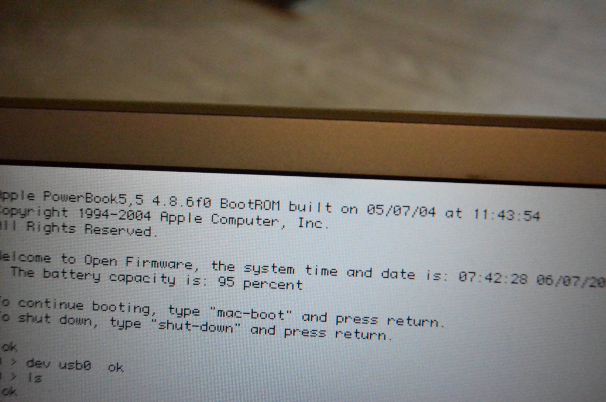

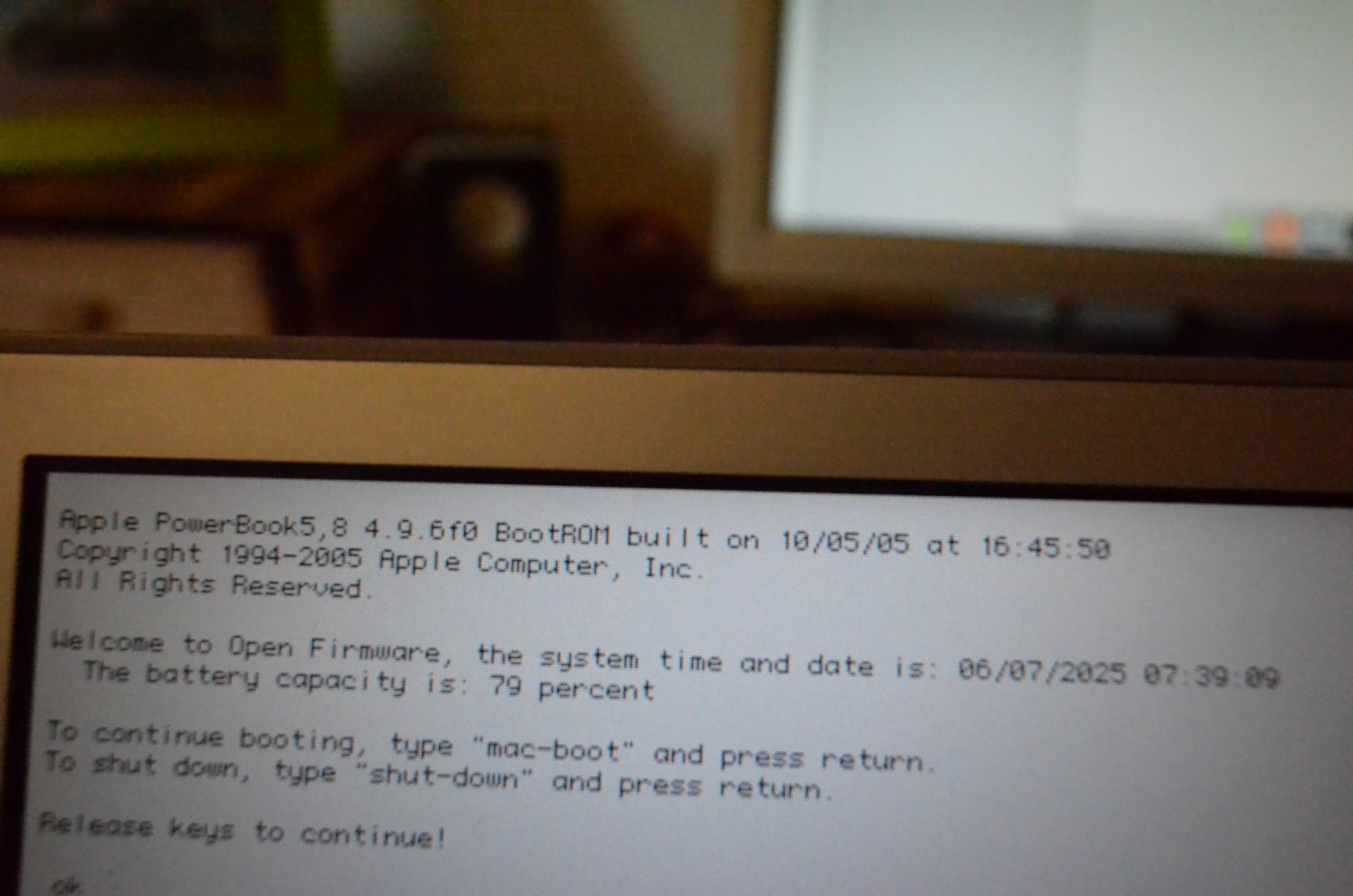

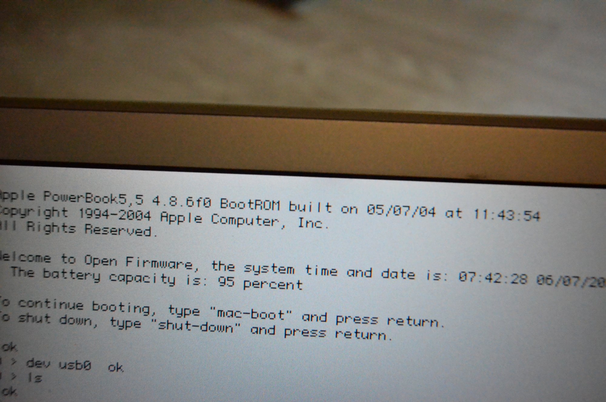

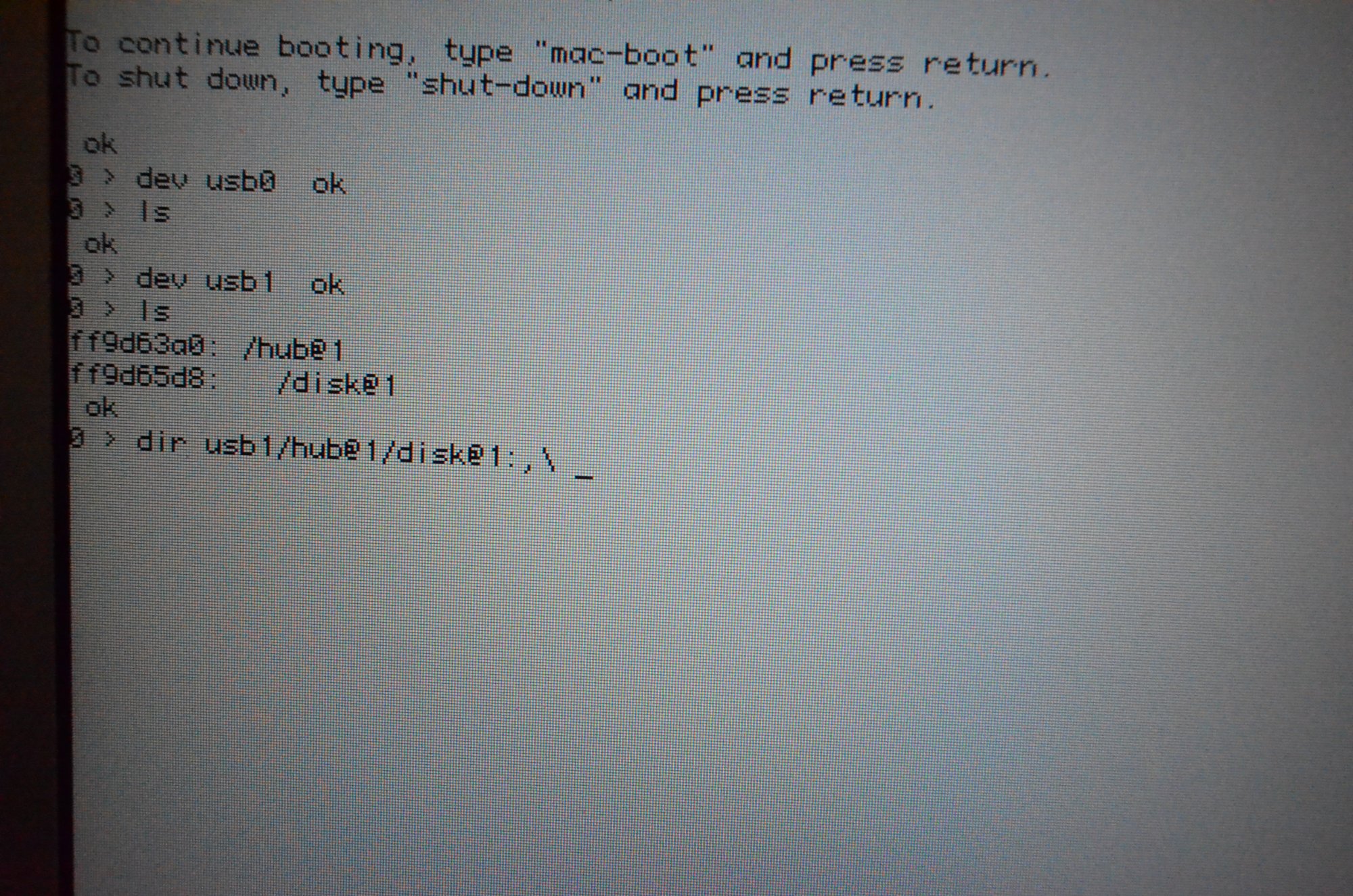

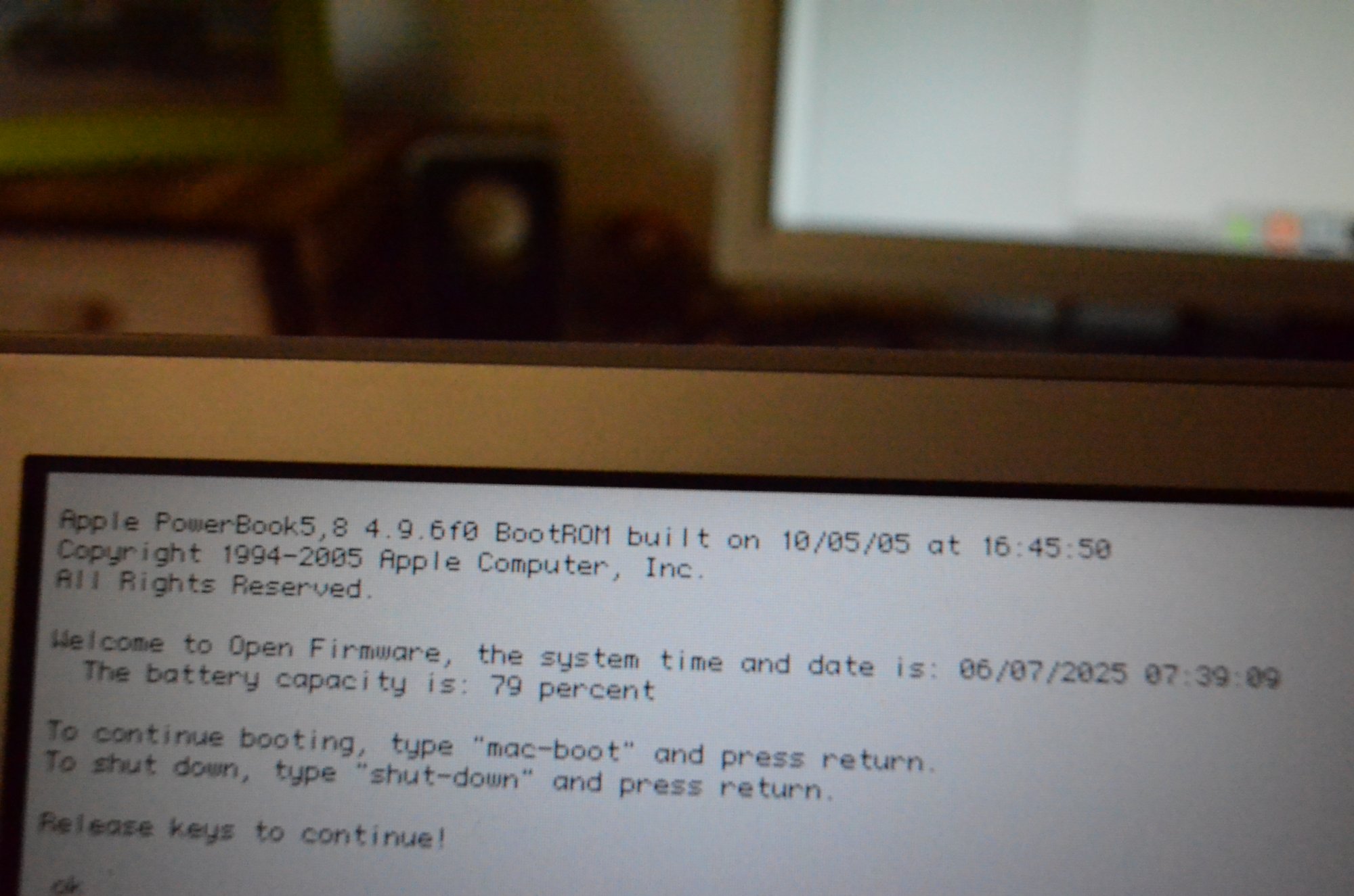

Maybe 4.9.6f0 is better at doing USB than 4.8.6f0...
I don't have the 4.8.6f0 ROM to compare to see if there's any important USB related differences.
I don't understand how some PowerBook5,8 have 4.9.5f3 09/22/05 instead of 4.9.6f0 10/05/05. I guess Apple updated the firmware without making a firmware updater? I wonder if your ROM has a different model revision number in the config block of the ROM. The PowerBook5,8 4.9.5f3 09/22/05 ROM that I have has revision number 01.
A ROM dump for both of these would be interesting. Then I can compare the USB code.
EveryMac.com says A1052 is for PowerBook5,3. It says PowerBook5,5 is A1085.
https://everymac.com/systems/apple/powerbook_g4/index-powerbook-g4.html
PowerBook G4 1.33 17" (Al) 1.33 GHz PowerPC 7447 (G4)
Model A1052
ID PowerBook5,3
PowerBook G4 1.5 17" (Al) 1.5 GHz PowerPC 7447a (G4)
Model A1085 (EMC 1983A)
ID PowerBook5,5
Does the PowerBook5,8 and the PowerBook5,5 have the same USB controller? Output from dump-device-tree would show that. Use telnet in Open Firmware to capture the output to a text file instead of using photos.
Okay this is strange so somebody put a a1085 Mainboard in a A1052 case. 🙂
