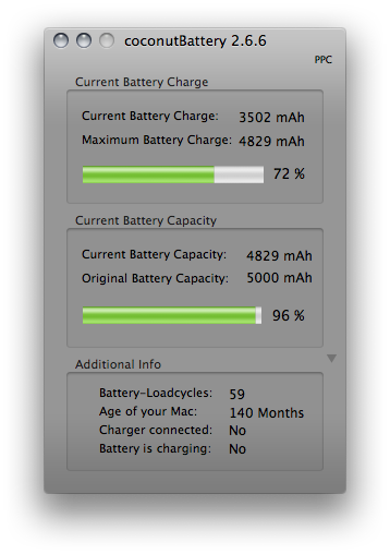

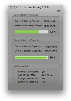

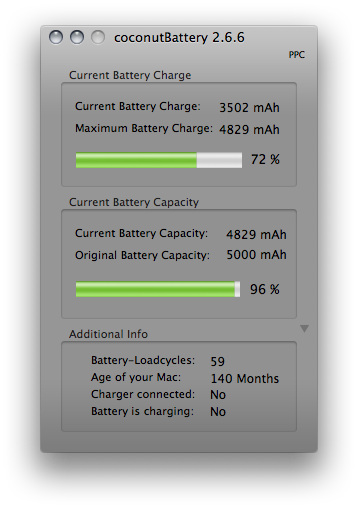

I recently came across a 1GHz 15" AlBook for the low low price of free, and to my surprise, the battery lasts several hours and CoconutBattery shows its health at 96%! 😀
EDIT: Apparently the former owner put in a Newertech battery!

Are there any PowerBook g4 batteries with more than 5000mAh? I could not find any, although I did not look very far.
They may report more but I bet my bottom bippy you won't see anything like the expected battery life, stability or longevity of a genuine OEM battery. I have learnt to lower my expectations.
Newertech batteries are generally as good as OEM batteries in terms of life, although you pay for that.
