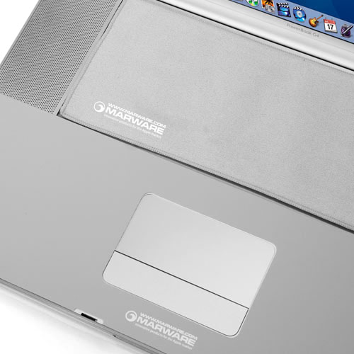

i don't have this problem yet (well, my pb is only 4 months old), but i probably wont because 95% of the time i am using it at my desk with my apple keyboard + mighty mouse, and a radtech screen saver thing over the powerbooks keys.
i did however come across a solution for this problem. check here:
http://www.marware.com/cgi-bin/WebObjects/Marware.woa/5/wa/selectedCategory?catalogCatID=181&wosid=QM74xtR2Rq3gTetbonIwPg
it has pads that go over the palm rests, and look alot better then a pda screen protector imo.

i just ordered up that protector from marware. well worth it for me. i have really sweaty hands most of the time (yeah i know, gross) and my palm rests have started pitting after just a few months. same happened to my Rev A 12" PB. this time around i'd like to stop it before it gets bad as it will make a huge difference when i want to sell this thing eventually.
post a review once you get it, i am interested to hear how nice looks and feels.
will do. in the past i was turned off by these kinds of accessories as i tried some of those leather keyboard covers on my old TiBook and it wound up doing more harm than good. but with my cycle of selling machines after 1 year of use it would be best to keep them in good shape. i probably won't use the keyboard cover as it's not really needed in the AlBooks and i don't trust anything in that tight spot. but the palm rests need some protection for sure. an alternative that a friend of mine uses is the screen protector stickers for a PDA. slaps one on each side. they peel off without doing any damage or leaving glue.
