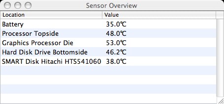

From Temperature Monitor, the result in temp.jpg, processor is 47 centigrade, is that ok?

yes, indeed the graphic processor has the highest temperature, 52 C.
