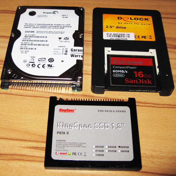

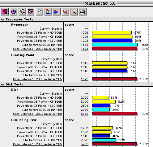

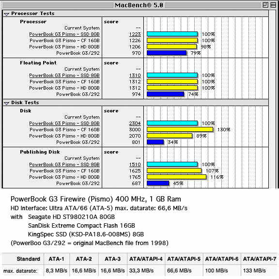

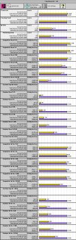

I‘ve compared Harddisk, Compact Flash and SSD in two different PowerBooks G3.
First (pic 1+2)
PowerBook G3 Firewire (Pismo) 400 MHz, 1 GB Ram (ATA-5 HD interface)
with 3 data-storages, which still are available at this time at almost the same price:
Seagate HD ST980210A 80GB
SanDisk Extreme Compact Flash 16GB
KingSpec SSD (KSD-PA18.6-008MS) 8GB

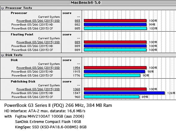

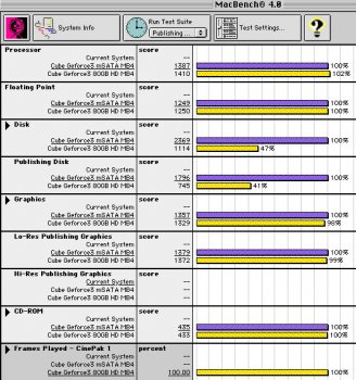

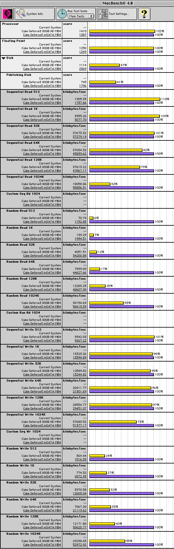

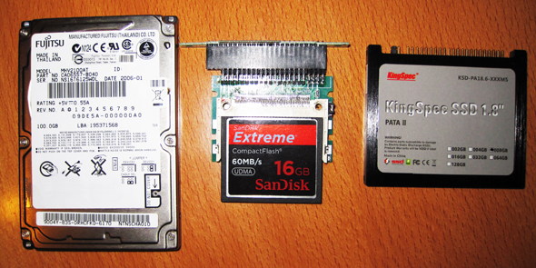

The second test (pic 3+4) is different, because of the ATA interface:
PowerBook G3 Series II (PDQ) 266 MHz, 384 MB Ram (ATA-2 HD interface)
Same CF and SSD but older harddisk from 2006: Fujitsu MHV2100AT 100GB
FYI, Mike 🙂
Thanks for posting this.
I'm actually fairly surprised to see the CF do as well as it did-I had always expected SSDs to outperform them.
I do, however, remain concerned about the long-term viability of them for a system drive. I've also been concerned about the cost/gb, especially considering how inexpensive mSATA drives (which can readily be fitted in 44 pin IDE enclosure) are these days.
I was surprised too. 🙂
But I only tested a single SSD, maybe there are other SSDs which outperform the KingSpec...

The Kingspec SSD, inside, it is just a CF card with a nice enclosure. I have a SSD like that, and it's a Compact Flash controller.

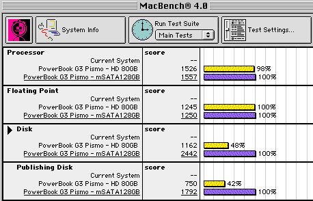

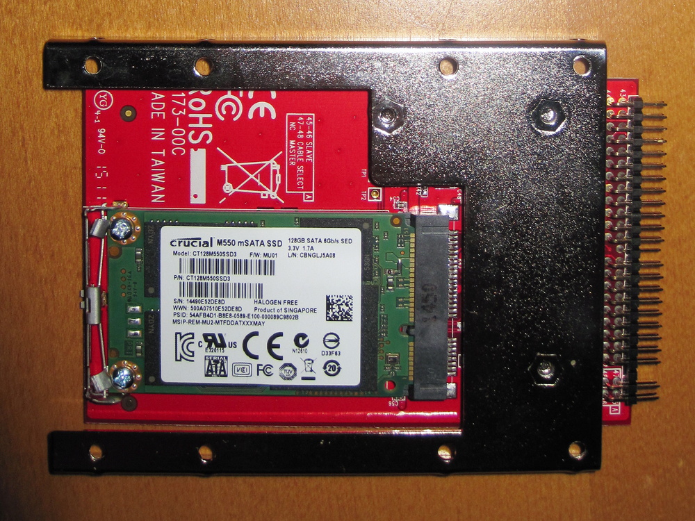

OK, new Test 🙂
PowerBook G3 Firewire (Pismo) 500MHz with
Crucial CT128M550 mSATA SSD 128GB with Delock 62495 adapter

Any chance of separate Read & Write benchmarks on those two?
Since the Seagate is only a 5400RPM, I'm not too surprised, but it's certainly an improvement!
Are you able to do a direct compare to the CF you used earlier? The "Scores" don't seem consistent.
Thanks for posting! 🙂
I used different Versions of MacBench: their data files are different, MacBench 4 files cannot be read nor converted (!) by MacBench 5.
Sorry, the CF is already in use in a different PowerBook.
The Seagate is slow NOS but completly silent. Until now I thought it was quick enough. 🙂

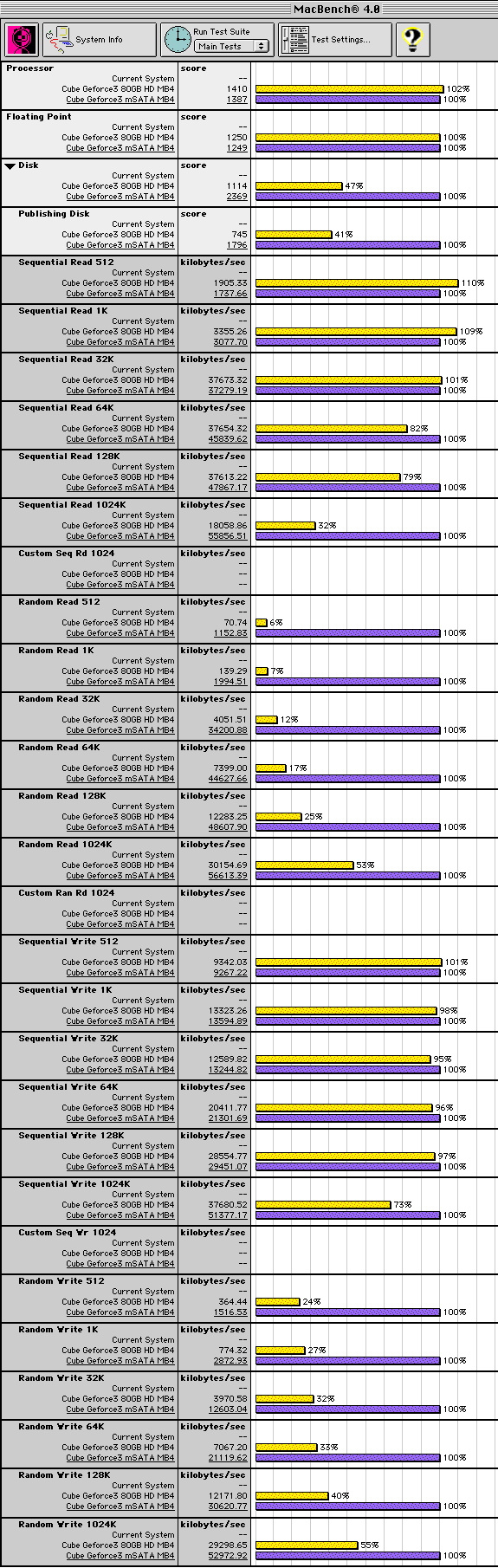

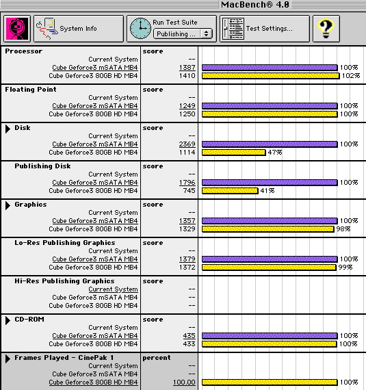

Here are the missing tests.
The Crucial CT128M550SSD3 128GB mSATA SSD is now in my Cube, as a a Cube doesn't like hot items.
It replaced a good known Seagate HD ST980210A 80GB 2.5" 5.400, which also fits two of my Pismos.
Pismo G3 400MHz and Cube G4 450MHz are fitted with their slow ATA-5 HD Interface.
Reactions: MacTech68
Thanks for that. It certainly does make a difference. Interesting to note that on small reads and writes, performance appears to have saturated the ATA5, but larger read/writes obviously benefit from the vastly improved (or non-existent) seek times of the SSD.
