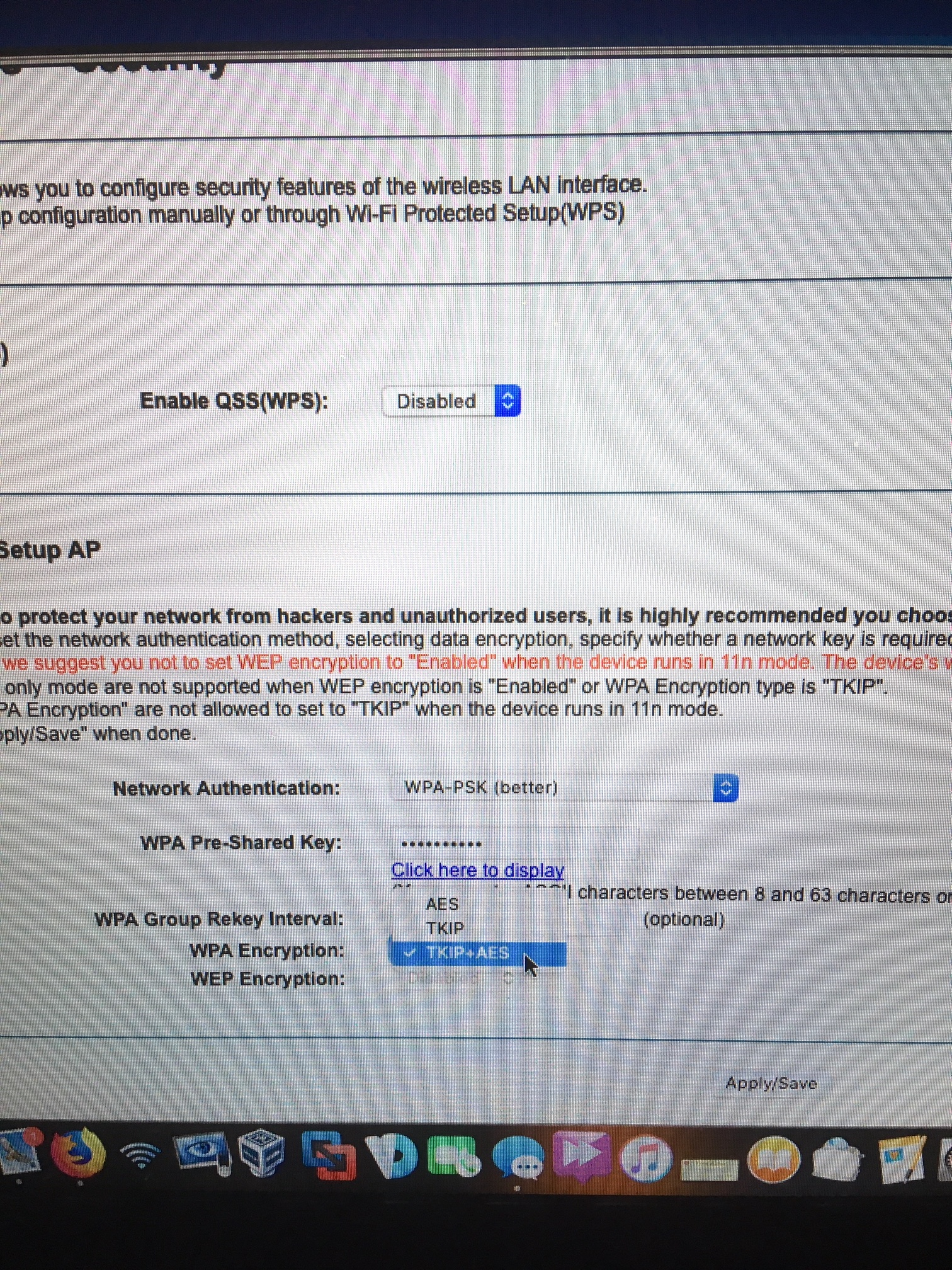

On our TP-Link TD-W8960NB router I set encryption to AES + TKIP to be on the safe side, but still couldn't get the Airport to connect to WPA2. So no it wasn't automatically switched in my case.

I guess what I am asking is, with B+G mode only and using WPA (and not WPA2) do you have the ability to switch back and forth between AES and TKIP?
Yes I can - either AES or TKIP, or both -
