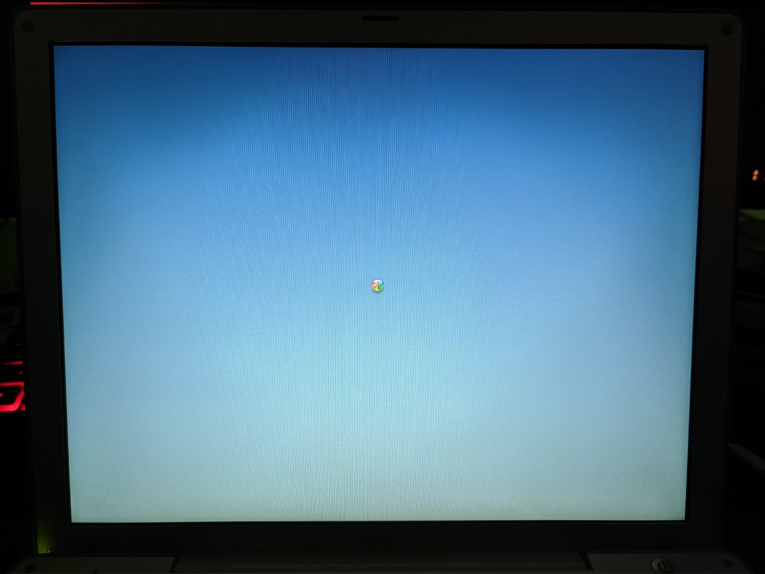

I want to install Mac OS X 10.3.7 on a PowerBook G4 12" 1.5Ghz, it runs from the DVD disc, I formated the drive and install, after 1 min of installing I receive a blue screen and a circle that loading, why is not going further?

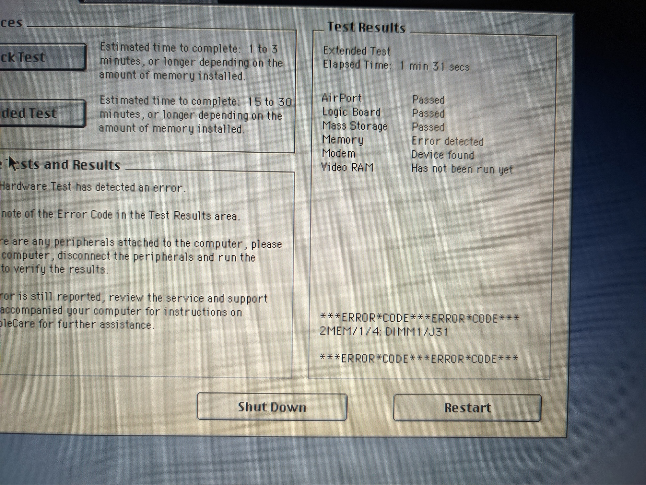

Also, I test on Apple Hardware Test, and it gives me an error on Memory, here can be the issue of loading the installing?

Mmmm.... looks like your G4 has Dead Bottom Slot Syndrome. Try removing the DIMM from your RAM slot and see how far that'll take you.
It could also be the DIMM itself; try a different one as well.
Reactions: ExclusiveMac
Aluminum PowerBook G4s can be susceptible to a problem where the lower RAM slot (the one closest to the logic board) will malfunction, making it unusable. It's most common on 15" models, but the other two models (afaik) can be susceptible to the problem as well. As the 12" models have only one slot, it's the lower slot, and it may fail. If it did fail and it's not an issue with the module itself, you'd be limited to only the 256 MB of memory onboard.

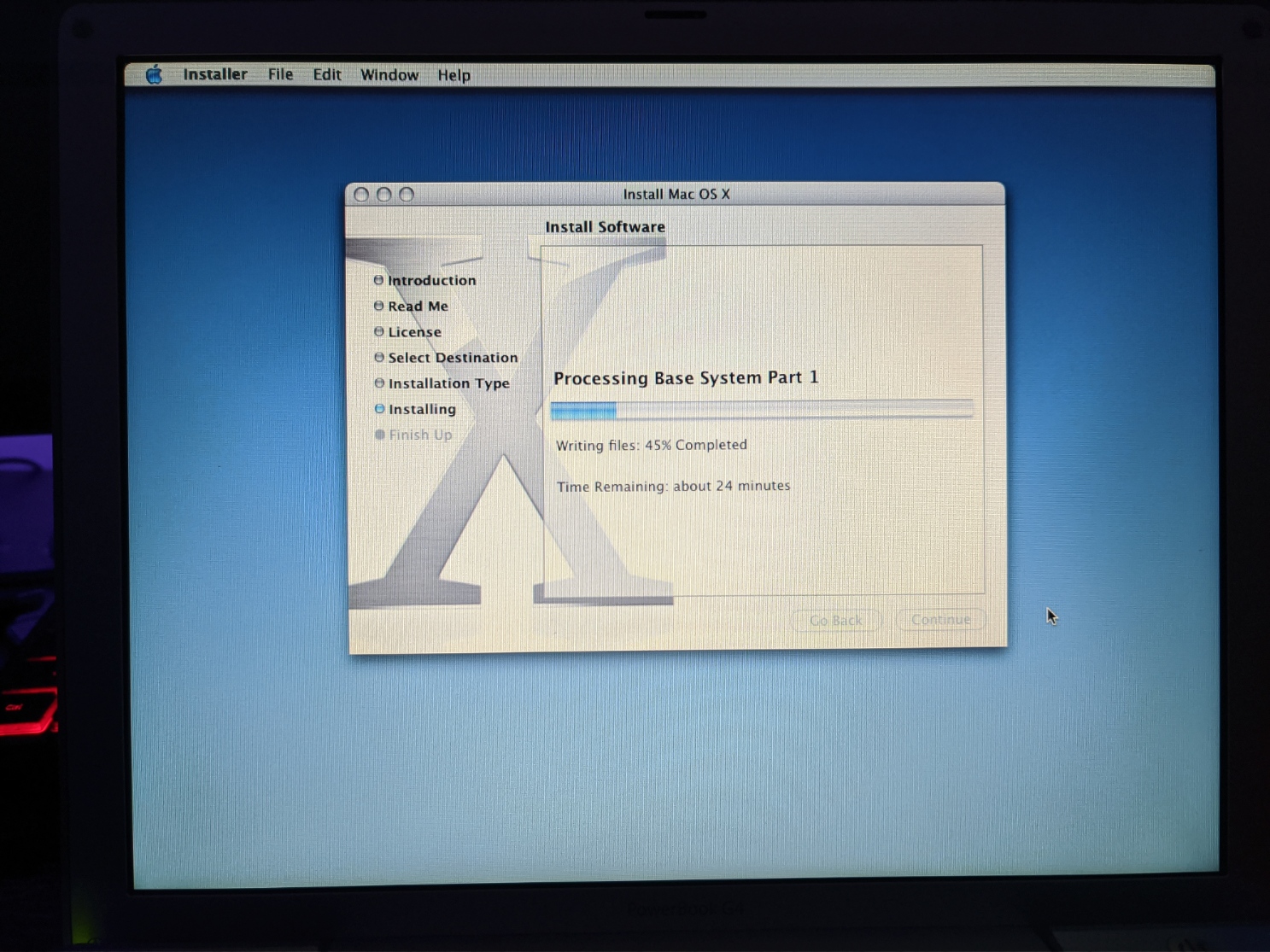

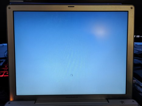

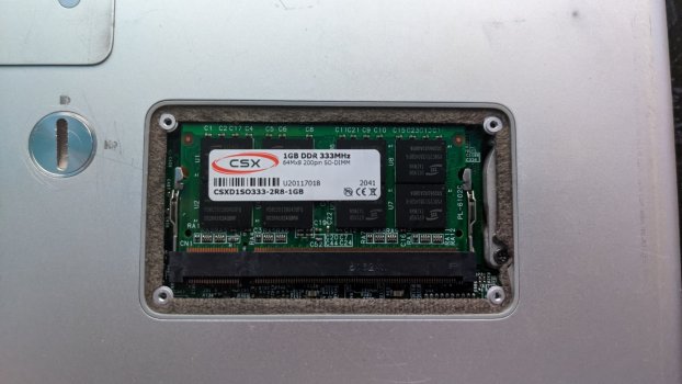

I tried to remove the module and clean it a little bit on both sides, the installation was longer but it gets stuck on Processing Base System Part 1 at 45% and after 4 min blue screen and beach ball loading. Any suggestions?

  • Do you get no chime?
  • Does AHT still report an error?
    • If yes, do you have another module to swap in and test with?
If all of the above still doesn't work, try running the installer with no module installed.

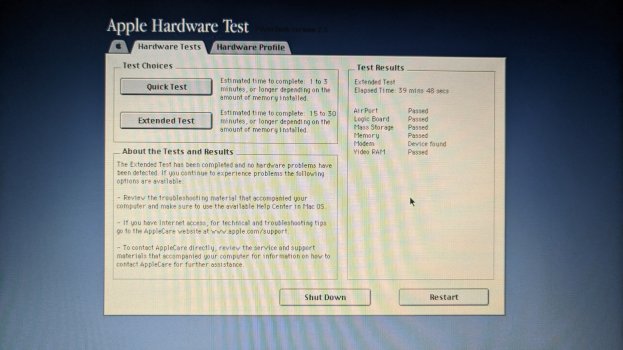

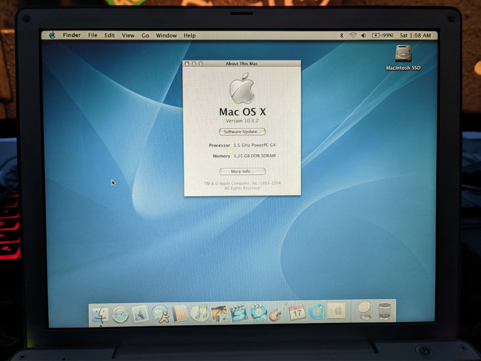

There is a chime every time I turn it on, don't have another module, but I tried to install it without the module, and was installed without issues, so after full installation, I tried to turn it off insert the 1GB module, and turn on, everything works properly and I can see the module via about.
Now if I try to reinstall the module, the installation will be smooth?

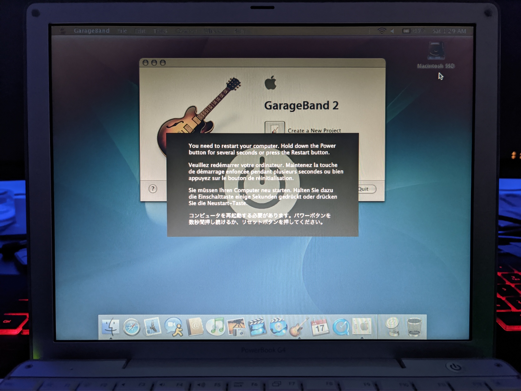

I think there is something with the module, i remember that last week was fallen on the floor by mistake, and is an issue when i open Garage Band, it crashes, without the module, the app opens normally.
So it can be because the module fell on the floor? I hope is not the slot an issue.

Without another module to test with, I can't say definitively whether or not it's the slot or the module. Though, this new information does sway me in the direction of it being the module.
