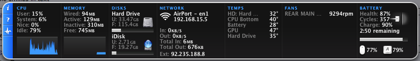

I installed a new HD in my powerbook 12" G4 yesterday, put 10.4 on it and now the fans are on non-stop. It seems the same issue as described here.
Let me make it clear, this is in no way a heat issue. As soon as you touch the power button until you switch it off the fans are on full pelt. Even when you start the laptop from cold.
Its heartbreaking, if anyone can clarify that this is a logic board issue I would be grateful.
