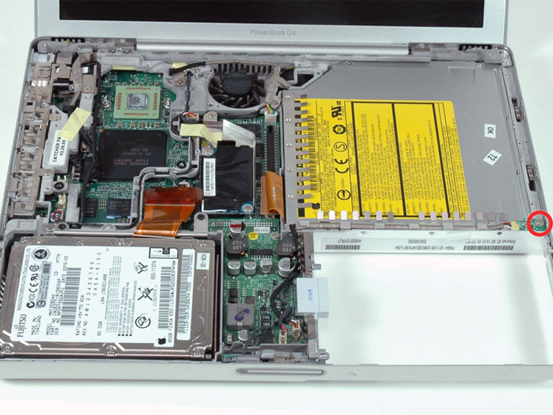

I've repaired a few 12", when you remove the upper case(keyboard) the HSF is in the upper middle...

Hmm, I see. I thought the sticker was facing downwards. That makes more sense. I replied to the post at 12AM so I wasn't super coherent.
