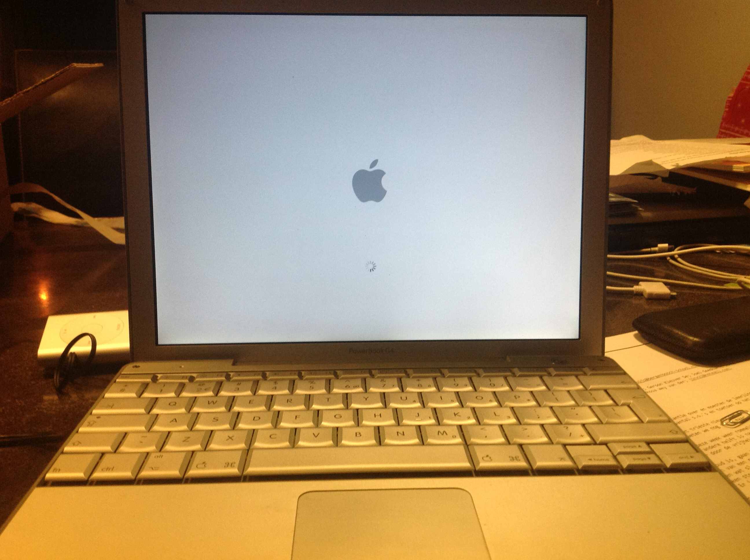

I just bought this powerbook from the internet for a nice price.

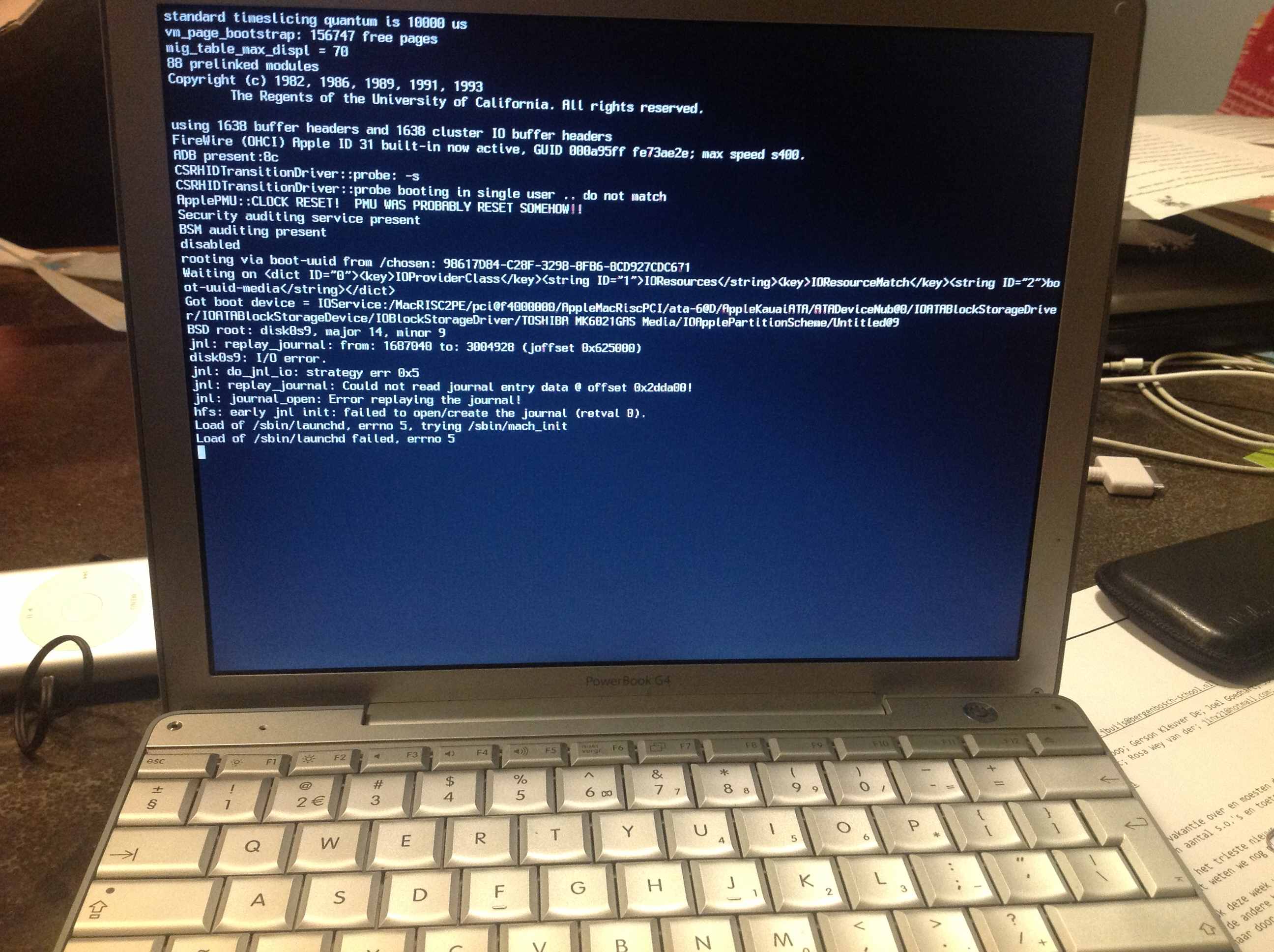

The system is damaged so i need to re-install it... This is the first problem Something is blocking my way in the disk drive slot it doesn't feel like a CD.. But i can live without a CD drive. So i wanted to install Mac Os X 10.4 from USB, I need to boot from an USB drive with OpenFirmware.
But by pressing: Alt + Apple + O + F before i press the power button (And holding it after) i will still hear the Boot sound and the system is starting to boot (But keeps spinning for ever. HDD I/O Error while loading /sbin/launchd error 5)
How am i gonna fix this? Since the system shows the spinner there isn't real hardware damage
I wont go to a apple store. I would need to ride 100KM and it will cost me more then i paid for it
I would like to fix it without opening the powerbook, i will likely damage it.

The thing blocking your drive is a screw. Somebody failed to use the correct screw (it's too long) while trying to reassemble the Powerbook. I'm guessing they took it apart to attempt to fix the same issue you're encountering. You'll need to disassemble the Powerbook in order to fix this issue.
I'm going to guess that either your hard drive is dead or the cable connecting the hard drive to the logic board is damaged.

First reset PRAM. This should allow you to enter OF later. Try single user mode and run fsck. Filesystem on HDD seems to be damaged. If HDD isn't physically damaged, fsck should help.
Optical drive is another thing. You can't fix it without removing. That same happened to my PB's and Mini's ODD recently.
I will try this now
EDIT: The Apple + Alt + P + R Didn't work, trough holding power on boot did something... But i don't know what..

Does it react on keys pressing at all? Built in keyboard or external. Can you boot it in single user mode then run fsck?

It also can't boot to single user mode. (The screenshot i took was with single mode)

It looks like more serious problem than HDD and ODD.
If any startup keys combo doesn't work on any keyboard, you won't be able to boot PB from PM's ODD in TDM. You'd need an "alt" key to do that. I presume that you've tried both USB ports with external keyboard.
