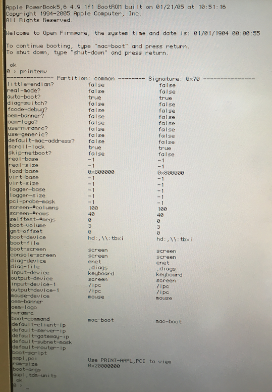

If auto-boot? is set to false then it would cause Open Firmware to always open. Check the result of printenv. But I think reset-nvram should change that?
Can you measure the voltage of the PRAM battery?
This is what I get. auto-boot? = true, system date and time = 01/01/1904 ..
I can measure the PRAM battery, but only if I tear it apart.
EDIT. Just did it. Measures 3,67 Volts.
