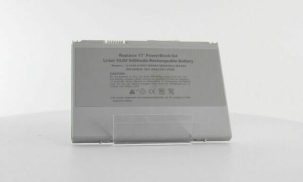

I just bought a new third party battery for my 2010 MacBook Pro 17" from eBay and the seller has more for sale: https://www.ebay.com/itm/274773970844
I got it yesterday, put it in my MBP 17 this morning, and charged it. Once it got to around 98% or so, I unplugged the AC charger and ran off the battery for a while. So far it is working well.

I think that that battery could also work since it's also 58wh
