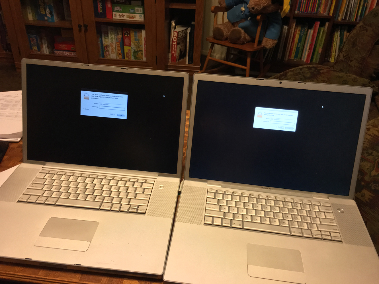

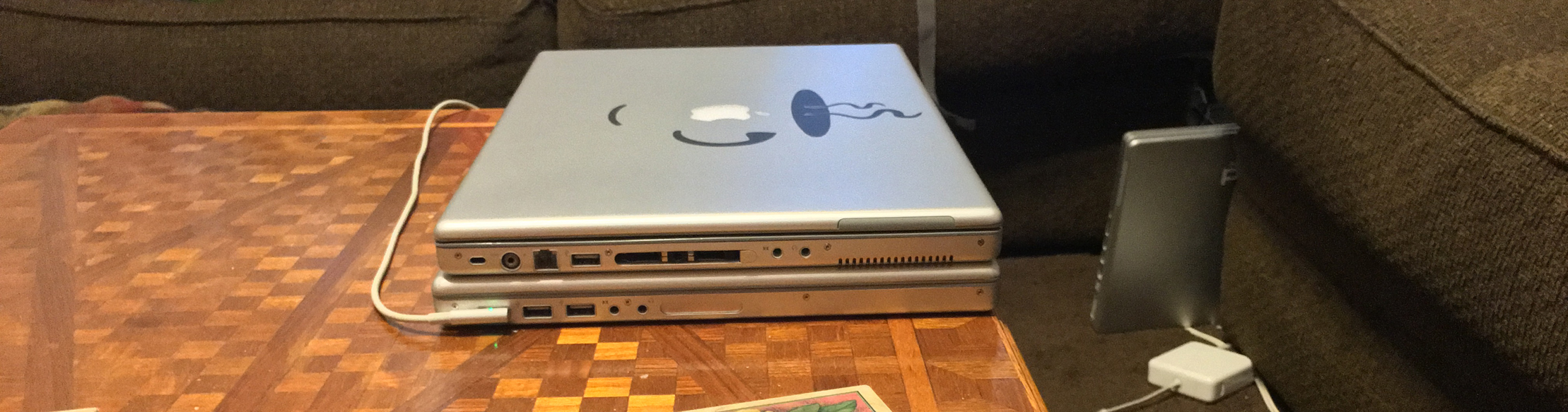

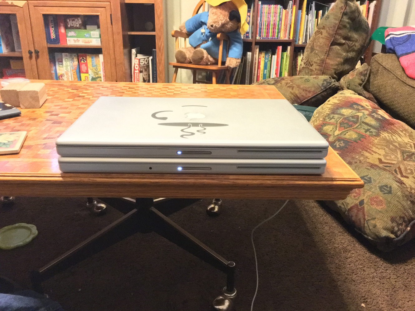

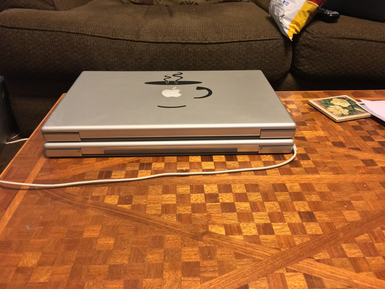

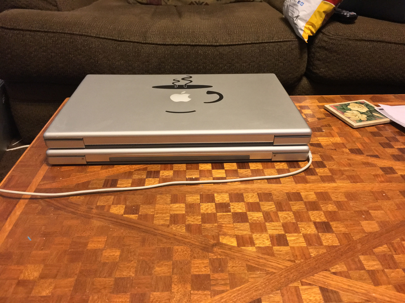

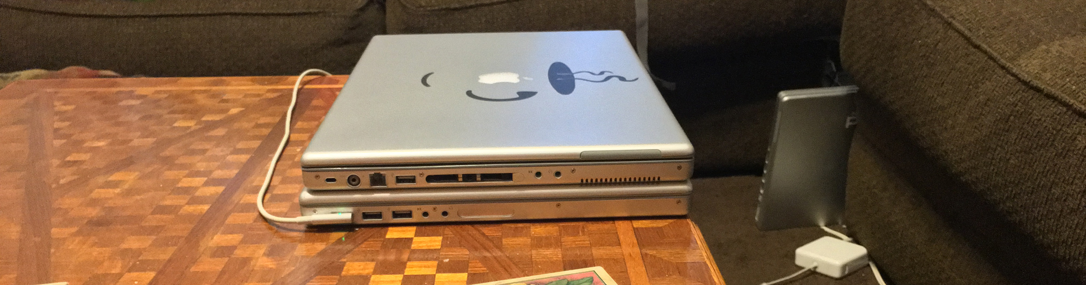

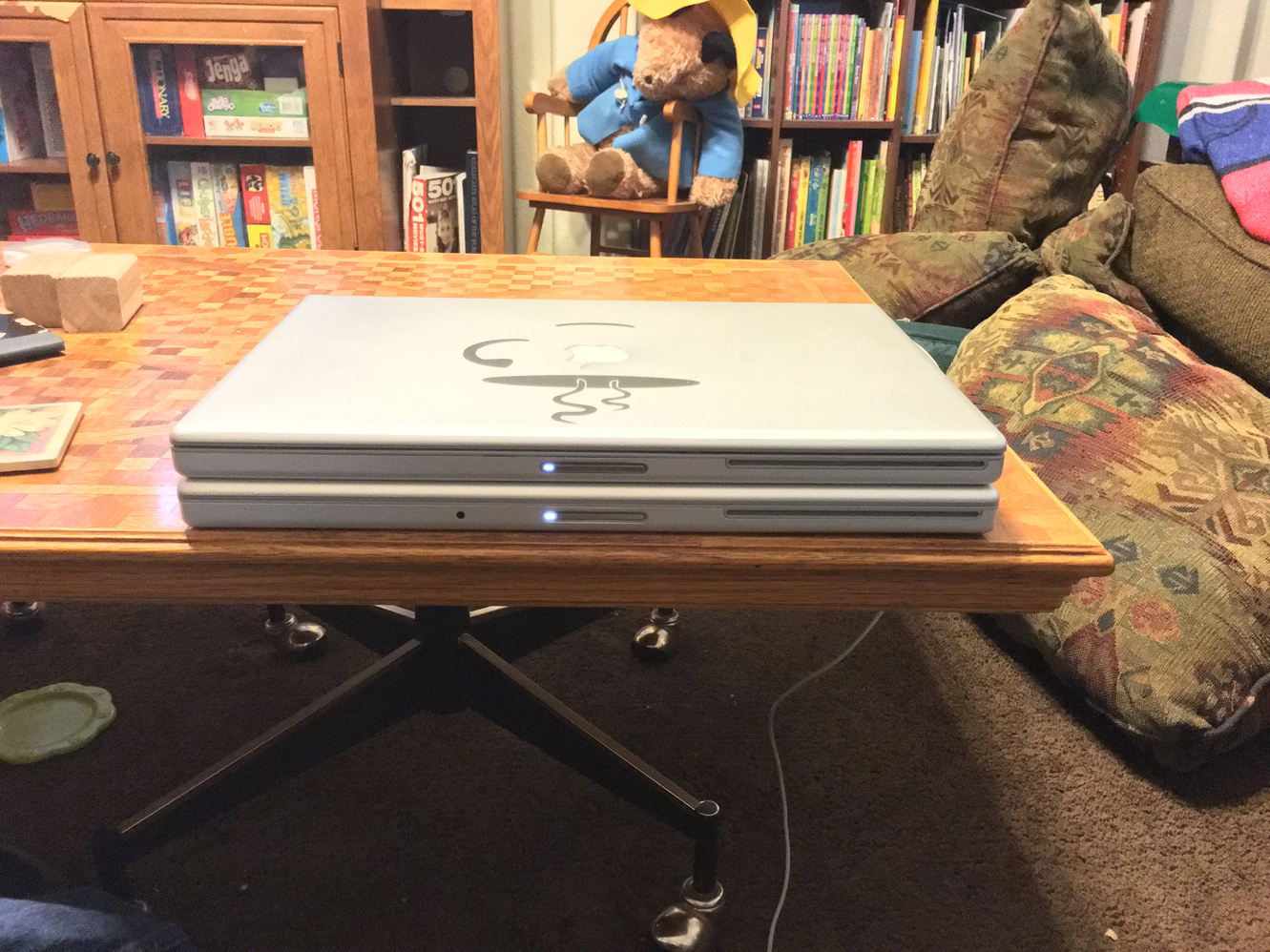

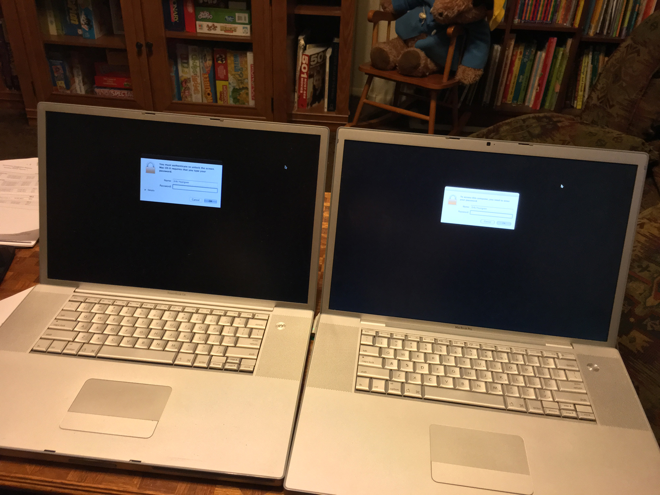

I have the A1013 and a 2006 17" MBP. Physically there's a slight difference as well as the top of the bezel being larger to accomodate the iSight.
But I don't know if the LCD connector is the same or not.
Reactions: 1042686
View attachment 716769 View attachment 716770 View attachment 716771 View attachment 716772
Thanks for that, that is very useful, it looks as I thought, the lid size is different between the two models but the actual panel is the same height, I've seen a 17" MacBook Pro going for parts that I might take a chance on. Worst comes to the worst that way I can just resell it if it doesn't fit. The connectors on the early MacBook pros look the same as the g4 ones, it changed when they moved to an LED backlights which obviously wouldn't be compatible.
