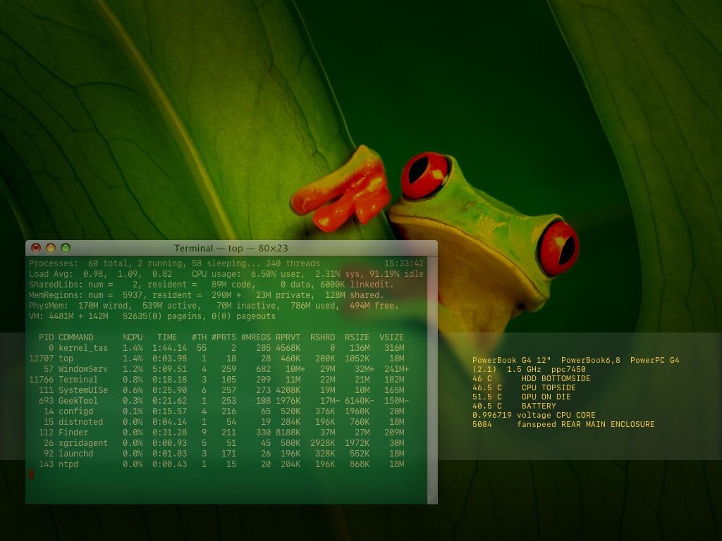

I just came across a shell script called TP for outputting temp and voltage data (using ioreg).
http://hints.macworld.com/article.php?story=20051021115356696
The script disappeared from the links in the article / post, but I found it on archive.org
Here it is anyway;

The script states that it doesn't work on newer PowerBooks, so I guess that must be the DLSD(?). But otherwise, this is the poor man's iStat Menu ;)
EDIT: I should have said; it states that it DOES work on the newer PowerBooks.
Also, the script works well with Geektool. Set the refresh time to 5 seconds or so and you've got a near zero CPU-usage temp / voltage monitor displaying on your desktop.
Minor edit for Leopard to show the correct Hardware details when running tp -l

system_profiler SPHardwareDataType | awk '/Model Name/ || /Model Identifier/ || /Processor Name/ || /Processor Speed/' | sed 's/[^:]*: //' | awk '{printf $0 "  " }'
You can then use tp -l to also show the hardware details above the probe readings. (See attached screenshot).
