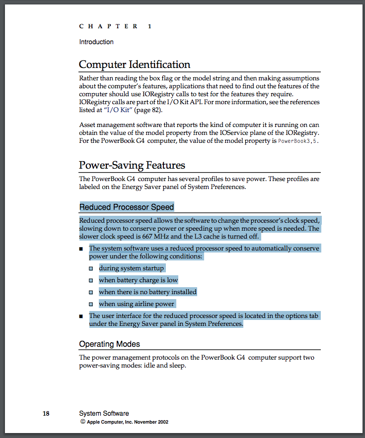

as i said if the Mac is starved for power (ie wrong charger and cant draw power from the battery) it will just throttle down to draw less power, just like when a Mac thermal throttles. and some macs even with the right charger, if you have a dead/no battery installed they will throttle down regardless, my 2006 BlackBook is an example It just sits at 1Ghz since i dont have a battery for it, even when using an 85W charger LOL
Apple is very good about power management they wont let anything get damaged in the ways you describe.

How do you know what the throttle down to speed is? Where do you check? Or is it just a calculation you can do in your head?
Page 25 of Apples Developer notes for the 17 inch DLSD
(the dev notes for the Last TiBook actually mention the machine will throttle down to 667Mhz and disable L3 cache if you dont use the right charger/when no battery is installed)
