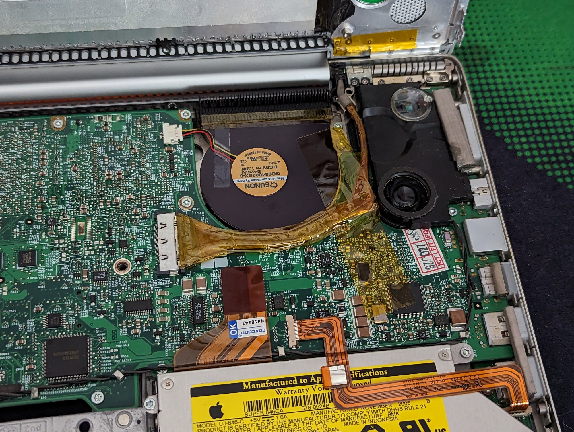

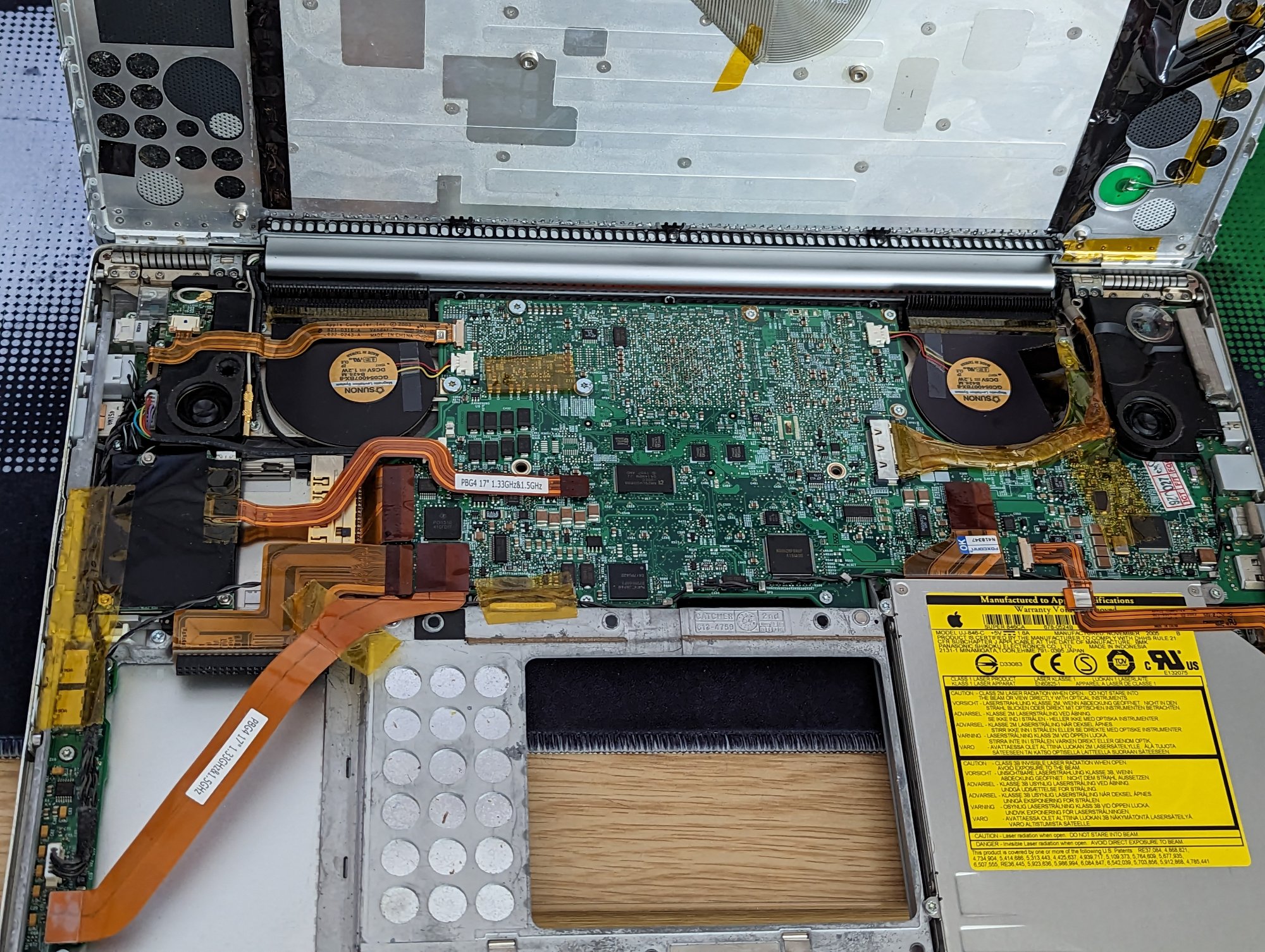

Hi everyone,
Got my Powerbook G4 out of storage last week and I'm unable to get it to boot. No chime, nothing.
I've tried it with one ram stick, taken battery out so just A/C, disconnected the HDD and reconnected.
Just a black screen, I press the power button and I can feintly hear the HDD spin and then stop. Tried resetting the PRAM, nothing happens.
Any advice on getting my Powerbook to boot would be fantastic. I feel like I've tried everything.
Thanks

A couple of possibilities:
1) You’re using the 65W power adapter, correct?
2) Instead of PRAM (which doesn’t have much of an impact on the PMU, or Power Management Unit), try these steps.
3) If the above steps are not successful, the next hunch I’d follow if figuring out whether the DC-in board is still working as it should or if it’s on the way out. Unfortunately, probably the easiest way to test this is to swap in another DC-in board.

Yeah, using the power adaptor that came with the Powerbook and the one I was using every day for years. Laptop turned on last time I checked.
Tried these steps and I still only get the sound of the HDD slightly spinning and then stopping. The A/C is green when connecting and goes orange when battery installed so it is charging the probably (at this point) dead battery.

That battery, if it worked before, probably still holds charge now.
Why not, as an experiment, let the charger run until the orange light returns to green (which might be an hour or two). Then, unplug and try another power-on.
I’m still thinking DC-in board here, but also there might also be a particular capacitor somewhere which is not spooling up enough juice to handle the power draw of the HDD motor spinning up, thus causing the system to simply shut off.

Fully charged and green light but same symptoms. Maybe you're right about that DC-in board. I have no replacement so I'll have to give up on this old girl unfortunately. Thanks for the help.

Don’t toss it! eBay it or donate it to someone nearby who takes care of old Macs. 🙂
p.s., Incidentally, I had the DC-in board fail outright on my 17-inch PowerBook three years ago, which left it dead for about three months before one turned up on eBay. The 15-inch PowerBook G4 I have has a problematic DC-in board which lets the adapter power it, but it won’t power the nearly-new battery or let a charged battery run from it. Unfortunately, DC-in board failure on these PowerBooks is a fairly common problem, and with time moving along, the parts are getting less easy and/or affordable to locate.

I originally got it out because I was feeling nostalgic and have been repairing and fixing up iPods and thought it would be cool to restore them on my Powerbook with Tiger installed. I also needed Firewire 400 for the first few generations of iPod.
Could always take a chance with a "dead"/"for parts only" PB on eBay and pull the board from it. I'm sure few of those are actually much checked out before being placed up for auction....

It’s where I’m inclined to guess (as opposed to the logic board). Were this an iMac G5 (from the same general time period), the culprit with the system not powering on (or staying on) would be the notorious liquid-filled capacitors which failed in these (note: many liquid-filled capacitors will work fine for a long time, but there was a quality control problem with said capacitors in the mid-aughts, and Apple weren’t the only manufacturer to deal with it).
The capacitors in the PowerBook, due to size, use solid, tantalum-based capacitors. Even so, the symptoms you’re having could either be that or, as @eyoungren hypothesized, the PRAM battery in yours is just completely dead and needs to be replaced (which is probably a good idea to do anyhow). I don’t think your logic board, which is what counts the most, is bad, but I do think something involving power delivery and/or power storage (like a capacitor or ancillary battery which functions as kind of a “super-capacitor”) is amiss.
If you ultimately try to pick up a replacement PRAM battery for it, this may be easier to find online (though don’t expect finding a new-old-stock one). In the longer run, pulling out that HDD and replacing it with an SSD might also be advised. This is because the PATA/IDE HDD has two sets of power rails — one, for the internal logic, and the other for supplying power to the moving parts; pulling a lot of power from especially the latter (not surprising, really) might be too much for the other power components to handle, especially if their power draw exceeds what the capacitors can hold “in the tank”, so to speak. An older HDD may, especially if one not used for a long time, have moving parts which are resisting movement relative to what they once allowed when still newl; resistance to movement requires more power to overcome that resistance, which here might be too big an ask for your PowerBook.
That’s my working hypothesis. You’ll need to set up a short shopping list to find out: replace the PRAM battery; replace HDD with an SSD (like an IDE-to-m.2-SATA adapter, plus SSD blade); and, if necessary, look out for a used, working DC-in board.

Just skimmed through the thread, so apologies if this has already been suggested; try removing the optical drive and disconnect the PRAM / USB Board, then power on. It should boot with this disconnected - and will determine if the PRAM board is indeed at fault.

I have replaced the HDD with an IDE to SD card adapter just to see if that was the issue but same symptoms persisted but without the HDD spinning noise (obviously).
I'll look at replacing the PRAM battery and a DC-in board. Thanks again!
Good shout, I'll try this out tonight. Would be good to know if the DC-in board was the culprit. Thank you.

Sorry for the delay.
With the pram/usb board disconnected it still does not boot. Same symptoms as before.
