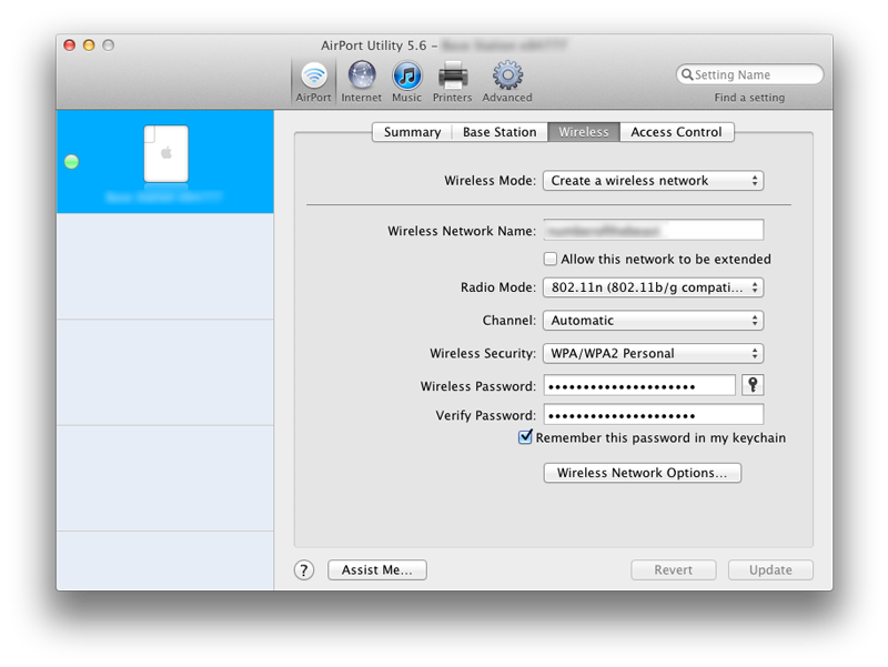

You need to use a browser to configure your MiFi device first. Try set encryption to WPA and it should work. I use a Clamshell iBook with original AP card (w/ 10.4.11) and it "does" WPA without problems (but not WPA2 OFC). I've set my AP Express to WPA/WPA2 Presonal. IDK your specific Verizon device but AP must be restarted after encryption method change.

Can you explain how to set the AP express to WPA? I just bought the Verizon MiFi, and my newer iBook connects, but my TiBook will not.
edit, I am running Leopard on both Macs.
^^^ My settings:
