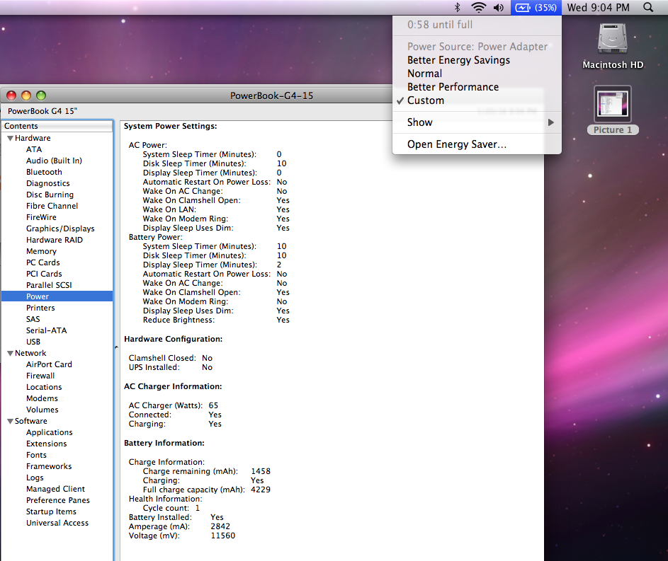

Well this is strange. Not sure if I did something wrong or not, but I might have somehow bricked this battery...
After taking it out of the package I made notice when pressing the button that two green dots appeared and showed a charge. I installed it in the laptop, plugged in the AC adapter and booted into OS X. The AC adapter shows orange, which I expected. Booting into OS X I was presented with this:
Removing the power cord shuts down the computer entirely. Very confused here. When it first turned on I detected the odor of...well..a battery and the battery was warm to the touch. Now I don't really feel much heat at all and no green dots when pressing the battery indicator.
It suddenly started charging. Not quite sure what was going on. It's been going for about an hour now, 32 minutes until full. I guess I'll go ahead with the conditioning process...

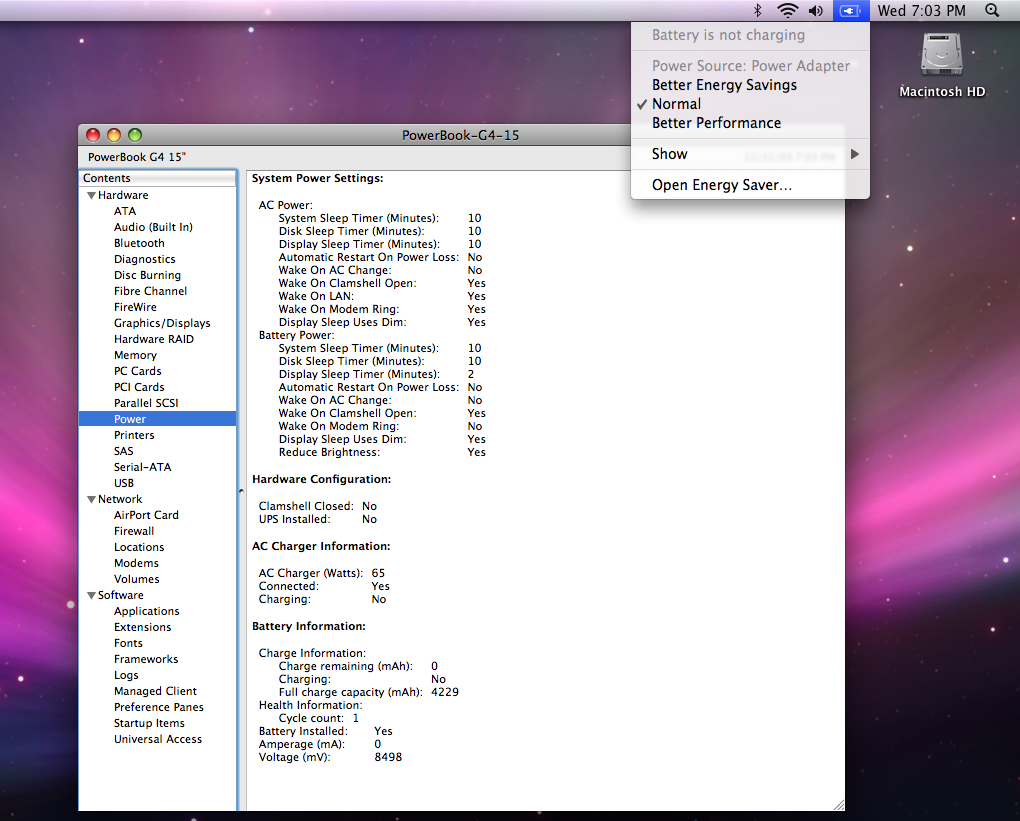

Update on this posting, unfortunately, I never did get the battery to work. I only had it fully charged maybe once or twice then it was completely dead, wouldn't charge. I initiated a return with the ebay seller.
Sad, I was hoping to get the old PB running on her own again. I fear buying another battery, perhaps something is either wrong with the PB or charger itself. I have no way to test as I don't know anyone else currently with a PowerBook.
The first screenshot showed a voltage of 8.5 volts which was way too low. These batteries should never get under 9v (3v/cell) as such a low voltage kills a li-ion battery pack.
From the voltage readings, it was probably just a bum battery. Especially with the cheap ones, it's a bit of a crapshoot. Get your money back via eBay and give it another go. Having a PowerBook off its leash is worth the wait!
