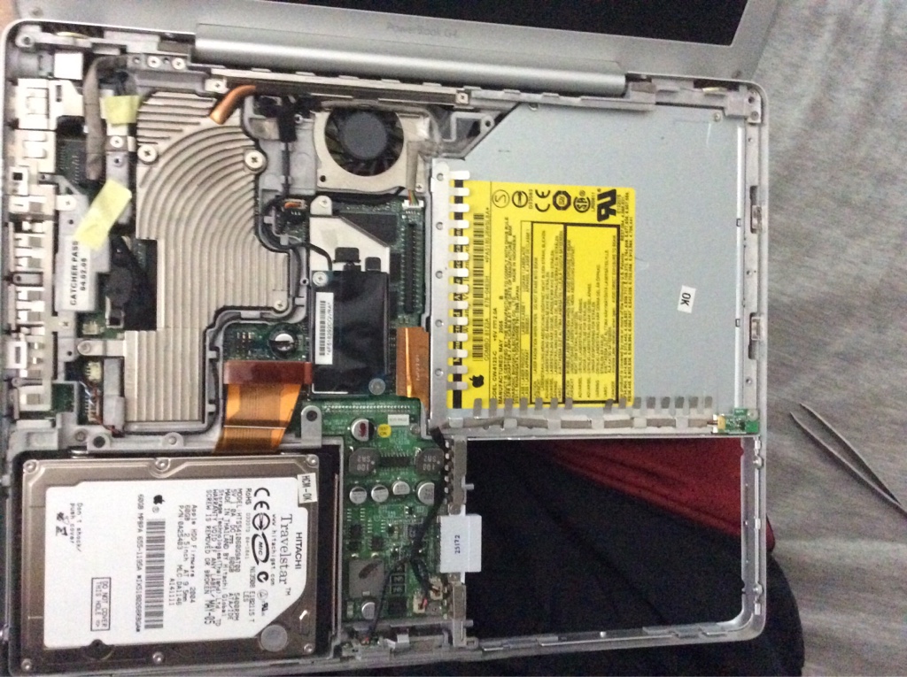

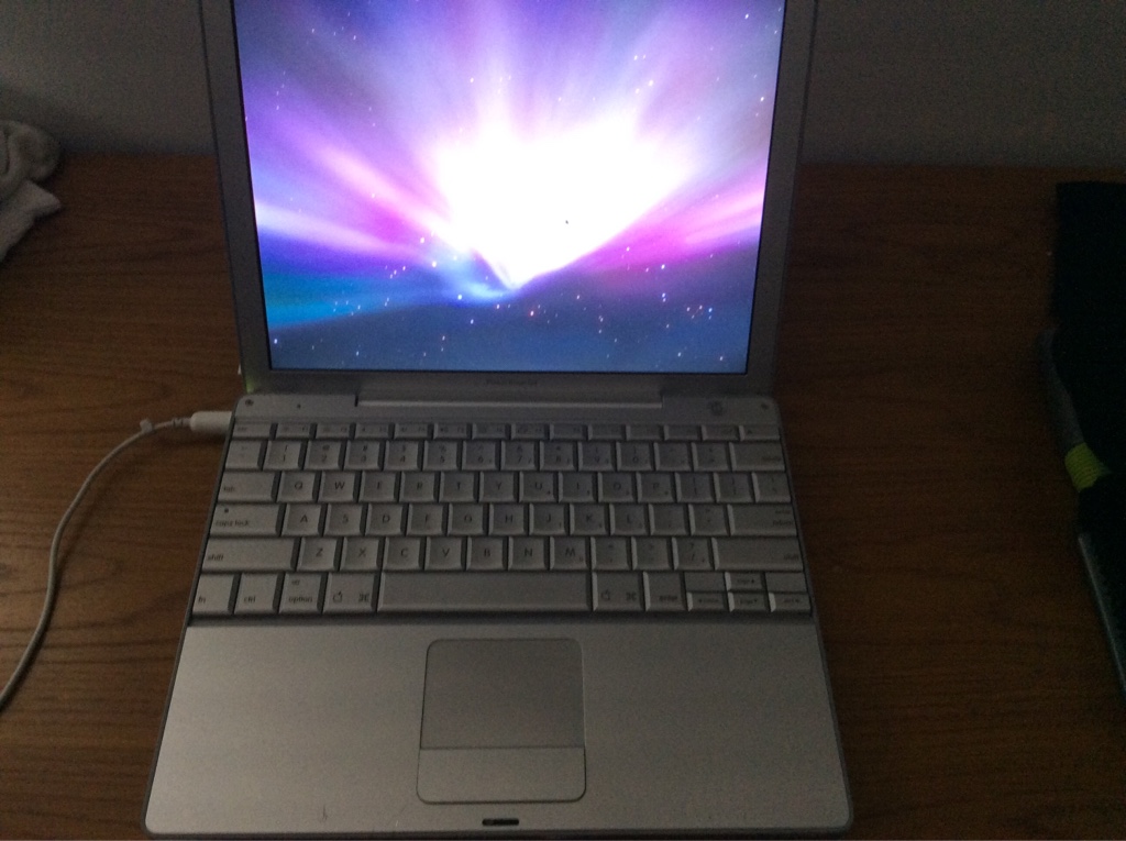

I have no clue. I opened it, unplugged the mic, power button, keyboard/mouse, HDD, and Optical. I then re-plugged them in, sealed up the computer, and just for the hell of it I turned it on expecting no change, sure enough I saw the spinning wheel. Beyond that, there was a lot of quiet screaming! I can't tell any of you how bewildered and excited I am right now. I'm just so happy that it started working.

Glad you got it sorted. Stripping out a 12" is not fun. Enjoy!
Taking off the lid was extremely hard with taking out the power button and mic plugs... I can't imagine taking the whole thing apart. Although it's easier than an iBook. @eyoungren can tell you all about how fun iBooks are to take apart 😉

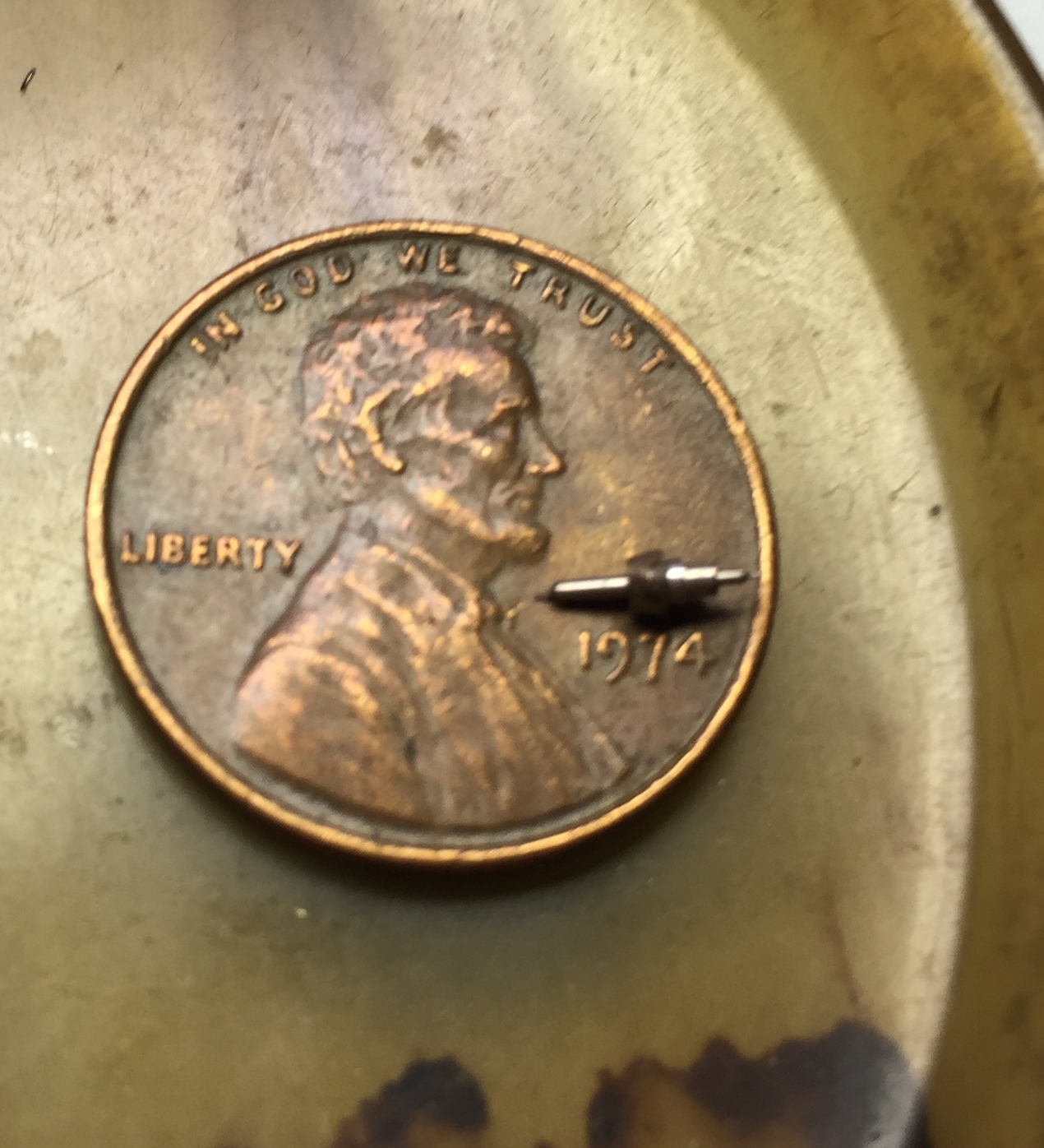

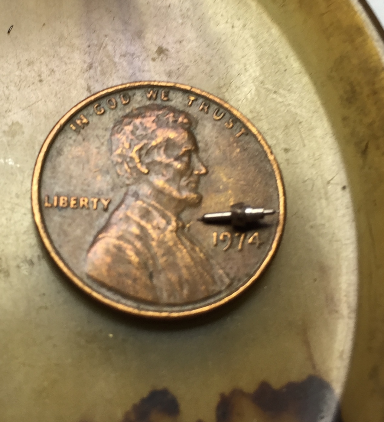

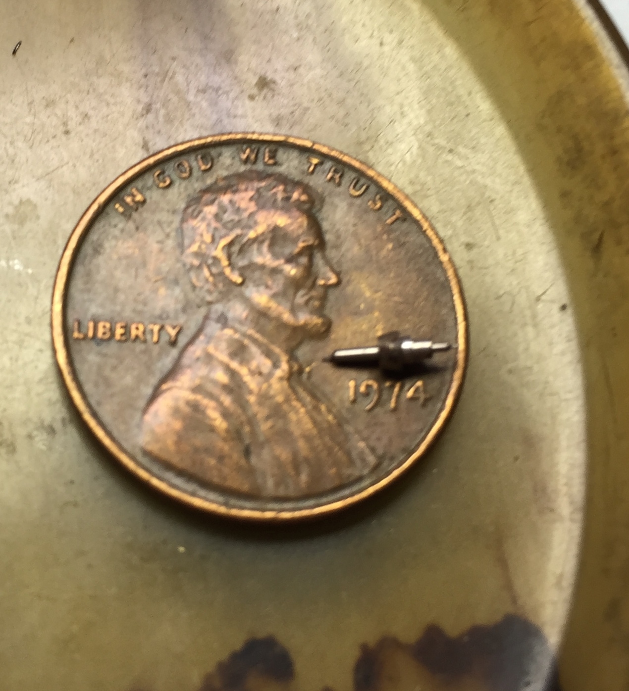

(If I have time this evening, I'm going to replace the balance staff on my New South Wales Gov't Railways watch-a balance staff is about the length of the date on a penny).
Don't ever take up watchmaking 🙂
Oh no. I know my limits and the 12" PowerBook is as small as I will go. I won't touch my iPhones. I've completely ruined other small stuff in my past so no way. 😀
