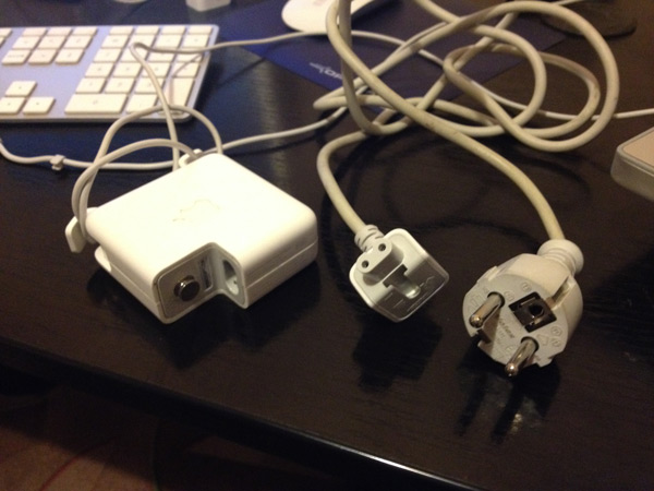

Same here on my PowerBook, and on all aluminum Macs I had/have, including my G5 when connected to a socket without grounding.
To get rid of the electrical charge I use an extension cord with grounding, see the attached photo.

Use the extension lead
I am also in the UK and they all do that. If you use the small extension cable with the plug on the end rather than just the small plug for the adaptor then that also has the earth connected and the issue wont be present.
