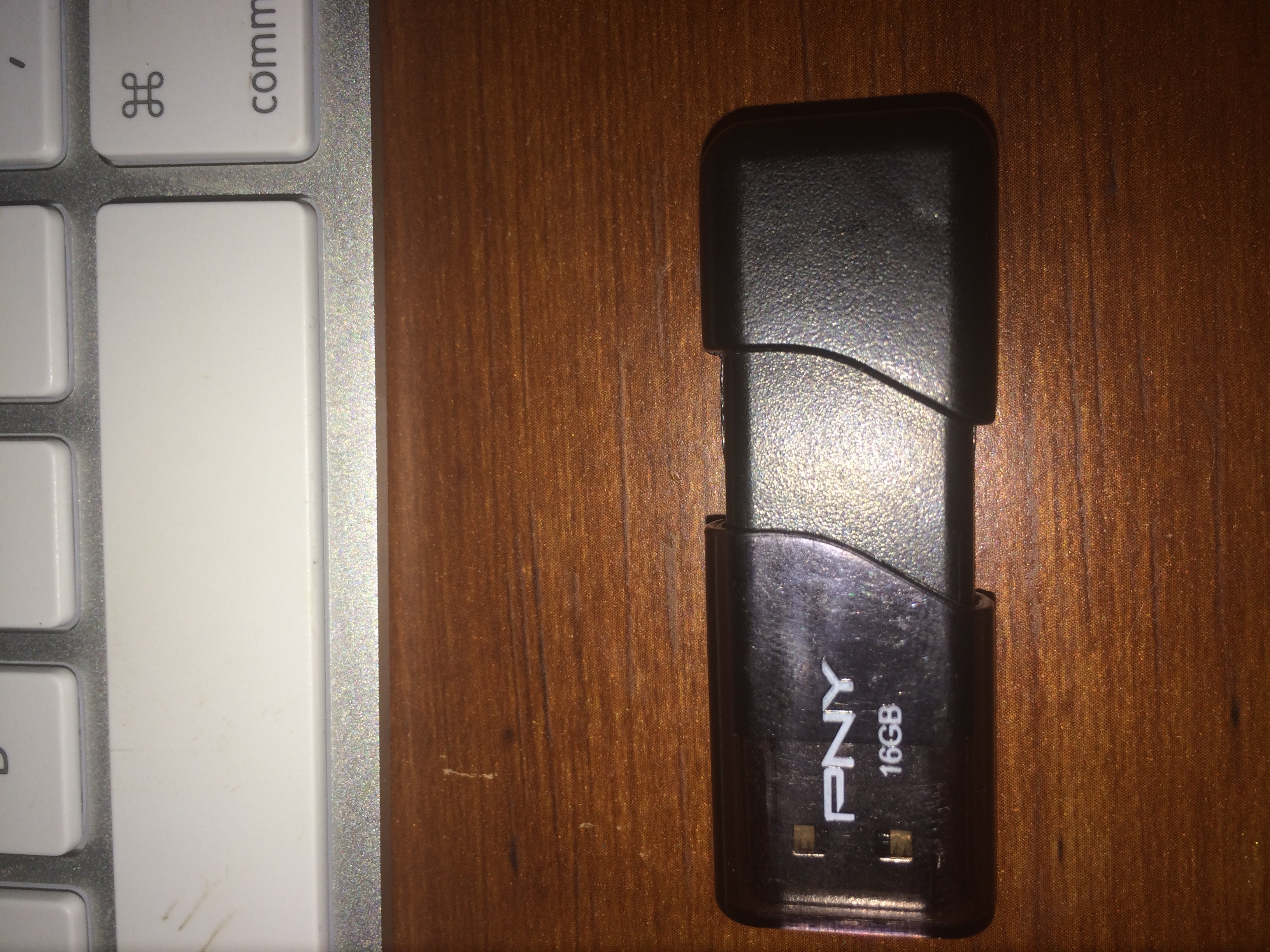

I have good luck booting G4 and G5 systems on PNY black USB drives. Mostly I use 8 GB models, but my 16 GB is partitioned to boot either Tiger or Leopard installers. I picked mine up at Big Lots for $12 a while back.
