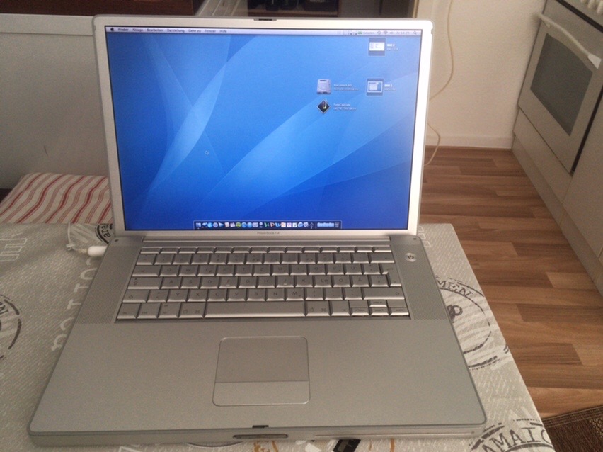

Hello! I am fortunate enough to hold a PowerBook in my hands!
The condition is surprisingly good for old age. Some Scratches on the Case an one on the Screen, but anyways: its an 15" G4 DLSD /HR-AI :-D :-D.

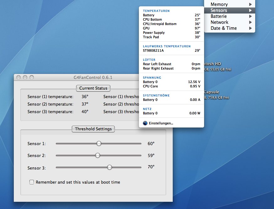

What makes me wonder are the differences in temperature for the GPU? istats varies between 88 ° C and 98 ° C. g4fan but indicates "normal" temperatures? Only a short moment when starting the program, it shows absurd data like 225 ° C .. The fans are running normally. The thermal paste I wanted to renew anyway ... Could this possibly be due to defective sensors?

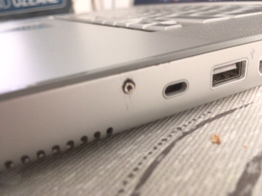

The PRAM battery has been renewed by the previous owner. See defective, broken screw! :-(

I would interpret those readings as is. It’s not uncommon for a GPU to run up around 85-90C if thermal paste is not properly applied.
The GPU takes quite a lot of thermal paste on this model. Maybe the paste wasn’t adequately applied on the last repair or wasn’t renewed at all. The CPU temps reported are very good.
When you pull the logic board out you’ll see both the CPU and GPU cool plates on the heatsink covered with the old paste. Clean them both up with Isopropyl Alcohol and apply new thermal paste. I would recommmend a German product called Grizzly Kryonaut. It’s a little pricey, but does a great job and is non-conductive.
The GPU takes a big X of paste, while the CPU will only need a drop about the size of a grain of rice, then spread across the CPU die / heat spreader.
Try to avoid running it until you’ve done this. The DLSD 15” is a great PowerPC portable and it would be a shame to see it overheat and fail

Thx for your commend. I now have replaced the thermal paste and upgraded to an larger harddrive.
My thoughts where to install Tiger and Leopard on two partitions. After fresch installs and updates, nothing changed on the GPU temperature seen in iStats 3.19. i do PRAM Reset. SMC Reset and also the command in Open Firmware. Nothing changed. The Powerbook runs fine, without any issus, but the high GPU shown in iStats. Maybee its a wrong sensor, or the istats install failed to install correct sensor drivers... it stops with an Error.
After 4h on power and after all playing 2 Movies (DVDs) it runs fine...
So, i will conclude, its maybee an fault of istats or an SensorError!?

It sounds like it could be a sensor issue then. If you've renewed the paste and the machine doesn't feel like it's running hot then it should be okay. You can also try running Apple Service Diagnostics (ASD) version 2.6.3 to run tests on the hardware to confirm. Search on these forums for the download links to the ISO and username/password combo to download.

Thx again, powerbook is downloading ISO an i will test it out. The Powerbook is "normal hot" .... as i remember on to my old 17" inch DLSD ;-)
So, if it luckely is just an faulty Sensor, i can live with this problem. But we will see.
