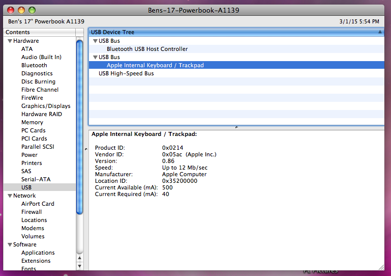

FWIW, here's a screenshot from my A1139.
I have a few A1138 top cases(only) that I'd need to dig out(and probably can't get to this evening) but I'm pretty sure that the ribbon cable that connects them to the logic board is only 4 wires.

FYI my DLSD/HR 15" keyboard is USB based. I think only with the late 2005 models Apple shifted to USB based keyboards & trackpads.
