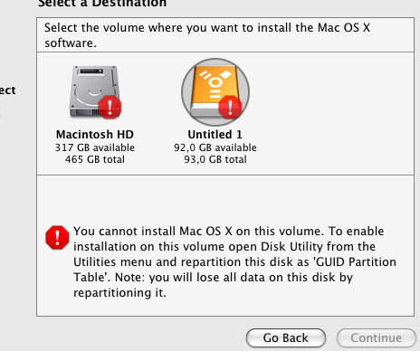

NO PROBLEM, I connect via firewire the powerbook to a macpro. I open the cd 1 of tiger (in the macpro) go to the installation file, and start the installation via firewire. It tells me that I have to partion the disk in Mac os extended with an option "GUI" (something like that).
[note: i have noticed that the GUI mode is for an intel based mac, but mine is ppc...but if I select any other option the system doesn't allow me to continue with the installation of OSX]

I post the picture of the screen

I've seen I should partion it as "apple partiton map" since is a ppc
But is not working, it asks for GUI
But with GUI is not starting.

Insert the Leopard-DVD in the PowerBook, boot it while holding the "C"-key, wipe the hard drive via Utils->Disk Utility in the top-menu, choosing your hard drive and click "Delete". Do a clean install then, even if it's an update DVD, you don't have to install Tiger first.
Tiger is either one DVD or four CDs, btw. I guess you have something weird like Restore-DVDs (The gray ones) from an Intel-Mac or something - which don't work on PPC:
Unable to find driver for this platform: PowerBook5,9
And for the GPT vs. APM: On an Intel-Mac, you can only install to GPT formatted disks, while on PPC you can only install on APM formatted disks. Either you get another PPC machine and install via Target Disk Mode from it, or you have to boot a DVD on the PowerBook.
